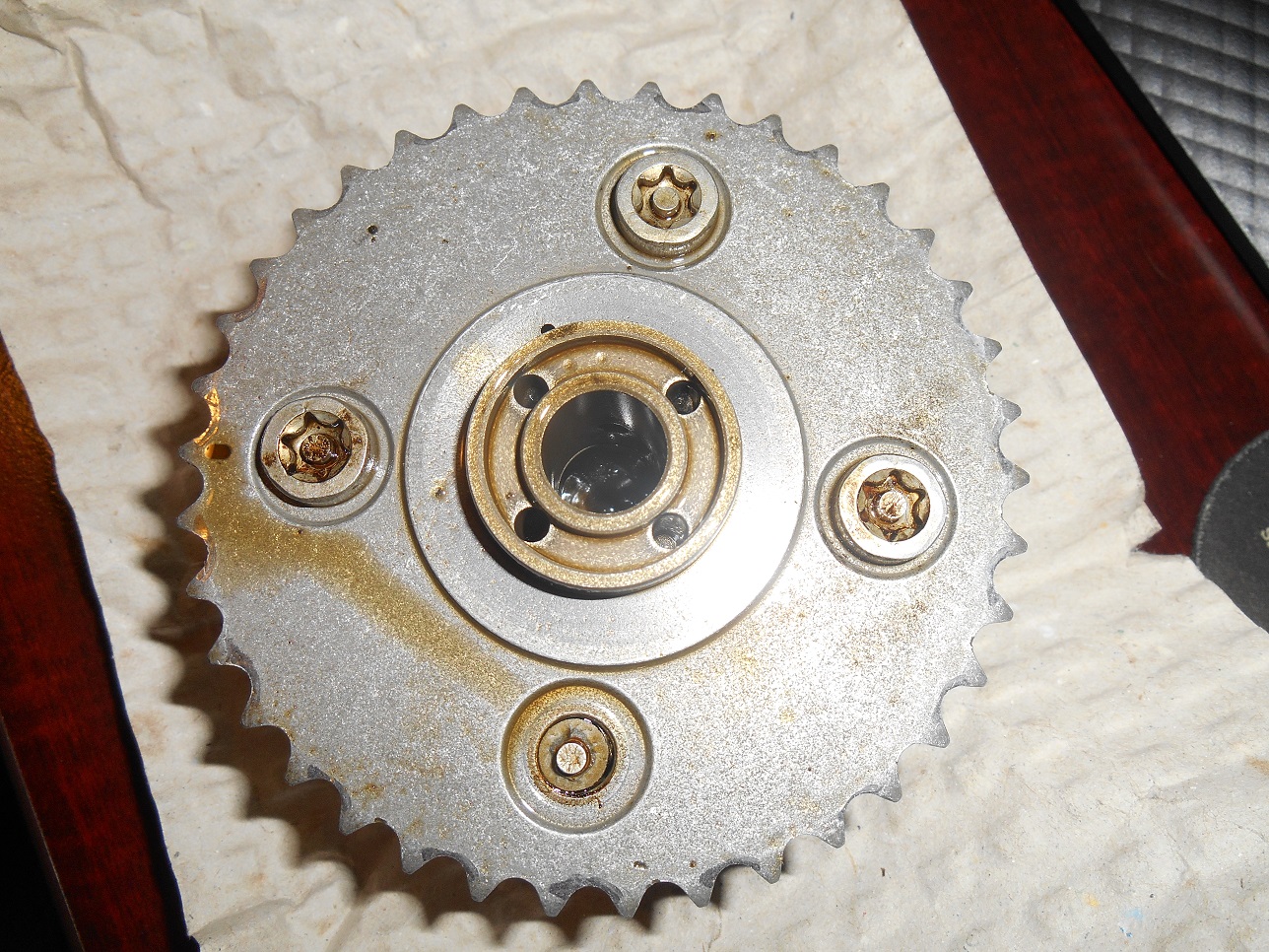

Look familiar? http://www.1addicts.com/forums/showt...=863669&page=3
"Just got my 135 back today after having sheared off bolts on both Vanos units. MY car is a 04/2010 production date. I am 4,000 Kms out of warranty so I got the pleasure of paying for the repair. I will be giving BMW a call to discuss some goodwill as this is obviously a defect and I was unlucky enough to have it last through the warranty period just barely. Expensive and annoying to have to deal with.
Attached Images"
Name:	BMW VANOS failure.JPG

Interesting production date eh? Right about the beginning of problems on the 958 V8's..
Also interesting is how the head sheered off - you can see very little metal was actually holding the bolt head on the shaft. Not a great design in steel, an awful design in aluminum. The new adjusters use allen-head steel bolts - probably just like the earlier V8 engines did.
