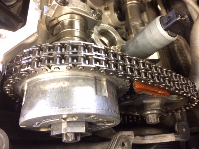

My local dealer (NorCal) gave me the below quote:
$3,585 total for the entire job (part/labor/etc).
"The parts needed are the same as listed in the WC22 service action plus two additional solenoids ($256.06 X 2). We have found that the solenoids can be problematic. We replace them because they are mounted next to the cam actuators."
Parts total - $2078.32
Tax - $176.66
Labor - $1,330
Old Mar 14, 2017 | 11:57 AM
Tax - $176.66
Labor - $1,330
Do you have a part number on the solenoids? Is this an upsell or have other confirmed having issues with these solenoids?

I don't have a part number but I do have a picture (provided by the dealer). They very well could be upselling.
Old Mar 14, 2017 | 03:37 PM
  #371
deilenberger's Avatar
Joined: Mar 2011
Posts: 1,493
From: Spring Lake, NJ, US of A
Rep Power: 126
deilenberger Is a GOD !deilenberger Is a GOD !deilenberger Is a GOD !deilenberger Is a GOD !deilenberger Is a GOD !deilenberger Is a GOD !deilenberger Is a GOD !deilenberger Is a GOD !deilenberger Is a GOD !deilenberger Is a GOD !deilenberger Is a GOD !
So far I haven't heard of anyone having a problem with the solenoids. Zilch. Sounds like an upsell to me. BTW - there may be an input screen on the solenoid that can be cleaned.. I seem to recall hearing something about this. It should only need cleaning if the oil has been neglected.
