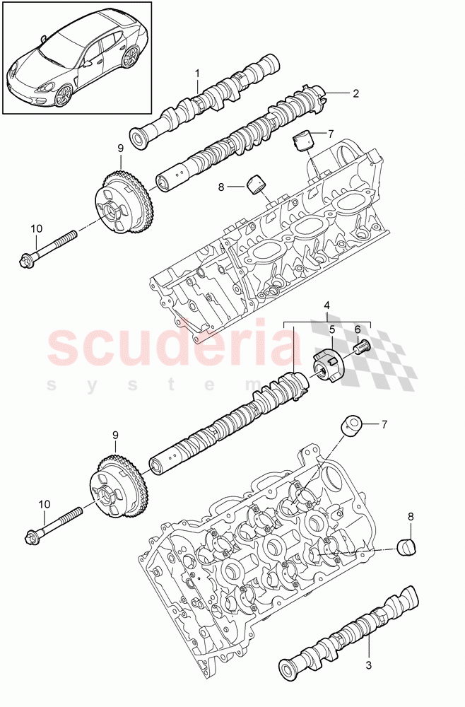

In the WC-22 there are four 948.105.254.00 Hexagon round-head bolt, M12 x 1.5 x 110 required.
Are these the bolts under discussion? They are also used in the Panamera (#10 in the picture).

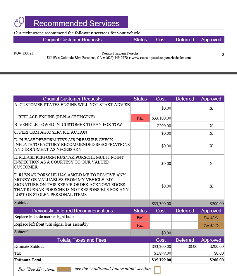

I recently took my personal 2011 Cayenne Turbo into an indy shop for what I wanted to ID as a loss of boost issue, after 2 visits and many replacement parts that was getting close to the 2K marker I finally DROVE IT IN as I had on the previous 2 occasions. This time I didn't bug then over needing my vehicle since I just wanted them to find the problem and not have to return.
Well I finally call and start asking questions 3-weeks after my car has not been returned or no calls, I finally get a hold of the owner who says that he had the car running and it was running great, during the test drive (only 5-miles were documented since it was left there 3-weeks prior) the engine blew. I was told that it was the infamous CAMSHAFT ADJUSTER SCREWS that broke, well I was then told that it was best if I could get it over to PORSCHE so possibly they would make the repairs under good faith since it just went out of warranty within the year.
Well after a few days and a few calls I get a $3,000 credit towards the repairs authorized from PORSCHE.
I have a 135K paper weight that I can't do anything with until I foot the bill of $35,199 (the estimation for the repairs to be made).
1. I wasn't the driver when the engine blew, the indy shop was "test driving it when it blew".
2. This is a well documented issue with PORSCHE and they have even started a "campaign" an other smooth word for "recall" due to this issue.
http://europe.autonews.com/article/2...a-on-camshaft-
I will keep you all posted on what comes of this ordeal, I just wanted to reach out and ask anyone here first off (LEGAL ADVISE WOULD BE GREATLY APPRECIATED) as to: A. is the indy shop responsible for any of this? B. Is PORSCHE responsible, of a know defect in these aluminum bolt failures?
Last has anyone pursued any claims against PORSCHE for this same issue OUT OF WARRANTY covered, I know many of you have had replacements under warranty but mine is out so if you have an out of warranty feedback that would be best.
BY THE WAY, I'M NOT WAITING FOR PORSCHE TO MAKE A MOVE, I'VE ALREADY PURCHASED A REPLACEMENT ENGINE THAT I INTEND ON GETTING INSTALLED VERY SOON. (GOOD IS THAT IS HAS ONLY 27K) (BAD IS THAT EVERYTHING IS OUT OF POCKET TILL I CAN'T GET THIS ISSUE RESOLVED)
I have submitted my report to the NHTSA/DOT just now
