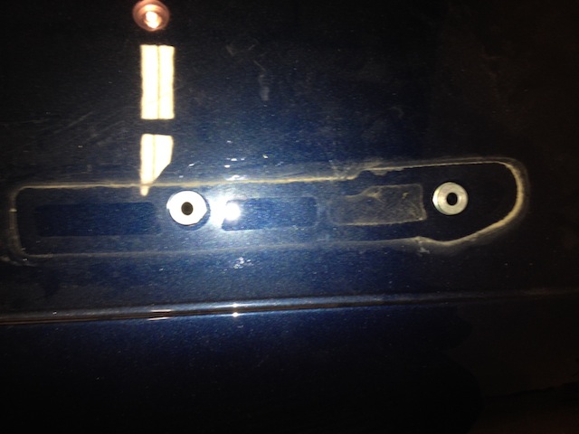

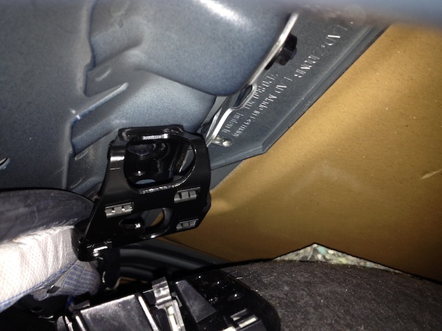

As promised in other threads, my rails have come off for the car to be repainted so here are some pics. Unfortunately since the entire roof liner didn't come down the interior pics aren't great. What the pics show are:
  1. The rear driver side exterior mount location. The silver "discs" are actually raised a bit from the sheet metal. I expect these are part of the interior piece.
  2. The underside of the driver's side front mount. The silver plate is the mounting plate. I expect this is missing on non-rail cars. There is a part number, but I can't see the whole thing. It appears that this piece is roughly the same length of the foot pad on the rail itself.
  3. The underside of the driver's side rear mount. Sorry for the bad view, but in the middle of the pic is the rearward most mounting hole. Contrary to the front plate, this one appears to be about twice as long as the rail's foot.
What I don't see is any indication of special structural changes, though things might look different with the entire headliner out of the way.
Before this thing gets put back together, is there any additional information/pictures I should try to get that you think might further this cause.
Now someone without rails needs to pull their roof liner down and get some pics so we can compare.
All in all, however, I think a retrofit can be done safely if someone was so inclined.

In my case, I would like to remove the rails, since I don't use them on my 2012 Cayenne Turbo and I like the cleaner look.
It seems, that it would be possible to remove the rails, reduce the silver discs and do a new paint job on the roof, right?

So called "silver disks" is rivetted nuts, so you need to drill them off, and weld holes in roof. Only then a paint job.

Is the rail screwed from the inside and is it possible to remove the inside mounting plate? Or is it welded to the roof?

no, they are not welded
