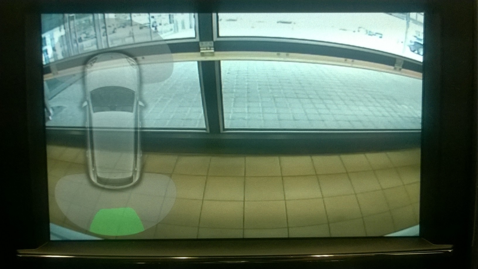

BTW picture from 70$ camera in handle on PCM programmed in "camera low"

Originally Posted by G_A
BTW picture from 70$ camera in handle on PCM programmed in “camera low"
Awesome G_A!
$70 camera? that's not factory camera, is it? what year is your cayenne?

2014, so?
Not factory, of course. see bottom edge - can not see bumber))
Ah. This is not real PCM, this is CDR plus.
2014, so?
the pic looks great. this is my preferred way for backup camera. aftermarket camera to pcm. save some money. it's crazy they want $1600 for the backup camera function that should be there in the first place. the 20k ford escape rental I had last week has backup camera and voice control. hope my dealer can get it coded.
