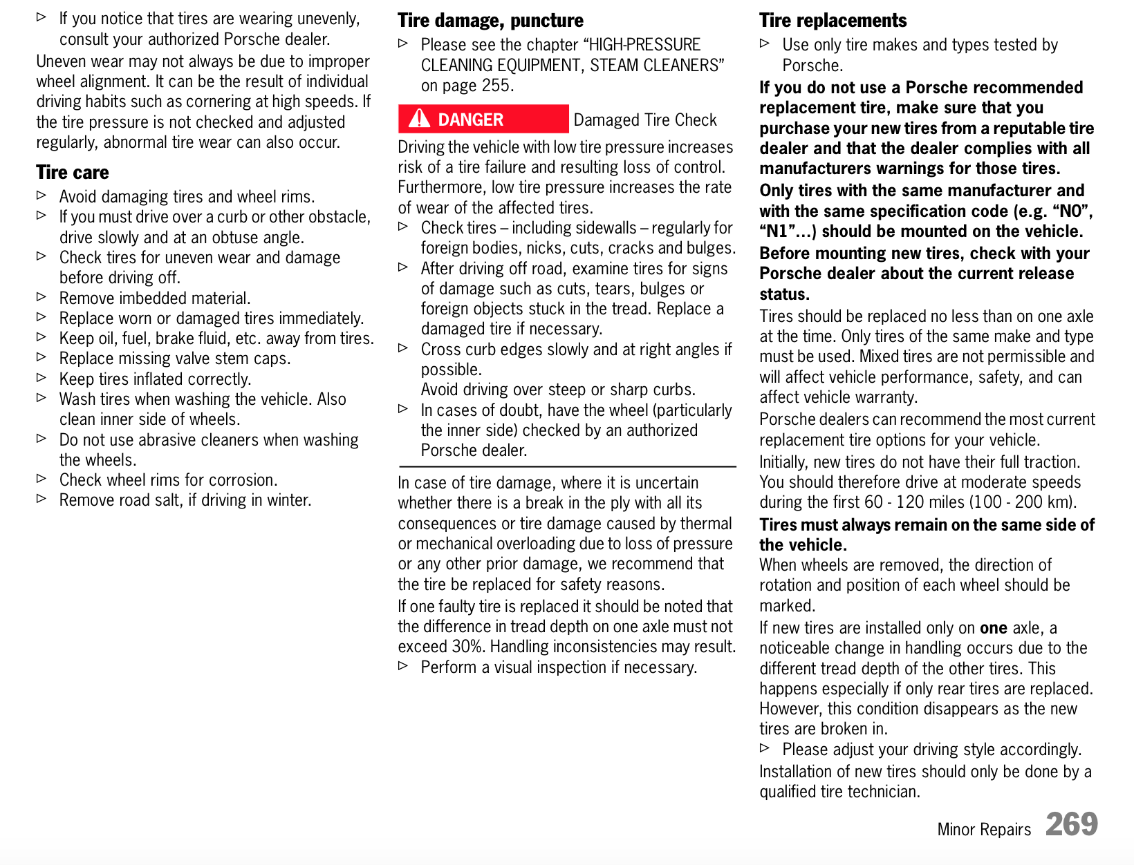

Rotating left to right and right to left..... is a no no.
Pretty sure my owners manual say front to back, back to front only.

This is what i have been going by.
Cayenne user manual - sentence in bold on the bottom right part of the page...
"Tires must always remain on the same side."
I see it, but I don't get it.
Cayenne tyres aren't directional, so unless the fact that there maybe some sort of braiding memory that builds up in the structure of the tyre, and reversing this could affect handling is a issue - I don't understand.
