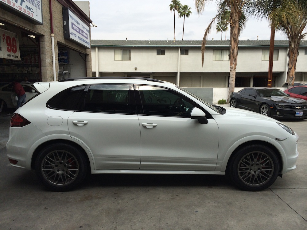

Suntek Carbon 35% Tint (my goal was to match the factory privacy glass) my installer recommended this one and I would say it matched the factory 99.99%, it even matched the "green" hue, turned out better than I expected

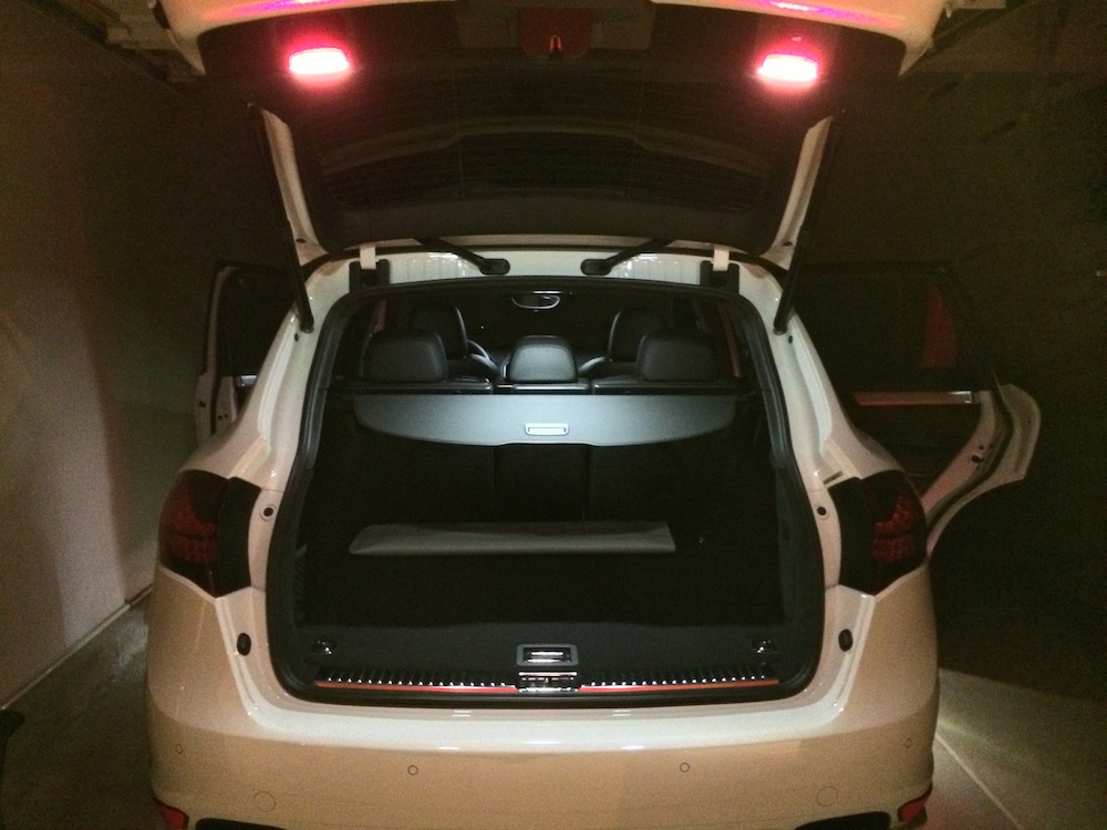

Here's an absolutely terrible shot of the Extended LED package, there really is a lot of light

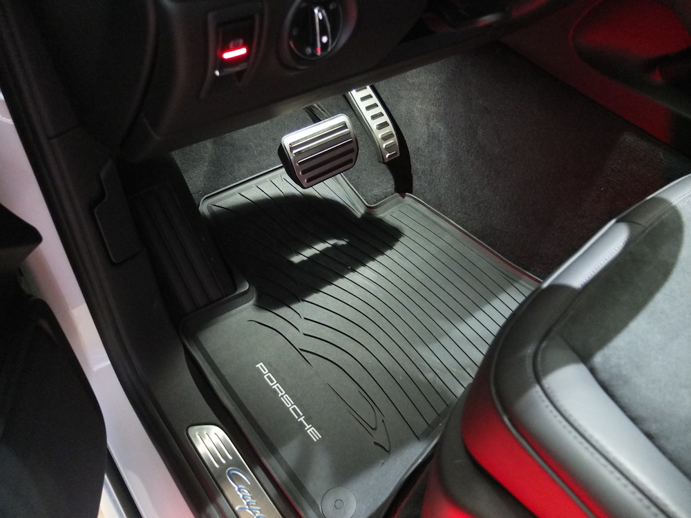

Thanks for the kind words!! I have the OEM license plate LED installed but still waiting on some few parts so I'll post that later once ready.

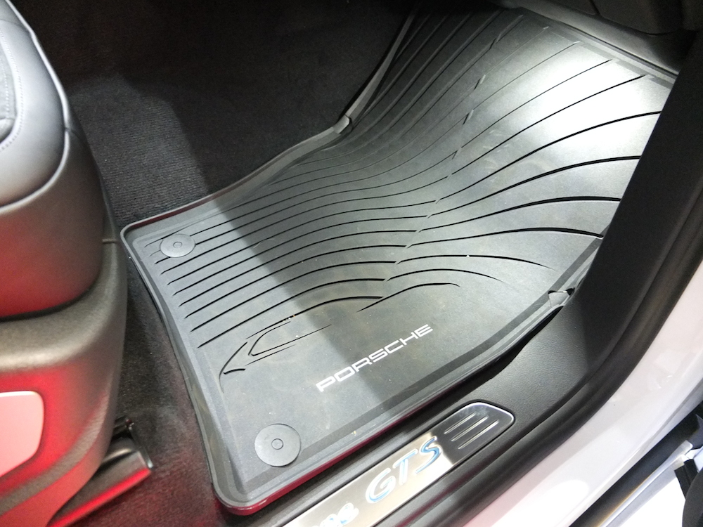

Now onto few more parts although minimal but I have a hard time finding pictures of these installed on the forums so I will post them for reference
OEM Porsche All Seasons Rubber Mats - 95804480051 (Black/Left-hand drive/2 zone A/C)
Driver side (love the cayenne silhouette)

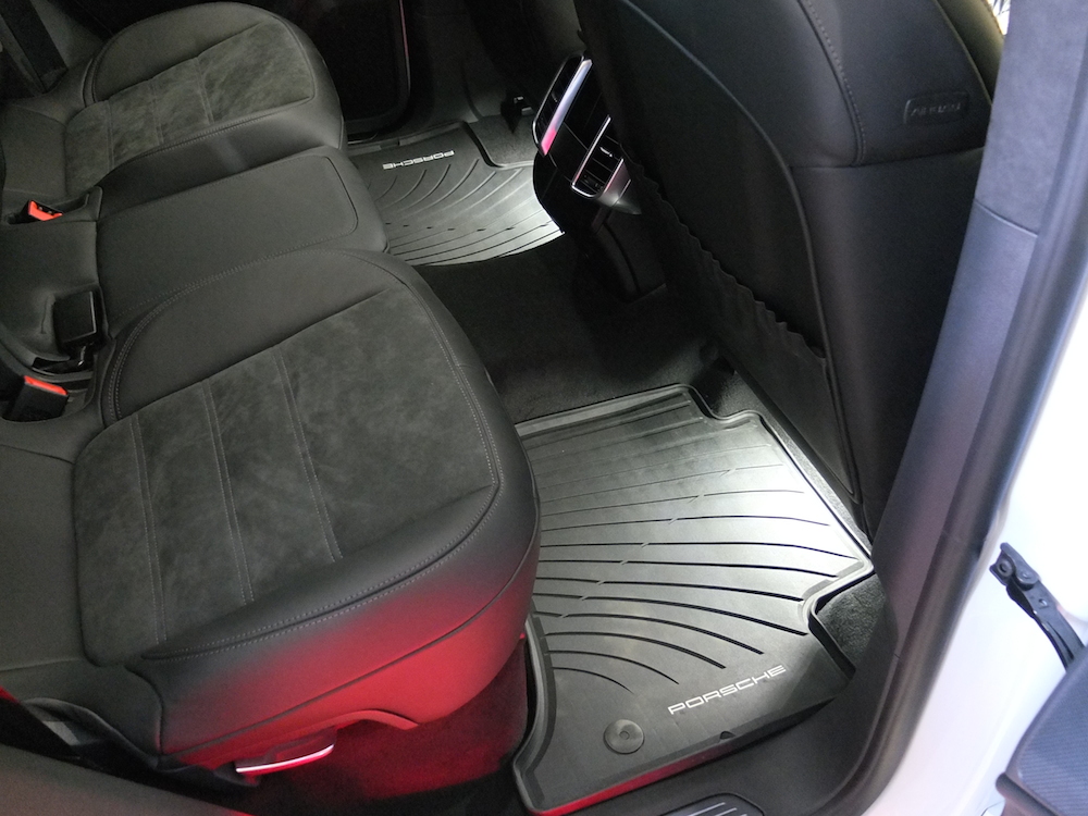

Rear

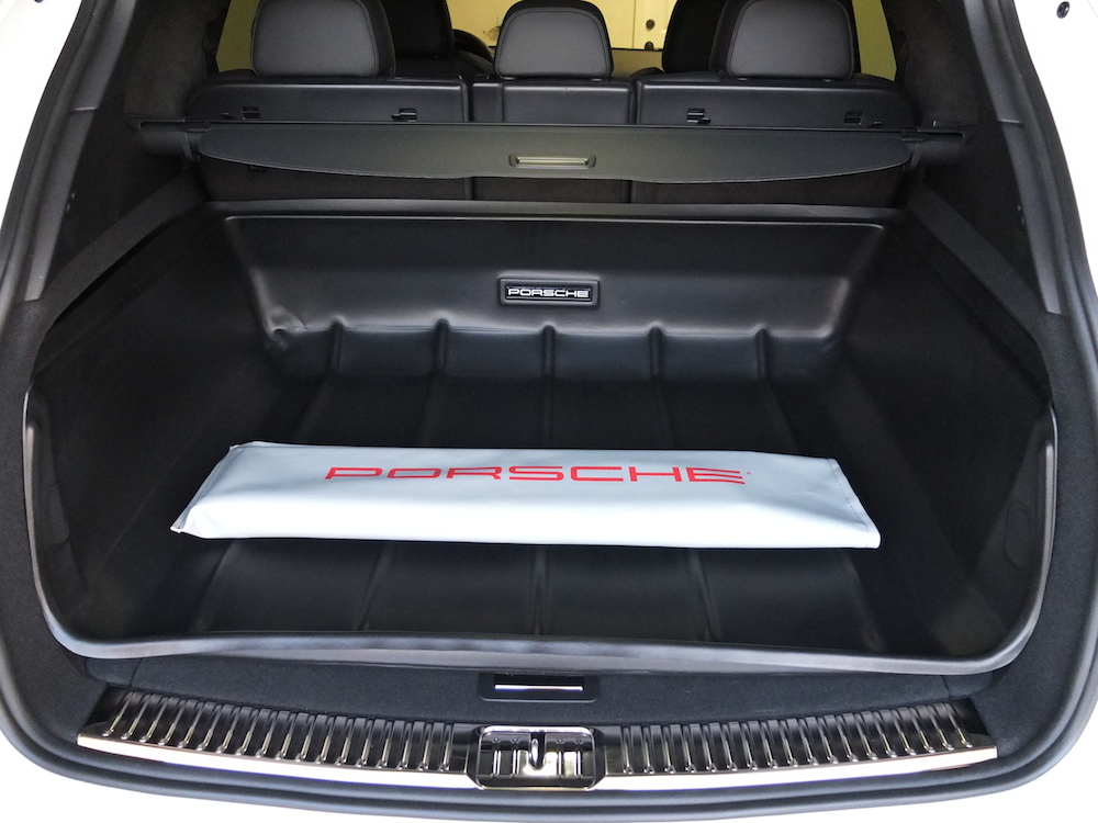

OEM Porsche Luggage Liner with High Sides (2 zone A/C) - 95504400015 (this material is very slipper for pets, I will spray some plasti dip for grip)
OEM Porsche Sunshade - PNA50595502 (in the pouch)

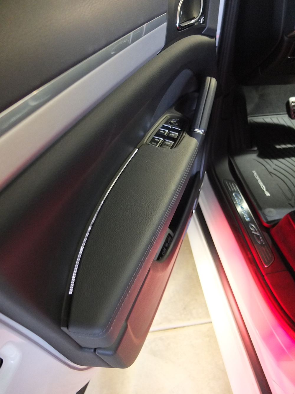

This LED strip is part of the Comfort Lighting Package, thought it was cool at night

I have the LED package on my vehicle as well... it seems like the door strip only comes on when you turn on the overhead cabin light... is there any settings to have it on otherwise? I'm assuming it's connected to the foot well lights as well... they all come on. I would like to have just those on without the overhead one. Let me know if I'm missing something.
My CTS-V wagon had cool ambient light along the dash and doors that was on at night... the lights are there on the Cayenne, but they're not on!

unfortunately, I feel the same way, overhead horseshoe is just simply distracting at night, even with it dimmed, the wife told me to just turn it off
so when I'm driving by myself, I just have the overhead and the door strip dimmed to the lowest and leave it like that, it's also connected to the footwell lighting as well.
you just hold the button until it dims to your liking.

I have the exact same thing- dimmed as low as possible for nice ambient effect. Fortunately is keeps that setting every time the car is started.

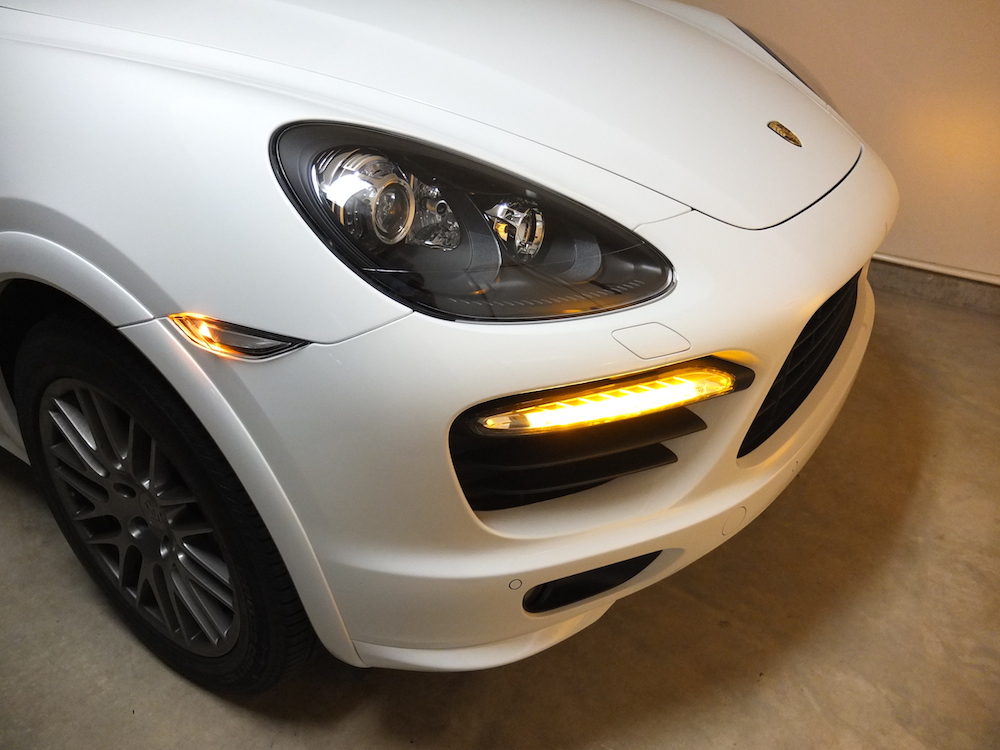

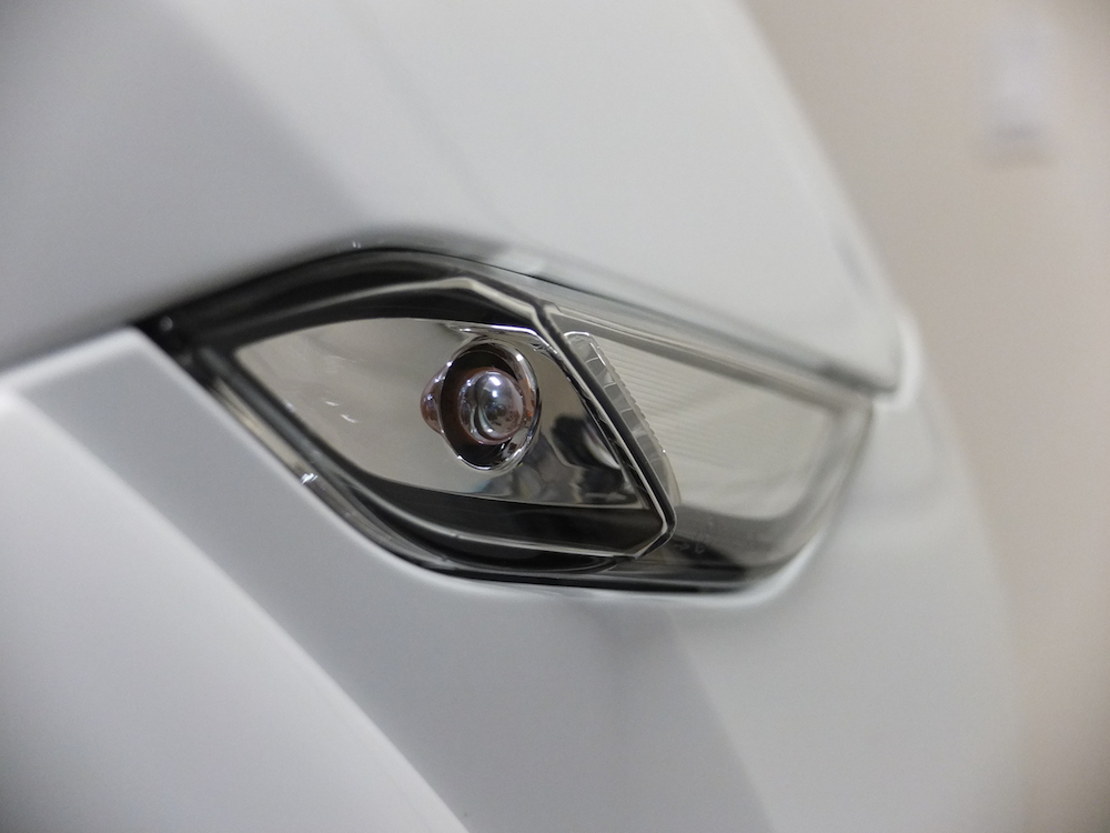

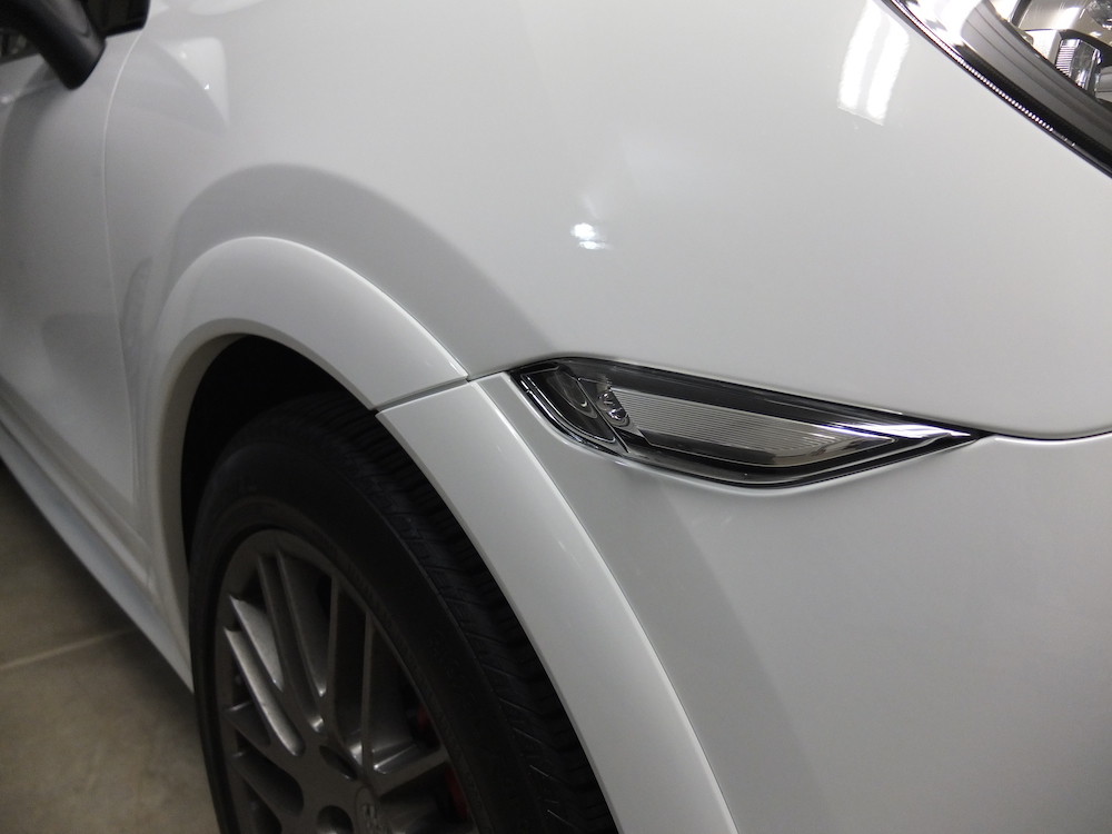

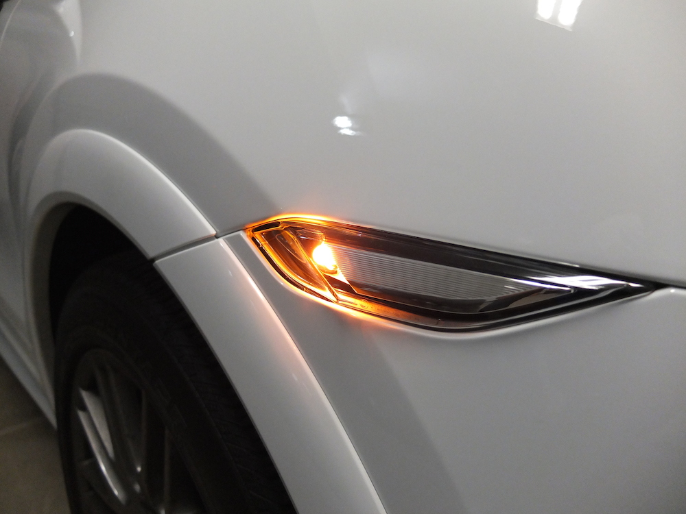

new stuff came in from UK
Osram Diadem "Chrome" bulbs vs stock clear bulbs (free with purchase)
This is to replace the stock "clear" bulbs that came with our amber sidemarkers, if you had put in amber bulbs for your clear lens, this will get rid of the ugly egg yolk effect
I've put together a DIY to swap this here: DIY - How to Change Clear Sidemarker Lens + Bulbs FYI
Results:
Blinks OEM amber
The bulbs will make the clear sidemarkers legal
it matches the OEM LED amber turn signal nicely
Almost invisible when off, this is a better solution for me than having a ugly LED inside or other bulbs that melted other people's lens
Too bad it's really hard to find these bulbs in the US, this is very similar to the Philips Silvervisions which is one of my favorite bulbs to hide the egg yolk
added: far away shot, barely visible

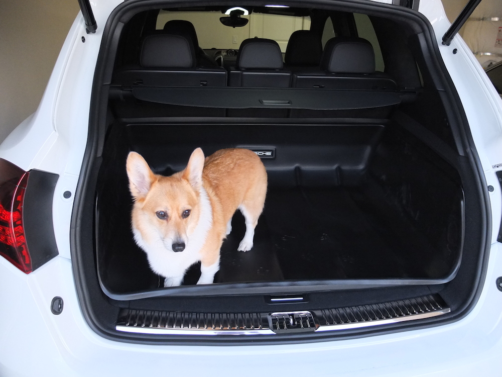

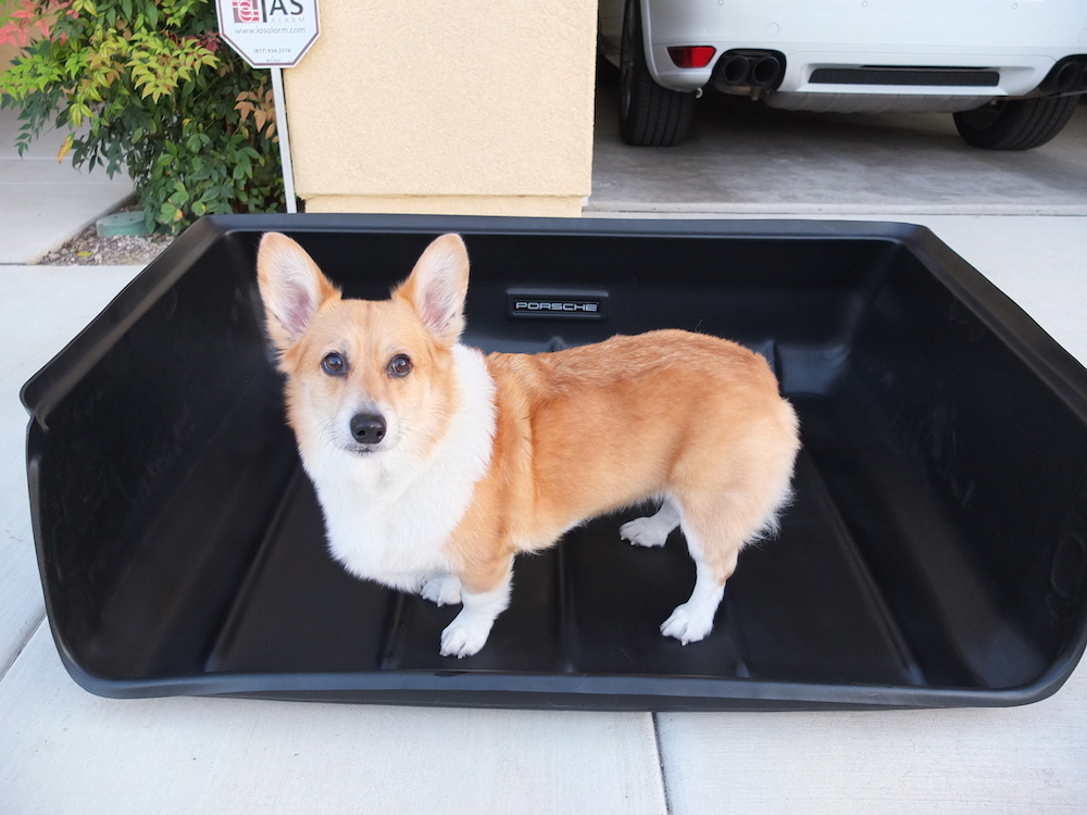

the OEM liner with high sides is made out of this slippery plastic, I guess it's for the ease of cleaning but makes it a rollercoaster ride for dogs
Here comes the Plasti Dip to the rescue, this was my first time using it
just followed simple instruction, 3-4 layers, 30 mins min apart, 4 hours to dry, and this was the result, it really became more rubbery, and non-skid surface
throw in the crazy fur shedding machine to test
now into the car, I'm sure he hates the car ride but at least he has more grip
