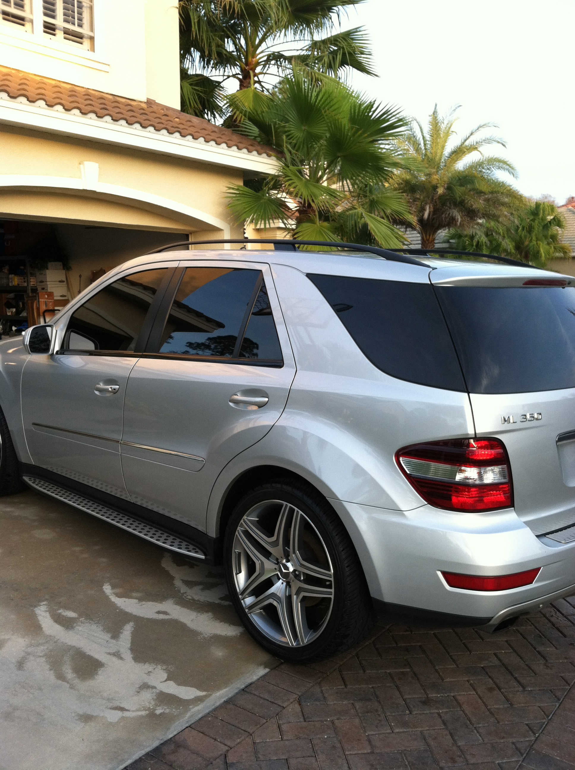

Originally Posted by mmdht2
my salesperson/dealer is well aware of the problem. he told me the remote deactivate trick when I picked up the car. it's more than annoying that I have to do that every single time I arm the car. my wife took the car out with her friends for lunch and the alarm kept going off because I forgot to tell her to deactivate the sensor-very embarrassing. what's worse is that then she couldn't start the car because she couldn't insert the key into the ignition!!! call the dealer/Porsche with no help. told her to lock and unlock then it should work but it didn't. I drove over with my key and muck around for 10mins and finally got the key in and started the car- double embarrassment and two strikes for Porsche. I have driven exclusively Mercedes in the past 20yrs including the cheapest C220 all the way to new S400 hybrid and CL600 V12-never any problem like this in a new car. I kept telling myself that maybe this is because I got the "cheap" Porsche. to be honest, my wife's W164 ML350 drives better than the base Cayenne in eco mode- I hope it will be different when the break in period is over and the car in sport mode. I'm going to reserve my opinion on Porsche until I buy a 911 4S.
Idk… I traded my W164 ML350 for the “cheap” Cayenne (V6) & I have to say I enjoy the Cayenne better. Comparing them both stock & modded, I give the edge to the Cayenne. Granted the Cayenne seems to be a bit more problematic, but before I lowered my ML the handling was boaty.
