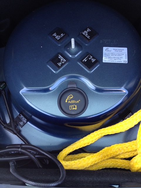

Not that this is difficult, but I figured I'd document it anyway.
Currently this only includes using the "crush" bottles, but as that would be expensive to use those for the whole 5 gallons I don't recommend doing that. Next week I'll pick up some 2.5 gallon bottles and document converting the crush bottle into a funnel to use for filling from those.
All you need is a pair of hands and a "crush" bottle of AdBlue.
  1. Open the rear gate.
  2. Lift the spare tire cover and prop it up with the rod.
  3. Remove the wing nut holding the plate that secures the spare tire (pic 1).
  4. Remove the spare tire (pic 2).

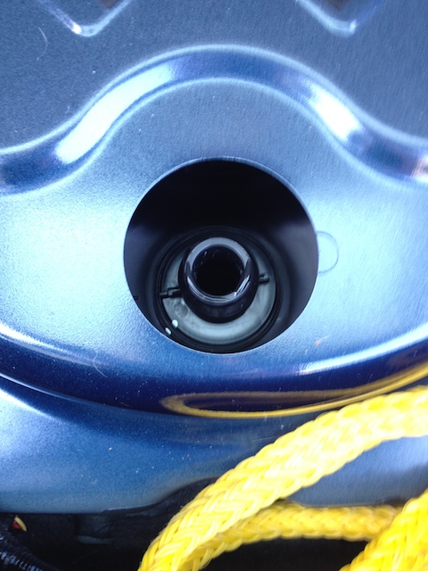

  5. Use the tab on the AdBlue cover to pull it off (pic 3).

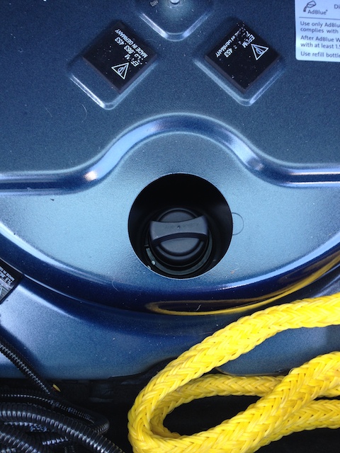

  6. Unscrew and remove the filler cap (pic 4).
  7. Remove the cap from the "crush" bottle.
  8. Invert the bottle, insert it into the filler neck, and screw it into place.
  9. Press the bottom (now top) of the bottle (pic 5) and the fluid will drain into the tank.
  10. Remove the bottle and reverse all the steps.
