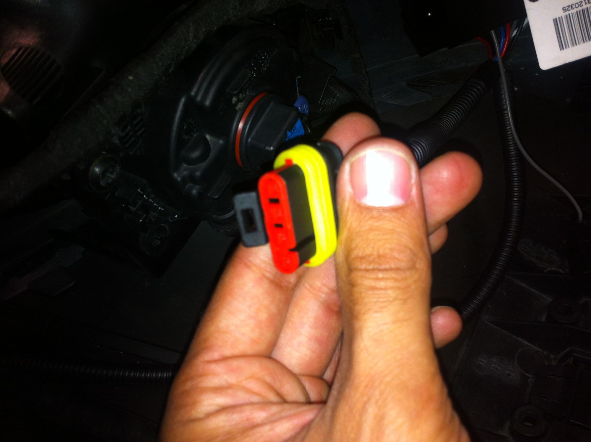

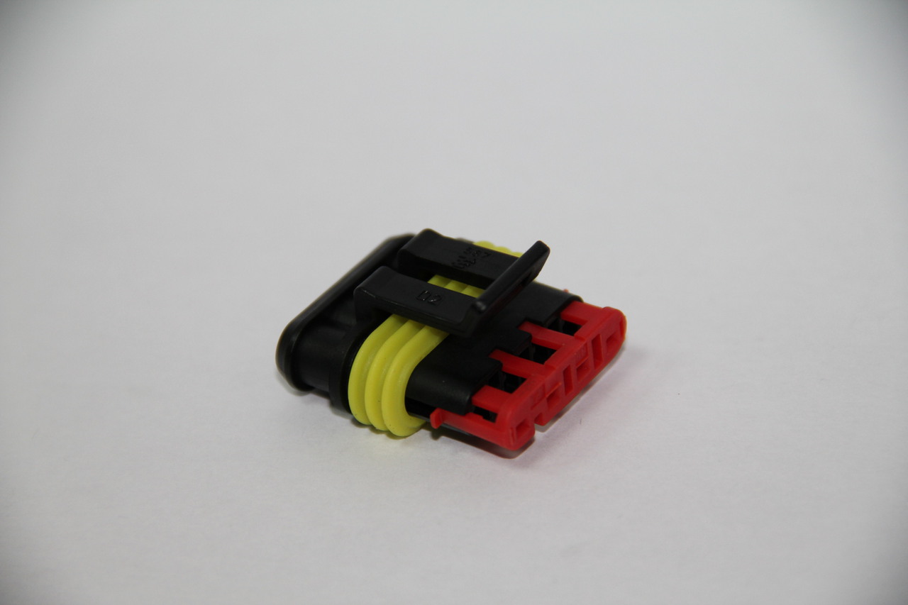

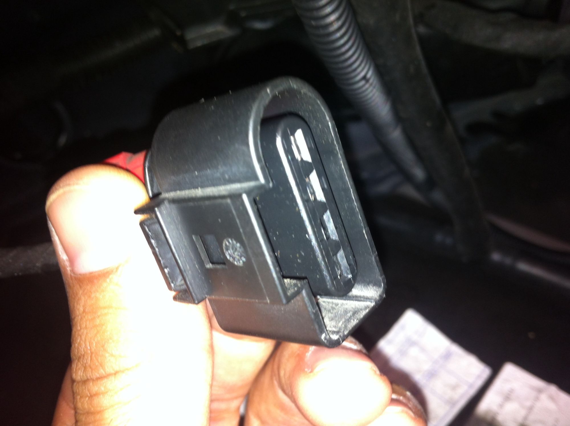

ok guys above are the pictures of the connector. It supposed to be a male-to-female but for some reason it came out with male-to-male.. The connector in the 1st picture is from the car and the one in the 2nd picture is from the DRLs.

1j0973824 - buy this connector at vag shop and replace second one. n103189105 - pins x4, 357972741 - seals x4
or go to car dismantle yard and cut this connector from used vag lambda-probe
as "thank you" you can make more pictures of how all installed from inside - where to put unit(s), where loom, etc

That's a weird plug. Never seen that before. Is TA not stepping up here and getting you the right part or an adapter?

Originally Posted by Serg124
what plug are weird??
The one on the TA DRL. That doesn't mate to any plug I've seen on the 958. It also makes no sense for this application as it only appears to be two pins and the signal bars need 3 (TT/GTS bar) or 4 (normal DRL + signal bar) pins to work.
Old May 29, 2014 | 11:11 AM
Serg124's Avatar
Joined: Mar 2013
Posts: 567
From: Russia
Rep Power: 74
Serg124 has a reputation beyond reputeSerg124 has a reputation beyond reputeSerg124 has a reputation beyond reputeSerg124 has a reputation beyond reputeSerg124 has a reputation beyond reputeSerg124 has a reputation beyond reputeSerg124 has a reputation beyond reputeSerg124 has a reputation beyond reputeSerg124 has a reputation beyond reputeSerg124 has a reputation beyond reputeSerg124 has a reputation beyond repute
bad photo, too much flash & no focus. it is 4 pin, in fact this two are same, just different manufacturer, vag one have additional outside part. such plugs are selling thru WURTH shops as universal.
