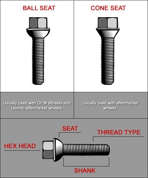

The lugs shown in those pictures won't fit any factory Porsche wheels regardless of the length or thread pitch: Porsche uses curved / mushroom shaped shoulders not cone shaped as shown in the pictures.

thanks!! u just saved me from a lot of frustrations. Porsche uses "ball seat" instead of "cone seat". I will take the current one down to measure the length and order the correct ones.

can you look at a wheel to tell whether it's a cone or ball seat?
Old Mar 3, 2015 | 01:08 PM
mmdht2's Avatar
Joined: Jun 2014
Posts: 141
From: pa
mmdht2 is infamous around these partsmmdht2 is infamous around these parts
like the replica wheels, how do i know if they are ball seat like factory or cone seat like other aftermarket wheels?
