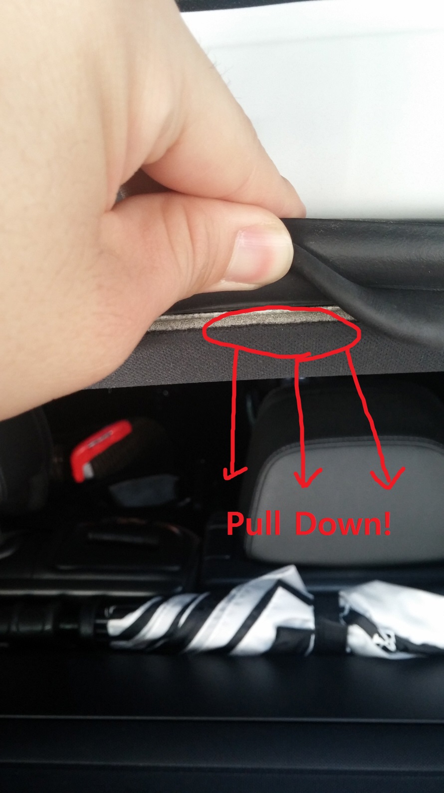

Here is what I've did.
only remove trunk trip on that pics then put wier to that rubble. you need wire shielding like this link : http://www.stewmac.com/Pickups_and_E...iEOxoCKK_w_wcB
First time, I didn't shield my dash cam for rear, and I found dashcam 12V wire effect to remote key. so I couldn't lock/unlock the car in 3 meter....
so I used shield for that dash cam 12v, then It's solved. that's why I highly recommend using wire shielding.
then you can put wire like 2nd pics....
It's just 10-15min job.
Good luck!

how did you slide the wire underneath the left rubber boot. Did you push it through from inside the trunk ceiling area?

Just pulled down that ceiling trim. you don't need to remove whole ceiling. just little space and put your hand to grab wire that comes from top of sides.
