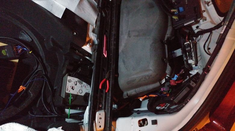

Location of amp is rear passenger side of trunk.
I hope the
se pics are help to figure out amp location.
this is amp. non bose. base + PCM
Unfortunately, I Can't remember wiring... but right side of RED/GREY might be 12V/gnd... there were 6 wires for front, 4 wires was for rears

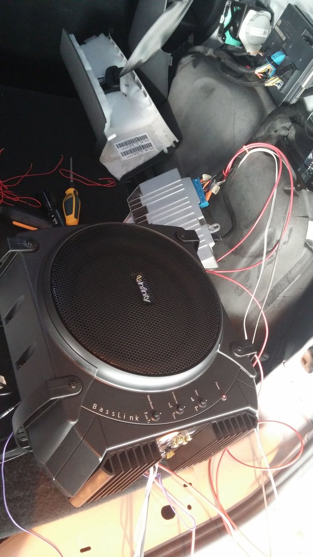

in my case, I just hooked up infinity basslink - digital inputs... (skipped H/L converter and amp)
sound is not that great...(sounds doesn't playing together...I fills like cayenne sound and sub sound saying "I'm better! Who care!?"....)

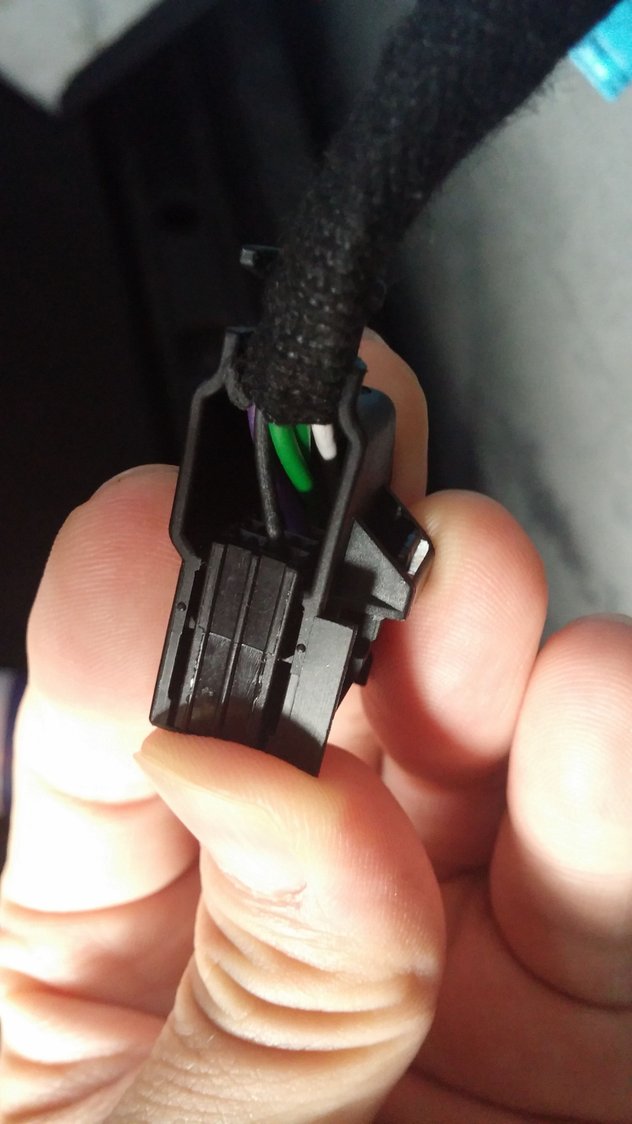

Unfortunately, I don't have diagram now. but if your system only have PCM /w.o. bose or burmaster, changing audio is not that hard.
PCM headunit send to two analog +/- to amp(on trunk) (no bose/burmaster system only). I just change those analog to RCA, then hook up wires same as pics.

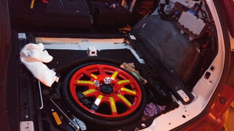

In ma case, I put amp and crossover(front doors) in trunk under spare tire. but current amp doesn't have enough rms amp.. so I'm going to replace it Alpine pdx-v9 on next week. at that time, I'm going to take more photos for wiring for you.
power cable comes from under driver side
original amp is on rear passenger side wheels. after market amp locate under spare tire
