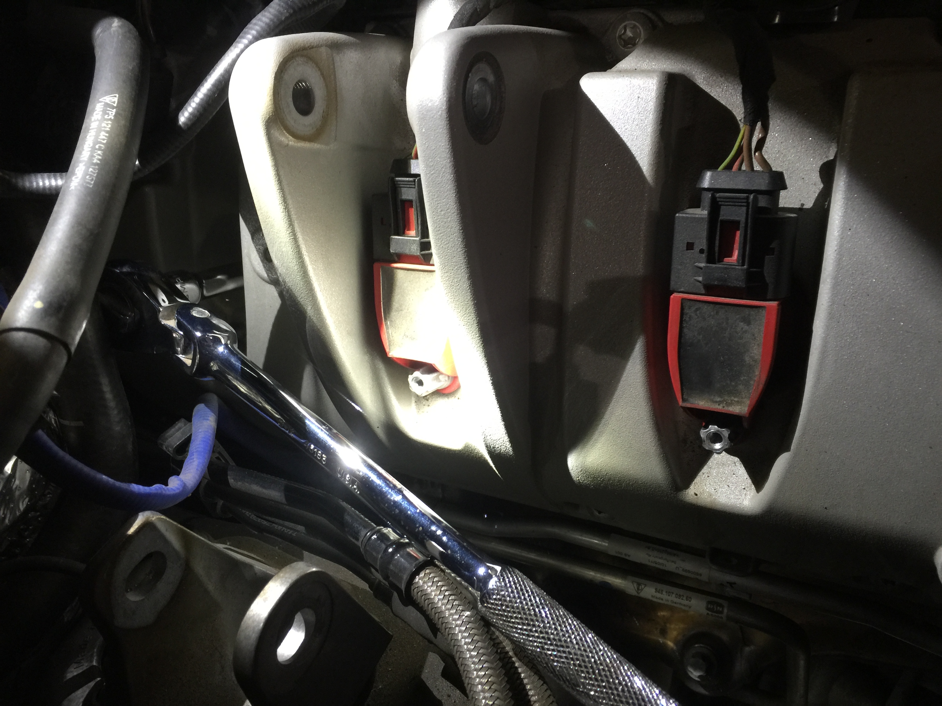

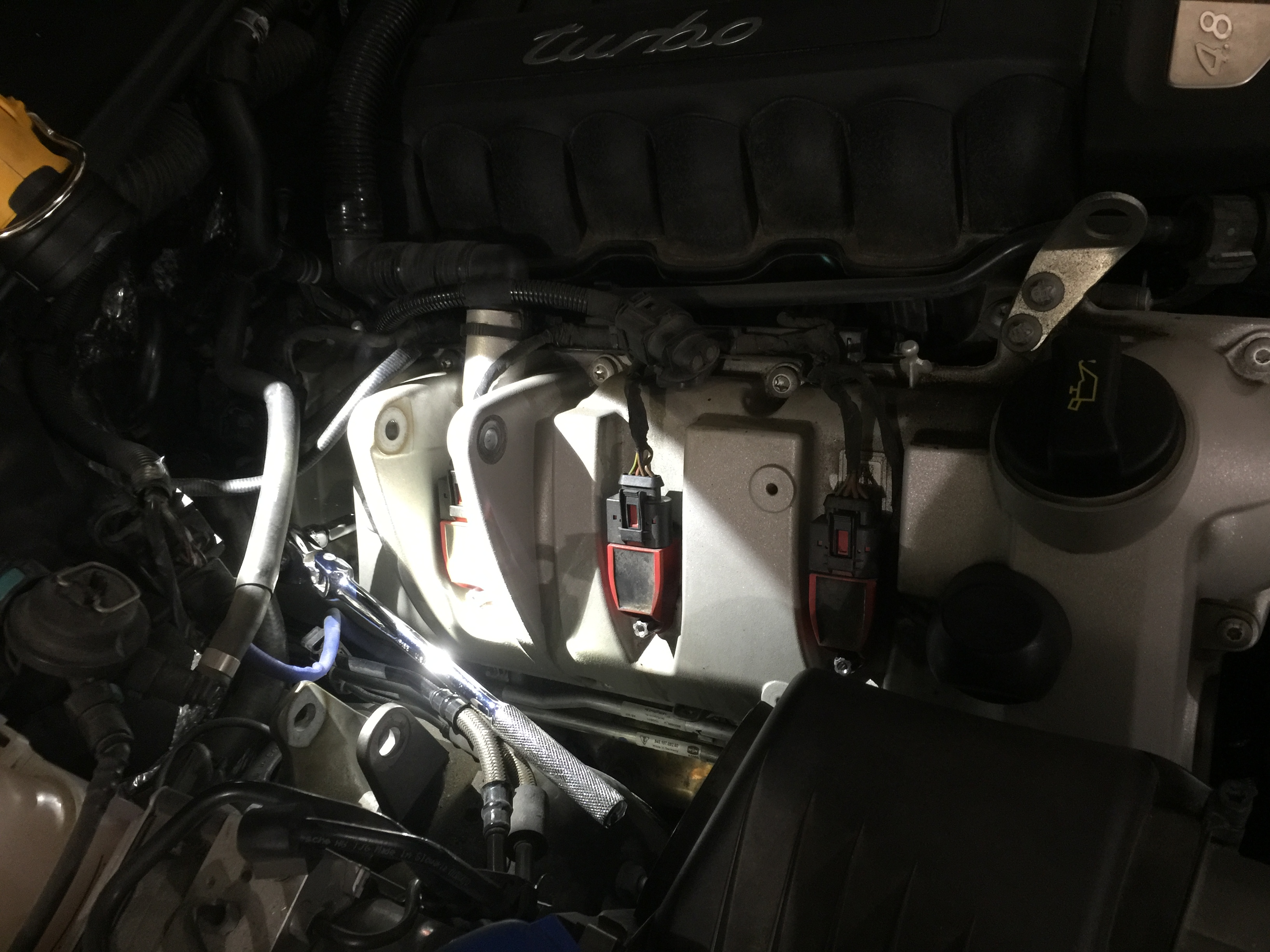

I just did a spark plug change on my CTT.
Not sure if it will help specific to a v6, but it cannot hurt.
Overall, it was pretty straightforward.
You got to have the right tools and go slow.
i will put the DIY together in the next few days if time allows.

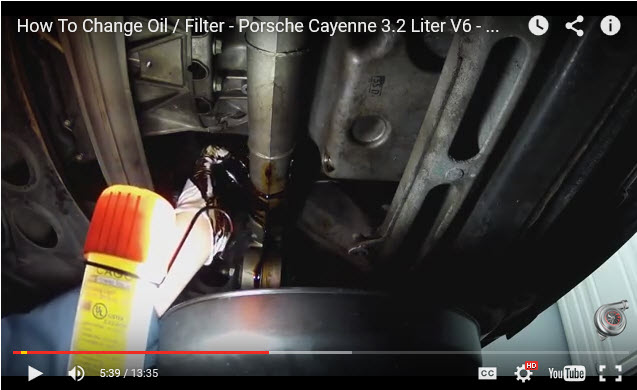

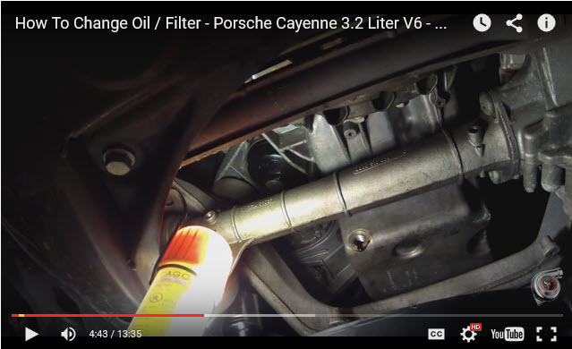

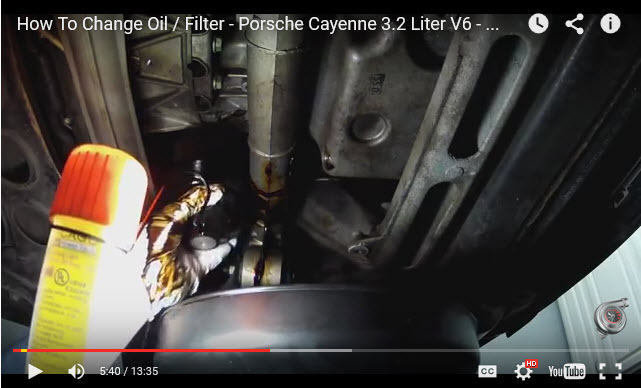

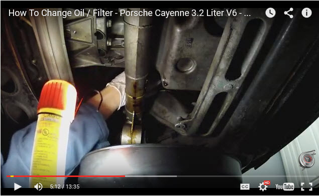

lol, i have changed oil in all of my family's cars in the past 25 yrs. from japaness to american to german (merecedes are the easiest). probably more than a hundred times. the oil filter was changed long AFTER all of the oil has been drained. that's the left over oil in the filter housing itself. there is no clear path to get to the filter housing so you can't even put something under to catch the spill. the oil start to spill out half way as you turn the housing. that's why my arm is covered in oil. you can't avoid this unless there is a way to suck out the oil in the filter housing first or put a whole lot of rags around the housing as you open it up. next time, i will put some rags around first.Originally Posted by BlazinPond
Yikes. The pictures almost makes it look as if the individual forgot to drain the oil FIRST,
Before, removing the filter. Otherwise, i don't see how it could ever be that bad.
Regardless, the pics above should NOT scare off the DIY'er interested in changing their own oil.
That is very a-typical in my book.
no offense, but have you changed the oil yourself in a cayenne before? if you have, i would love to see a video of how you can stay clean during the filter change. changing oil in cayenne is no different then changing oil in a honda or ford. it's just the location of the filter housing makes it messy. it's not hard. it would be easier if you have a lift and more room to put a small pan under it.
this is a poor design. the mercedes oil filters is accessed from the top. you open the top and pull the drained filter out. i can wear a tux to change the oil and filter without getting a drop on me.

On the v6 it's pretty tight quarters under there where the oil filter is located. Even after draining the housing, it can make a mess. This guy in the photos below had it on a lift and still had considerable amount of oil splatter. I made a big mess the first time and got better with subsequent changes. But its not nearly as clean as changing the oil on my 997.2. Paper towels are at least cheap.

thank you for the pics. you have to be under the v6 to understand that there is no clean way to replace the filter. next time, i'll have a whole bunch of towels around as i turn the housing. i took some pic during the oil change planning on posting a diy but didn't post it because it's no different than oil change on other cars and also the mess i madeOriginally Posted by wwilliams88
