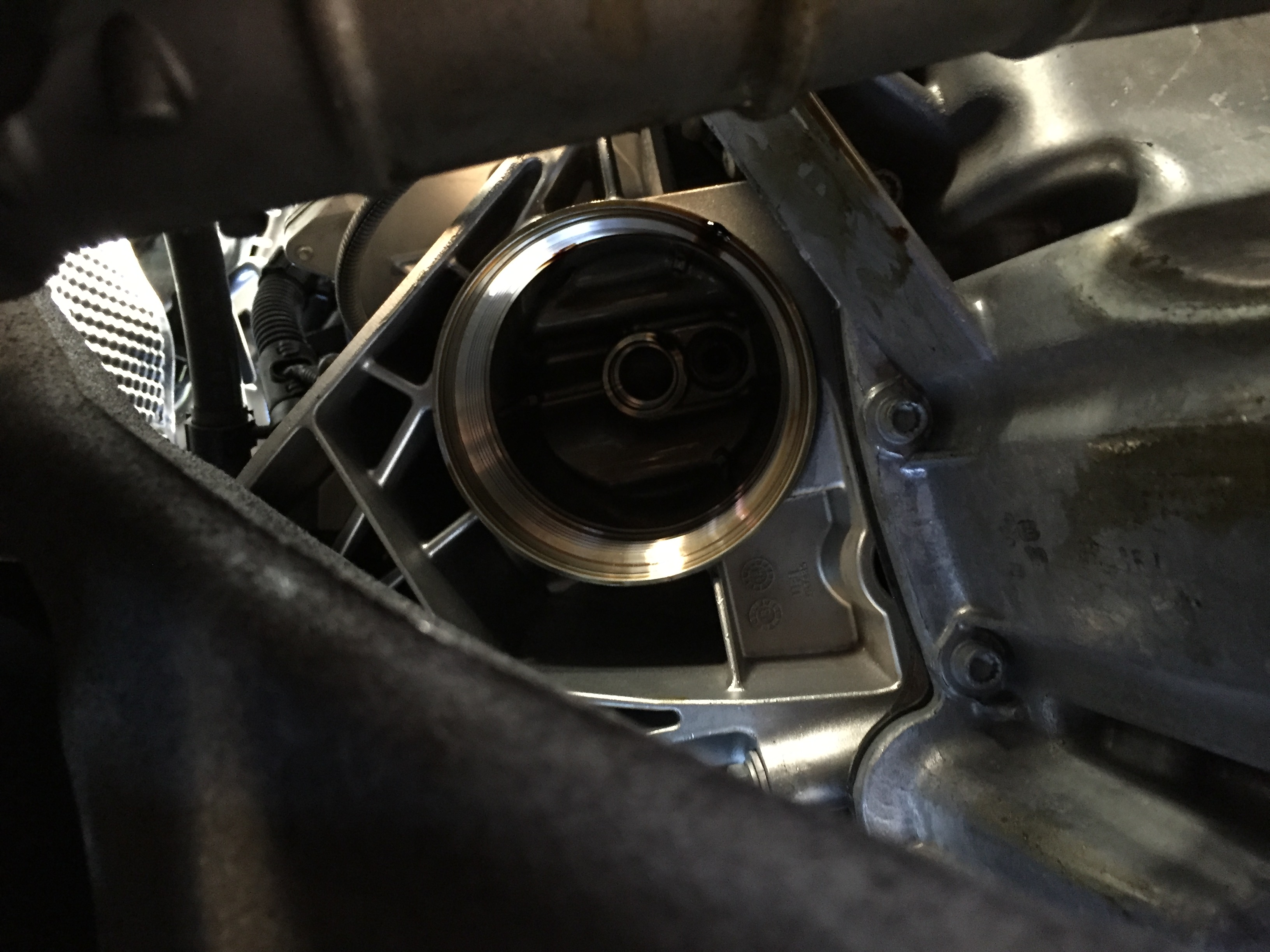

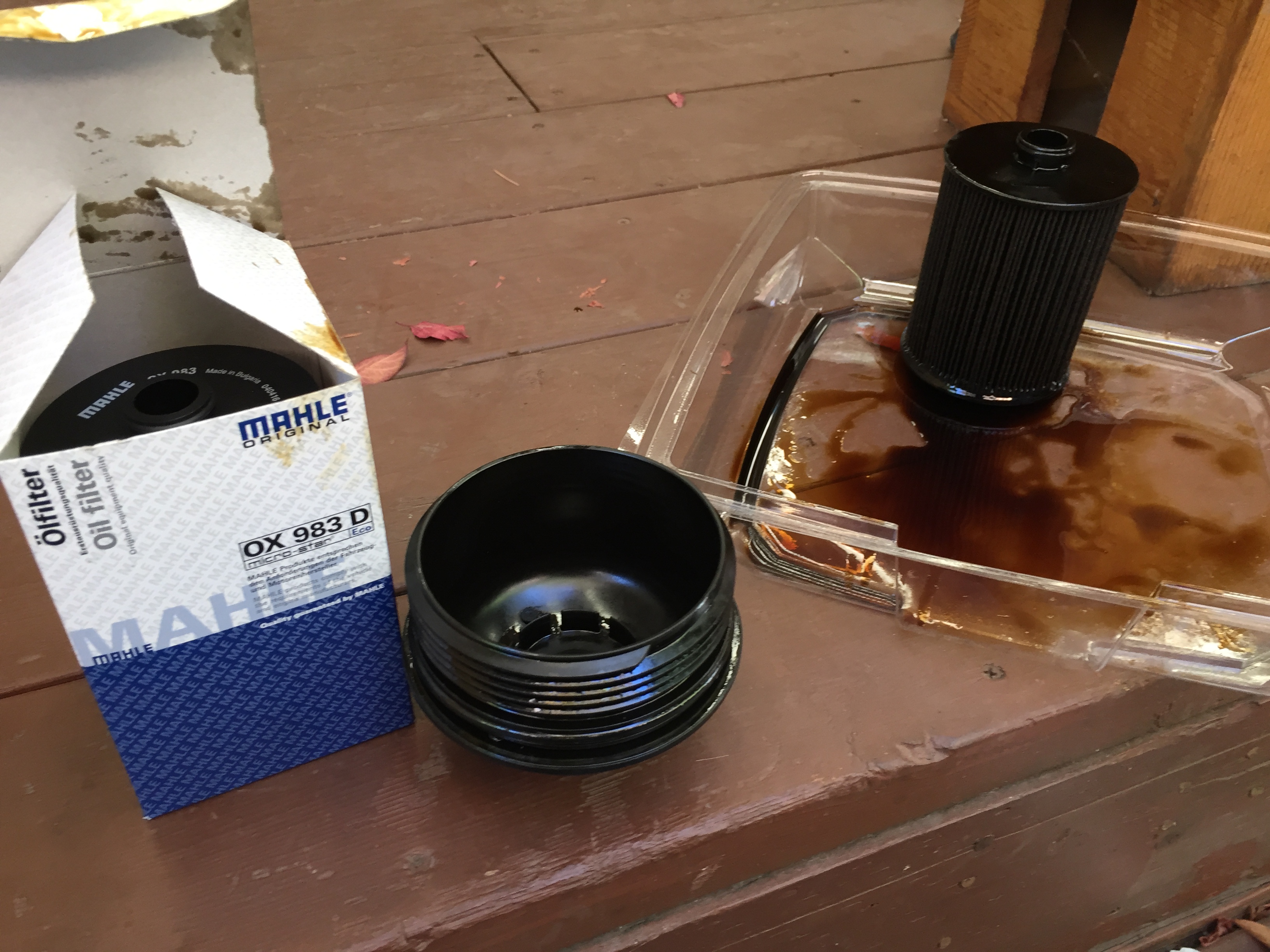

Agreed, the 2014 Cayenne V6 is very similar to the Touareg. The space is very tight. I can't even drop it down. Remove the filter so I can tilt the Oil Filter cap to get it out. So it important to follow procedure as shown in Touareg link. Oil capacity is 7.13 Quart. I filled 7 Quarts first and refill after the oil level indication.
My Porsche SA gave me a free reset ... Otherwise I have to buy Durametric tool.
