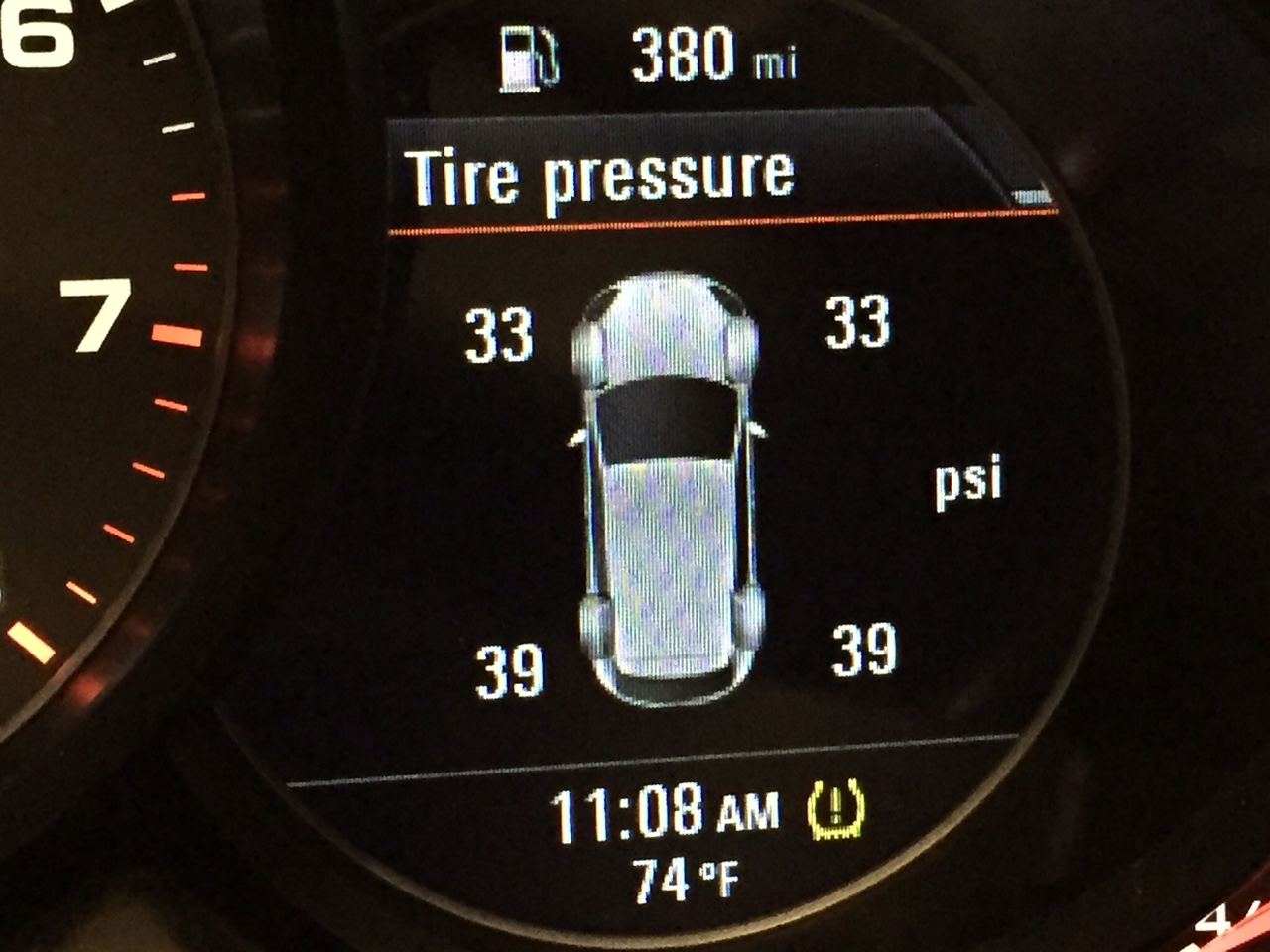

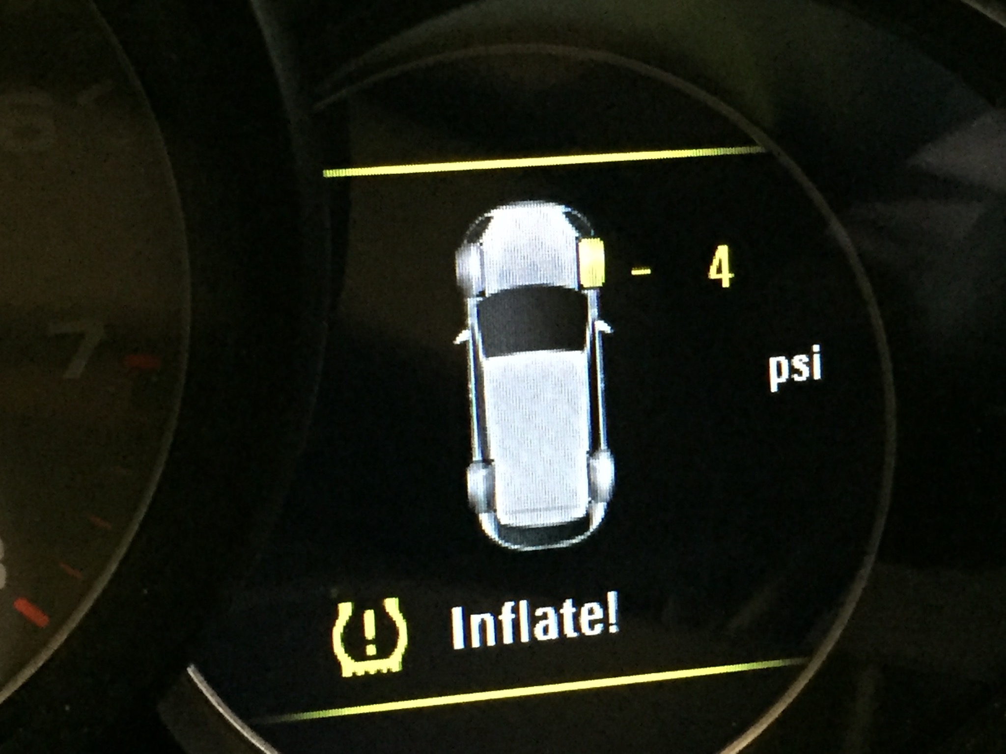

I need some help. About a couple of days ago, my TPM gives off a warning sign saying I should inflate my front right tire. I then go check the PSI on the system and it says it's correct and all good. I mess around with the settings and reset it by jumping between partial and full load. The error message disappears. I chalk it up to system glitch.
This morning, after driving a few minutes, the error message comes up again. Why would I need to inflate that tire if the PSI is correct? I've attached pictures and would welcome some feedback on what is going on and whether or not I have a real issue.

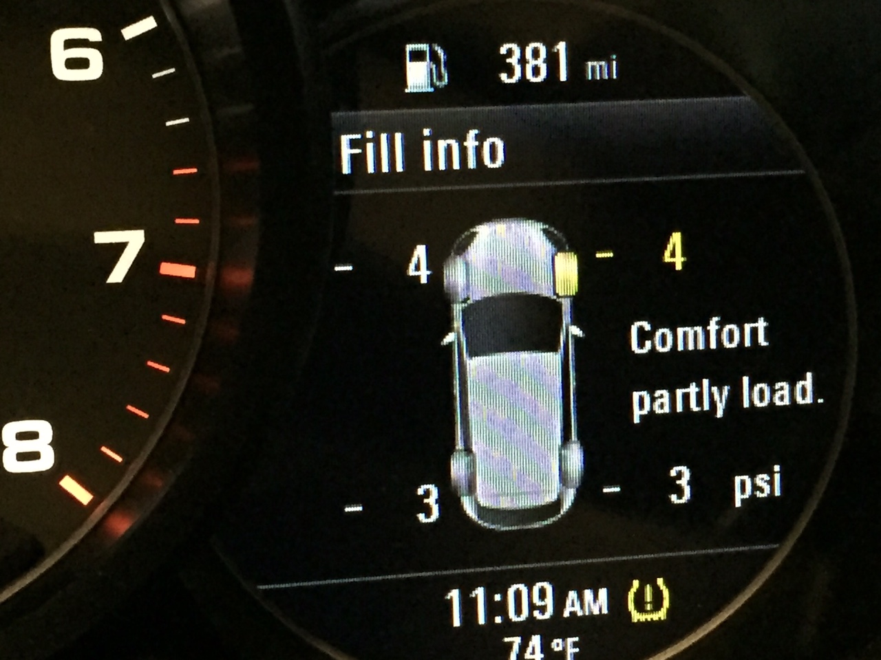

Seems it doesn't like a yellow -4. Have you tried filling them so they are all at 0?

I think you might be at the trip point of low pressure and tire pressure required is adjusted for tire temps that may differ between tires On my 16 Cayenne S, the partial load settings are 35 front/38rear for all season 19" tires. So why would you set them lower than that? It appears you have then set 4psi low? Increase tire wear and vehicle stability issues may result

As donaldm said - you're right where the system thinks something is wrong. The readout seems to jump by 2PSI increments on mine - meaning one tire could be actually at close to 2PSI rather than 4PSI, and it probably won't trigger at 2PSI.
Is it difficult for you to correctly set the pressure?

What is interesting is that I manually measured the PSI in each tire and it came out to 33, 33, 39, 39, just like the computer readout. So why is 1 tire low?
Also, I had it on comfort, partial load, 21 inch summer tires so those PSI should have been correct.
I ended up changing to standard and upped the PSI to 37, 37, 42, 42 (the standard for 21 inch summers). So far the system thinks it's ok but we'll see in the next couple of days.
Perhaps one TPMS sensor is out of calibration with the rest of them? Do you have a diagnostics tool (ICarScan, DuraMetric?) - you can read the values directly with the tool, and the ICarScan will also tell you how good the batteries are in each sensor.
That's not what the computer thinks. It thought ALL your tires were low for that setting. That's the purpose of that display, so you can set your tire pressures in real time to what the computer wants for the use selection you made.
