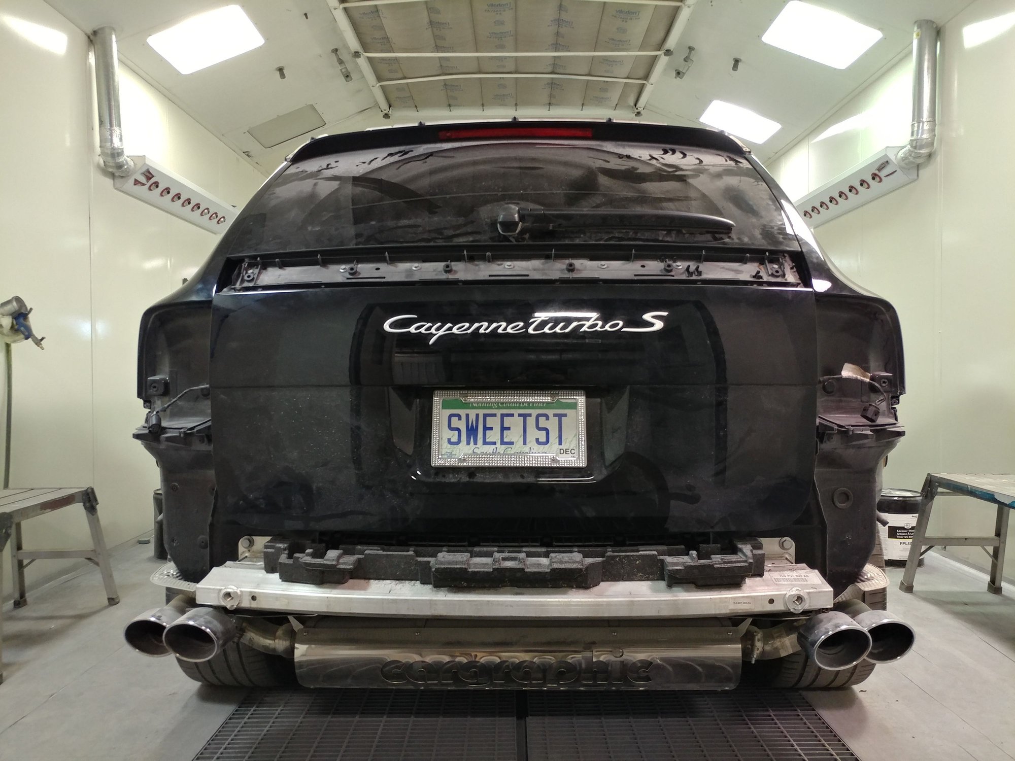

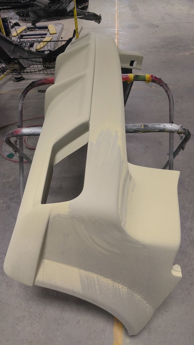

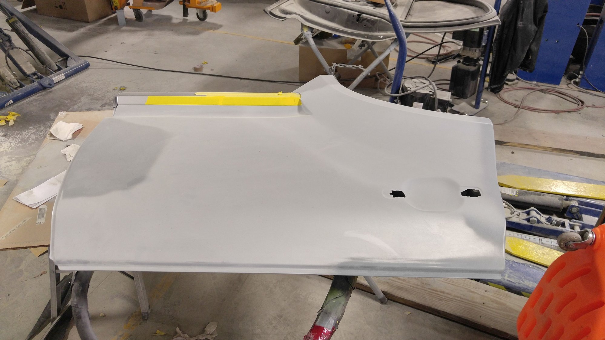

Quick update - body work continues and they about have the rear bumper completed. Since it's going to be one color on our car, rather than having the lower section a black or CF look (which I think then makes the rear bumper then look too narrow), we decided to bond the 2 sections together once the fitment work was completed.
Looks like this now and is just about ready for primer.

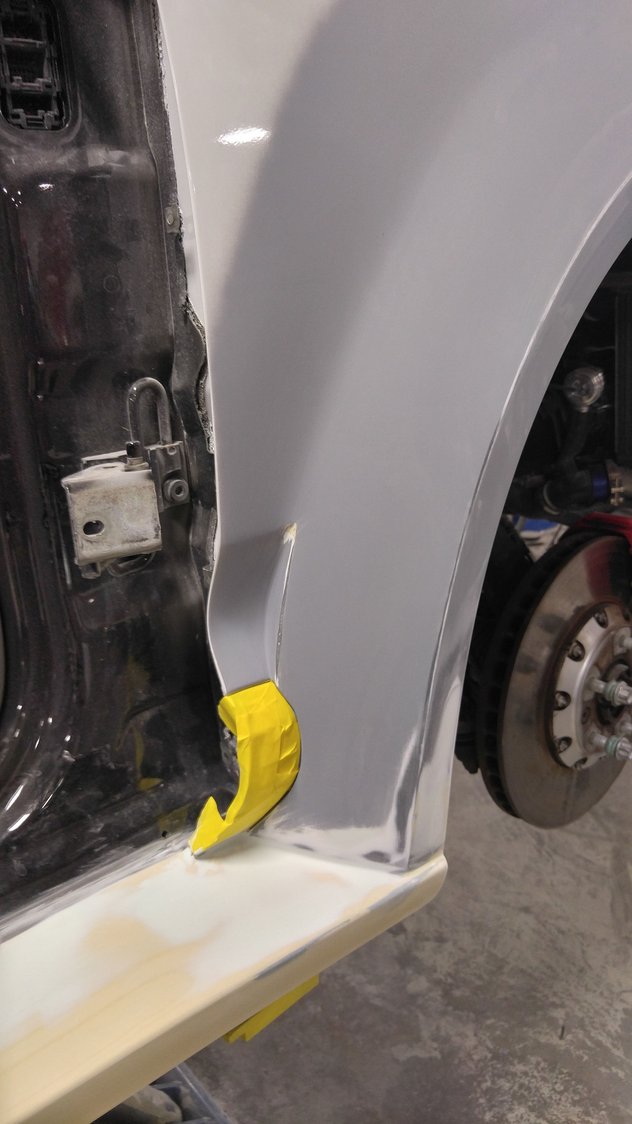

They're also working on the front bumper to front fender transition and are going to have to build up then reshape the curve of the front bumper to make an even panel gap.
More work is scheduled for this Saturday.

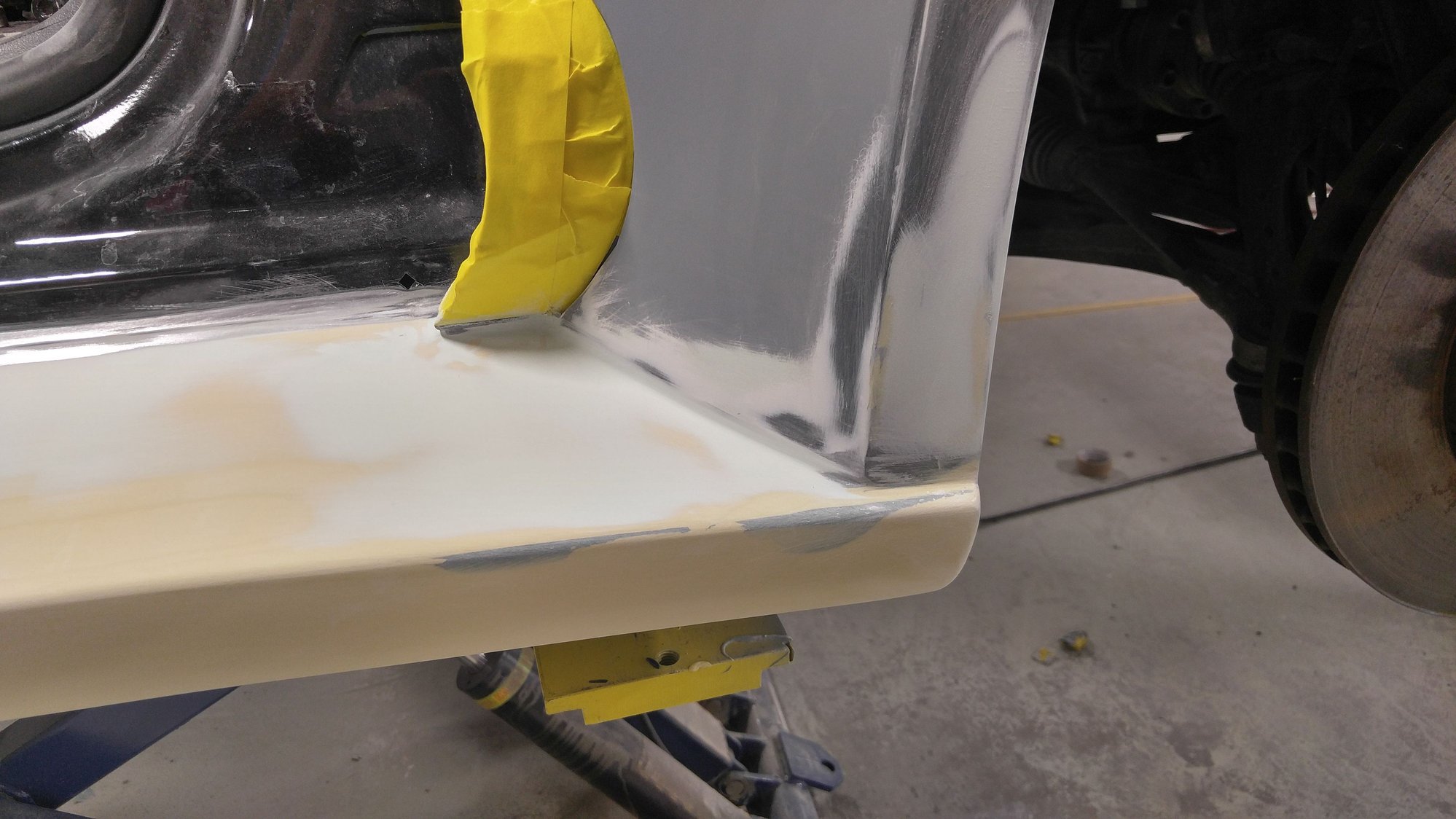

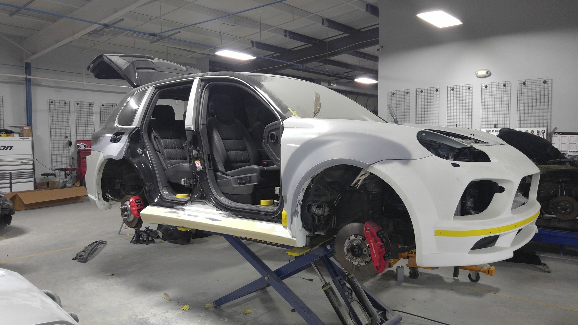

Quick update with a few pics from about a week ago. I hope to get by again tomorrow to check the progress.
  • Right side Rocker Panel is installed
  • Rear Bumper is installed with parking sensors
  • Front Bumper sensors are marked for fitment

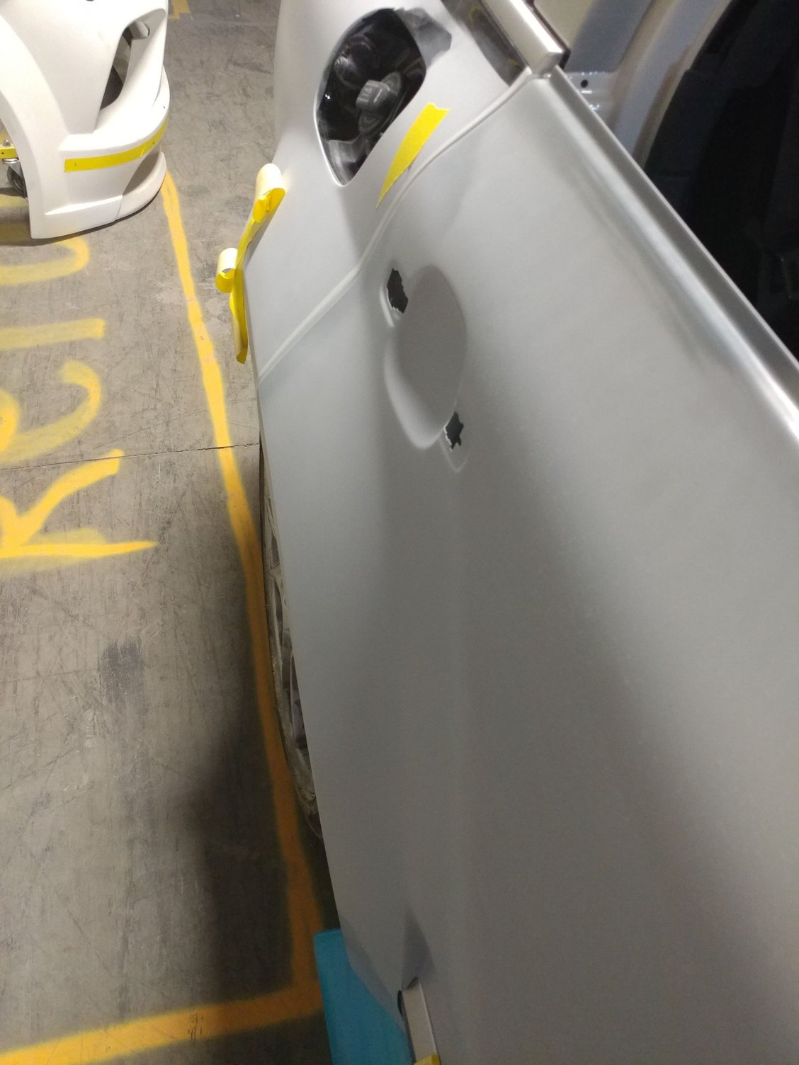

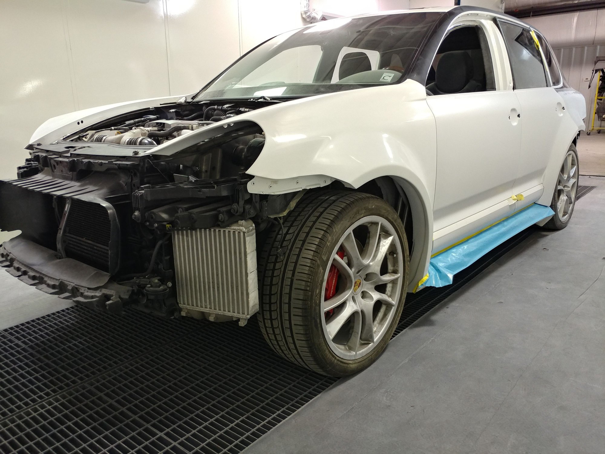

All 4 interiors of the doors and their door jambs have now been painted and the doors have been reinstalled onto the car.
This weekend they'll be removing and taking care of the rear hatch jam and painting the roof since it's a different reflective surface and doesn't need to be painted at the same time as the rest of the exterior. Then they'll finish the fitment of the front bumper and prep the complete exterior for the final respray. Bumpers and hood will be painted off of the car for completeness of coverage, then reassembled.
Here's the current status. You can see how well the flare pieces line up between the door and rear quarter and also why the stock wheels are being changed out for larger and wider ones since they're too far inset, and though 21s, dwarfed by the aggressive body flares - new wheels are a 22"x12" with 315/30 rubber.

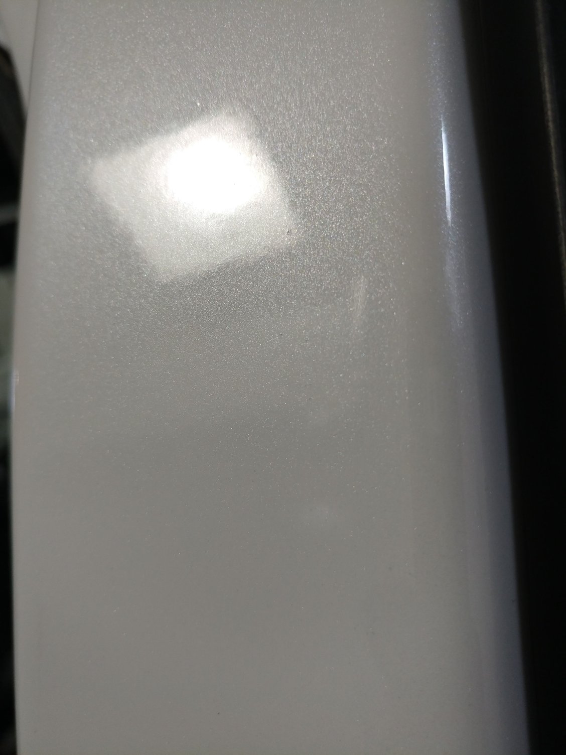

Your wait for "some color" is over....the body shop painted the roof over the weekend - like I said, not a lot but "some". I told them to absolutely not take any of the Pano roof apart and to just mask it off as a large central fixture and paint around it. No way I was going to risk trying to get the complex mechanism installed again and adjusted properly.
They also started disassembling the rear roof spoiler to get it off of the car so all the little channels and layers could be painted properly.
The close-up of the paint is actually on the B-pillar that will be covered up by the satin aluminum trim so don't worry about flaws in it, but it was where I could capture the light the best to really see the color and pearl effect the paint will have.
