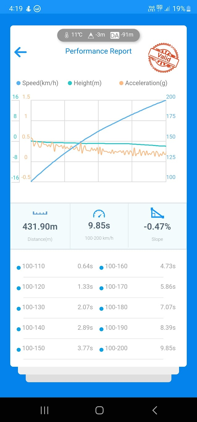

Tried 4 different maps, 3 of them from my local tuners, so on dyno the best result I had was 560hp, + sometimes boost deviation error (later I was said that its a tune soft fault, my car never had this errors on stock), my times were:
0-100 3,85 100-200 9.87 - measured with Dragy, can provide charts later
So... after that I went to FVD - and to be noted, the process is not over yet we do continue tuning and I dont know the result for today (will update topic once we try another file), but - with FVD tune which feels more proper and correct (local tuners said they cant do my car properly) - I still have EXACTLY the same 100-200 Times - 9.89, but the car feels much more powerful overall
went to check for vacuum leaks e.t.c - found a small one, fixed - still 9.89 100-200 doesnt change. I do all runs on the same road, same tyre pressure and +- same weather conditions (~+10c)
I dont understand - how can 4 different tuners and 4 different files - make the same result, what could be wrong?
Speaking of Turbochargers - I cant find A SINGLE VIDEO with Good Cayenne 958.2 turbo on stage... like literally nothing, from hundreds and thousands of videos i found with stage2 panameras 4.8 e.t.c - my turbo boost is exactly the same and is following:
- Sometimes in Comfort mode i see 1.2 bar. however when i do full throttle to measure 100-200 from 3rd gear - boost is followig, in sport plus it builds usually to 1.0 (sometimes 1.1 from different gear) then it slowly drops to 0.7/0.8 on ~6500rpm closer to gear change, then gear changes and it goes back to 1.0 then again 0.7/0.8 - gear change.
From acceleration times I compare to other (idk the owner) cayenne with less mods but 9.0 seconds 100-200, my car does 100-150 exactly the same, but after 160 - i lose 0.8 seconds
Can you guys share on your experience? And also what could be my problem? Stage 2 620+ hp CTT has to run 100-200 in 8.9 seconds, (x5m, gle63 and the rest of same gen do even low 8 like 8.1 e.t.c.) also I see a person in Dragy statistics with 2013 turbo s and 9.0 seconds as a proof - he has only downpipes and tune.
