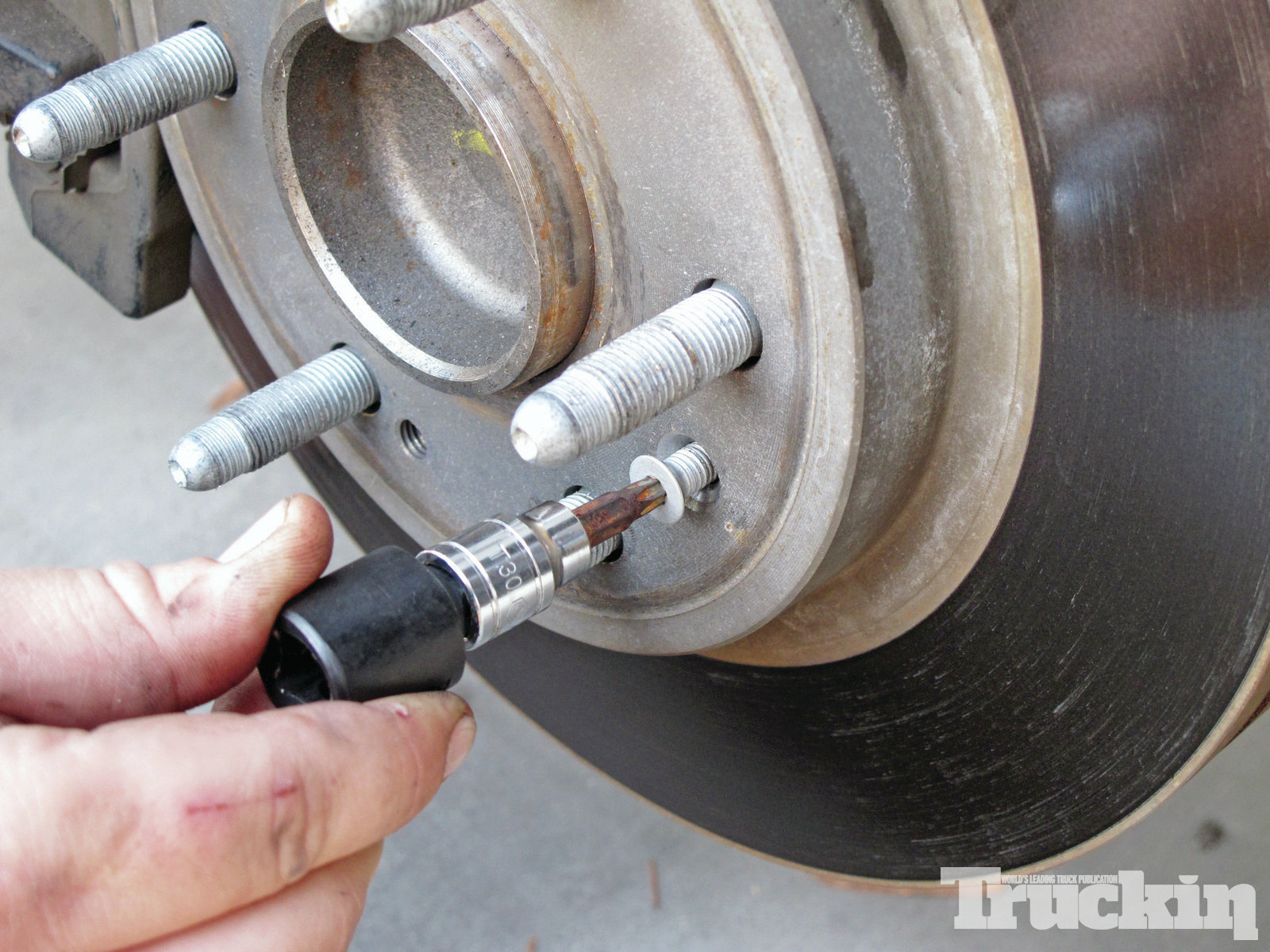

The rotor set screw is on there to make sure the rotor stays flush after the wheel hub. If the rotor set screw was not reinstalled or loose, it would cause the rotor to wobble on braking. Ask me how I know...
