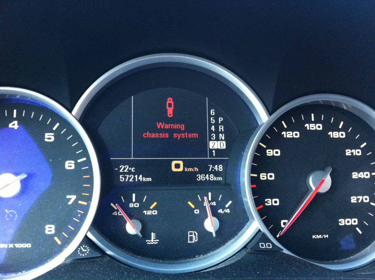

Today when I am driving, it has the warning showing on the screen, which is WARNING CHASSIS SYSTEM
Has anyone has the same experience? What will be the best way to check. What will be the cost to fix it?

Yes, I have seen it - it is from either your PDCC or air suspension. Given the cold temperature I am seeing on your cluster, it could be nothing at all to worry about; considering that your air compressor may have been just warming up.
First I would warm up the car, turn it off for 5 mins, then turn it back on to see if it goes away. If it does, then I would not worry about it unless it comes back.

Wow, that's cold! When I got that exact same warning, it ended up being PDCC. Replacing a slowly leaking valve block was covered under CPO, but parts and labor would have been $1000+ USD (dealer prices), by my estimate. Good luck!
