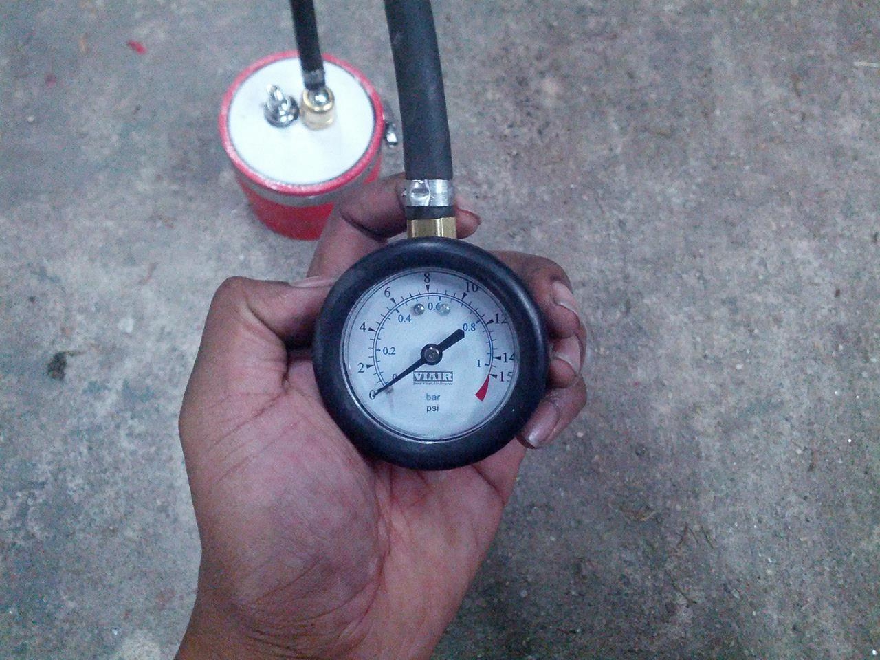

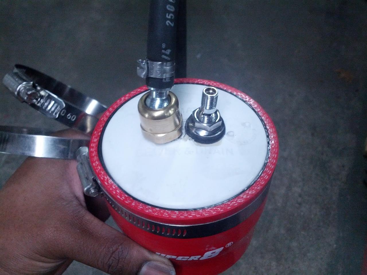

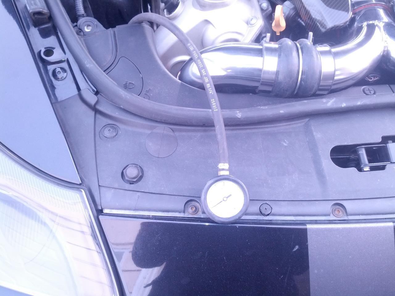

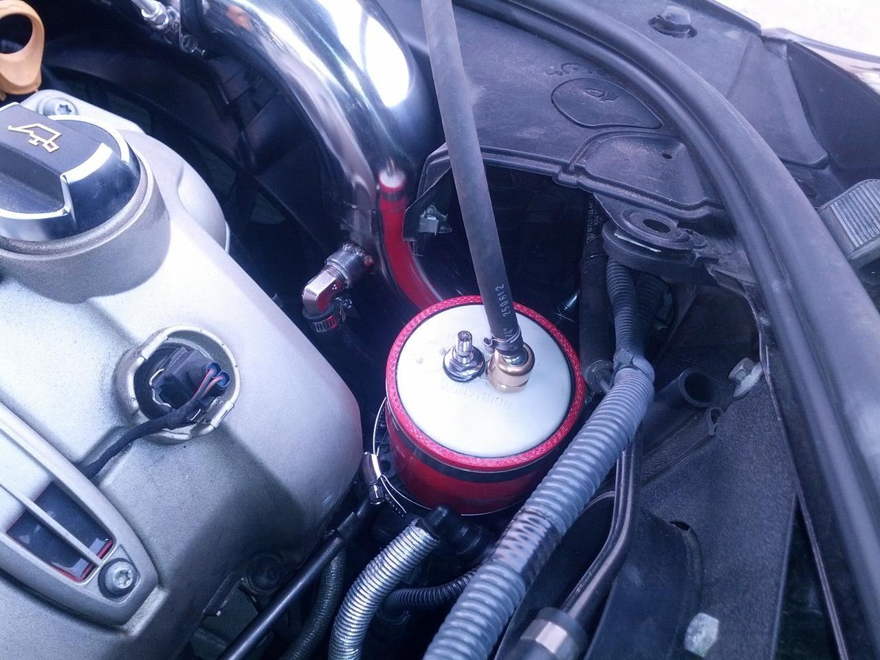

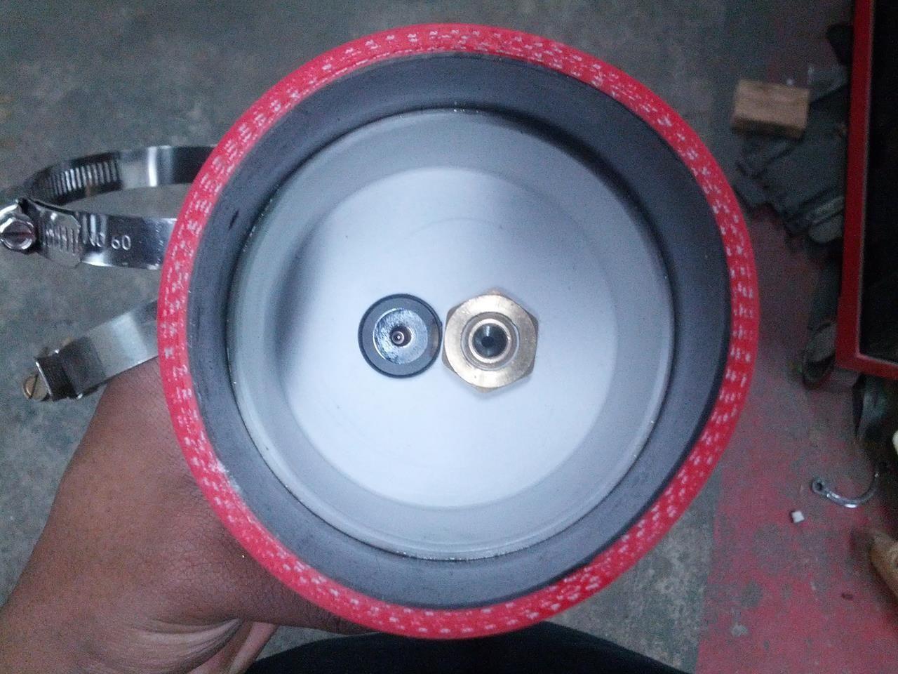

Last, I seem to be having issues not developing enough boost. I started making some test fittings but never really figured out where to hook it all up. Does anyone have some pics of how and where to hook them up?
Yes, I made a boost leak tester when I made my larger y-pipe plenum. There are a few pics on that thread that shows it hooked up to both MAF housings. I will find the pics and post them here.
Here you go...

I'll see what i can come up with for the boost leak tester. It sure either isn't holding or not getting up there for some reason. It just seems to me like it's leaking because it will initially run right up to peg the needle but then pretty quickly falls back down below .8bar.
