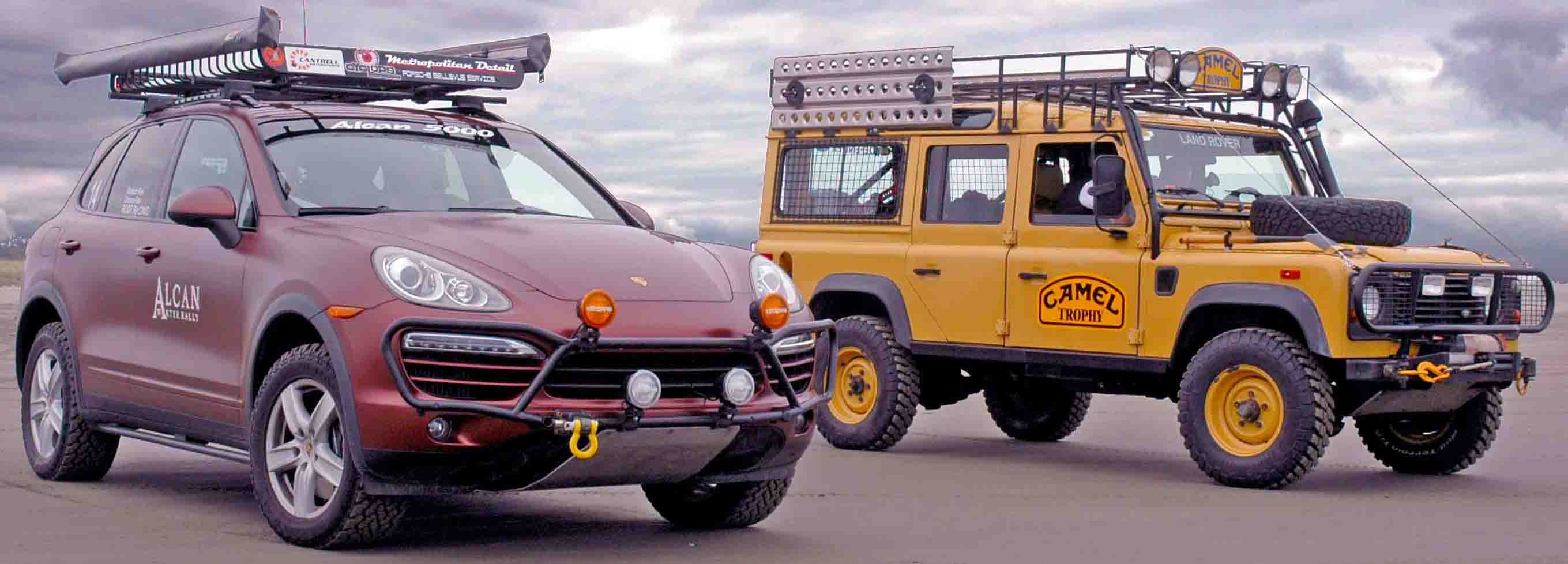

We are going to upgrade from Thulee & Yakimaa roof racks as they are more appropriate for taking the bicycles to the park and skis to the slope. We need something more robust for what we do. Looking into something like a Gobi Stealth Rack or the Rhino Rack Backbone.
To see more 'Otis' and what we do, copy link location below & paste
http://rennlist.com/forums/porsche-cayenne-forum/968788-meet-otis.html

Otis rocks. I see you have the Thule bar on the factory rails. I don't know how you'd tie in a Gobi. The advantage to the Rhino seems to be the multiple points of attachment, spreading the load. You might accomplish the same with using 4 of the Thule racks. That's what I did when carrying three kayaks and a canoe. Interested in seeing your final solution.
