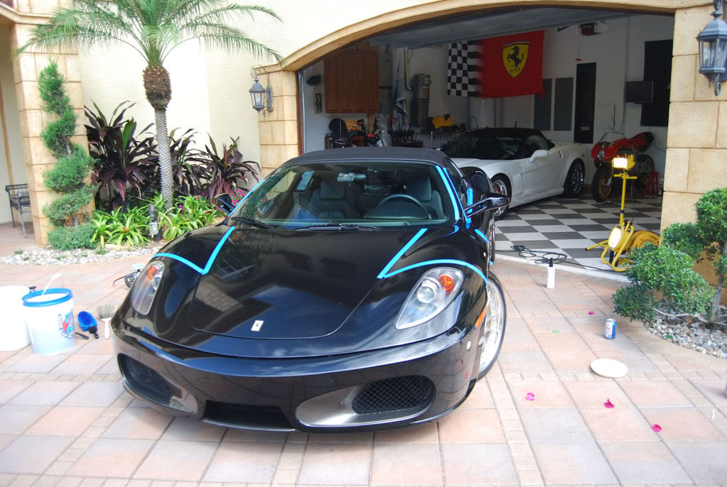

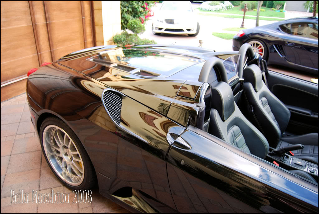

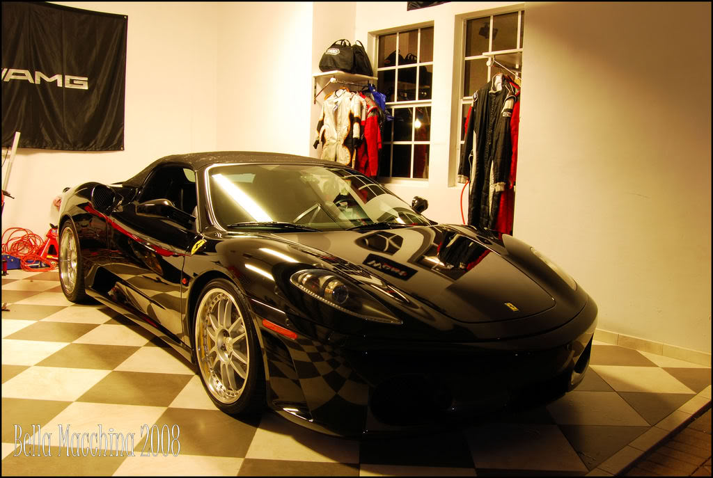

Wow dude, that's GREAT that you are having so much success. As you know, I never hold back product information and really dedicate much of my time to trying to help out as many detailers as I can. (Sometimes I end up helping the competition but that is another story :P). M105 is really an amazing product and I'm shocked (because it is Meguiars, which isn't boutique) at how well it works.
M105 works awesome on new Ferrari's. Brian and I did an F430 a couple days ago (one that had been polished perviously but was torn up from the track) and used M105 on a LC White Pad to remove 90 percent of the defects, and leave a *near* LSP ready finish. In hindsight, I would have probably skipped the white pad and gone started with a purple wool pad to keep the heat down and grab a little more cut. Even with purple wool and a compound, you can finish with a blue/grey LC pad (or Meg's Solo Finishing or standard finishing) and a final polish and be near flawless. Nothing cuts faster, cleaner, and leaves a better finish behind (realitive) IME.
Here are a couple pictures from the F430...
Sorry for the overexposure in the first picture, I take all my photos in manual mode and I should have dialed in more apeture..

Still get goosebumps looking at that thing, it's poetry in motion, and with this particular client, it's in hyper motion on the track.
