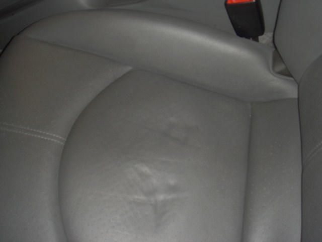

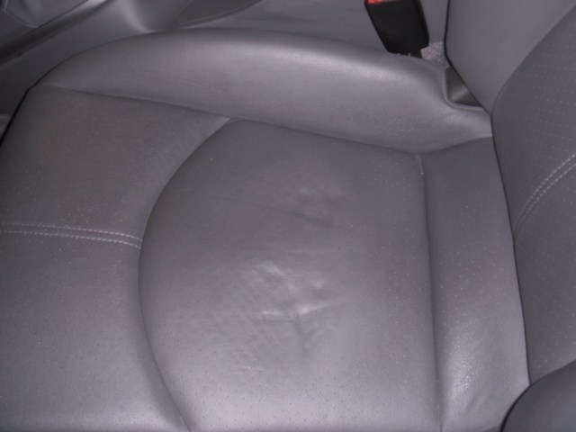

Hello
today I was at my seat for a long period of time and had some jeans with buttons on my pockets so my leather got all F#$#$ UP
is it posible to get the leather to stretch ? or at least not have the dips on it from my but and jeans?

Deformed leather surface – leather upholstery fibre structure will stretch in all directions with no particular grain or stress pattern. The urethane surface coating will not withstand multi directional stress, however, and when it’s flexed or stretched continuously in the same place the surface coating develops an indentation, car seats will often leave a ‘dent’ in the upholstery surface, however it is the foam that is deformed, more than the seats covering. The application of low pressure / vapour steam will help restore the shape, used in conjunction with hand pressure

thanks for the info, so maybe if I use my steamer..

Give it a few days....it might reform back to where it was.

Thanks Moe, I will leave it a lone, maybe I will put some microfibers and sit on it to make some nice light presure on it ..

You can try that. You can also leave it outside...the texas heat should help warm the leather and maybe reshape the seat back to where it was.

what about like a steamer, like the other member was saying I was thinking of that, but probably it would be mess to much with my leather..

I've never tried a steamer, so I couldn't give you an honest feedback. I know steaming is what the factory does to mold the leather around all the curves of seats and interior panels. In your case, it a few days and see what happens. The reason why I say that is because this isn't an area where something sat for months or years and the leather now has "memory" of the object and it won't reshape back to normal. If I'm not mistaken, your seat indentation is a result of one incident.

Yes you are right, it was only one time and because I was sweat... so I left the car outside its approx 84 degres so its not to hot, just to give it a try, thanks so much for your knowledge Moe...
