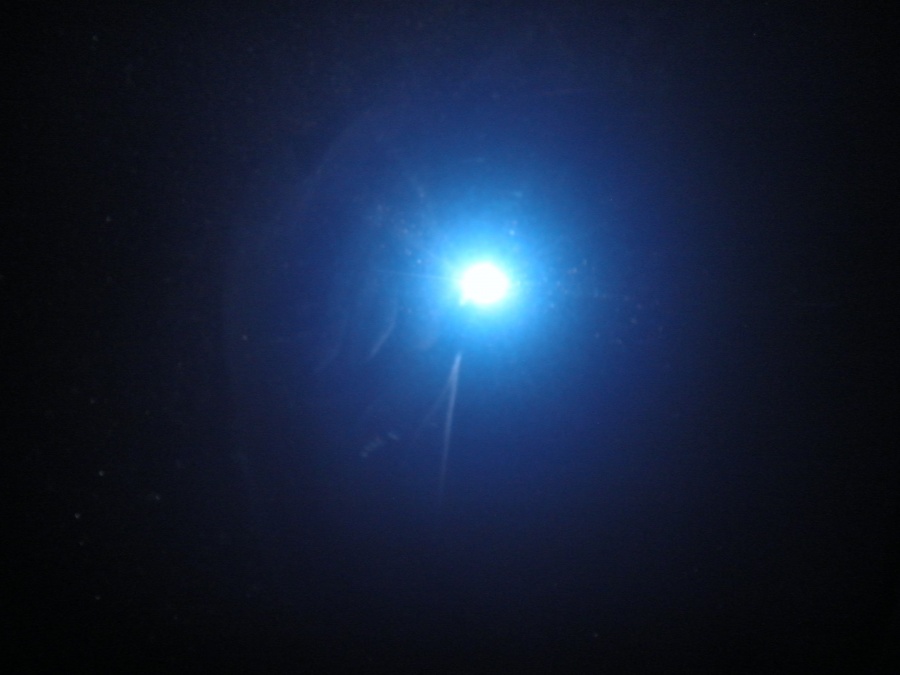

I wanted to get you advice regarding my Audi. I'm an amateur when it comes to paint care, and I wanted to know if you could recommend the correct products needed to fix my paint issues. I have a dark blue Audi S4 with swirls, scratches, and holograming. I was thinking about getting a Porter Cable DA orbiter with Lake Country pads. I was thinking of starting with orange and then work my way up from there. I really am not brand loyal when it comes to polishes, and I know they are all different depending on your needs. Is there a type you could recommend? What pads do I need and what polished to correct it all? Would the orbital polisher work, or do I need a high speed buffer? If high speed is the answer I'm going to punt for now and take it to a professional, which could be the right answer. I've attached some pics so you can see the situation. Any advice will help. My other option is taking it to Detail Werkz in Dallas, but for that cost I could buy what I need to do it myself. Thanks

Great pictures...it helps a lot.
That's typical stuff we usually see, so my answer is YES...you can fix it yourself. You shouldn't need a rotary and I'd highly recommend getting a FLEX polisher over the PC. Flex is a great tool that won't be obsolete any time soon and you'll keep it longer than you'll keep your cars. Your initial thoughts of using an Orange LC pad as a starting point is perfect. A lot of times, all you'll need is the orange pad with Menzerna SIP and a white pad with Menzerna Super Finish. Audi paint tends to be a bit harder than other manufacturers, so a yellow pad wouldn't be a bad idea either. Here's our signature flex kit that's the best-seller:
http://www.glisteningperfectionstore...sh-Kits/Detail
This kit has the polisher, pads, polish, and towels to get you started.
If you don't have any wax, then einszett Glanz and a red pad with the flex would be ideal. You can apply glanz by hand too if you like.
http://www.glisteningperfectionstore...00mL%2C/Detail
Hope this helps a bit. Let me know your thoughts.
