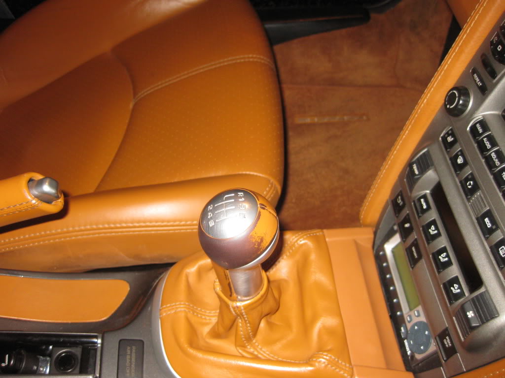

Shifter
Shifter - normal wear from use
Is there a way to restore this leather, or is replacing the only option?

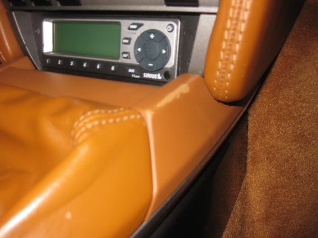

Plastic pieces
Console Panel near shifter
Can this be painted or repaired in some way? I did see it is available from Suncoast in leather, but it is over $400 for this little piece. If it must be replaced, is there a non-leather replacement available somewhere?
http://i218.photobucket.com/albums/c...n/IMG_1403.jpg

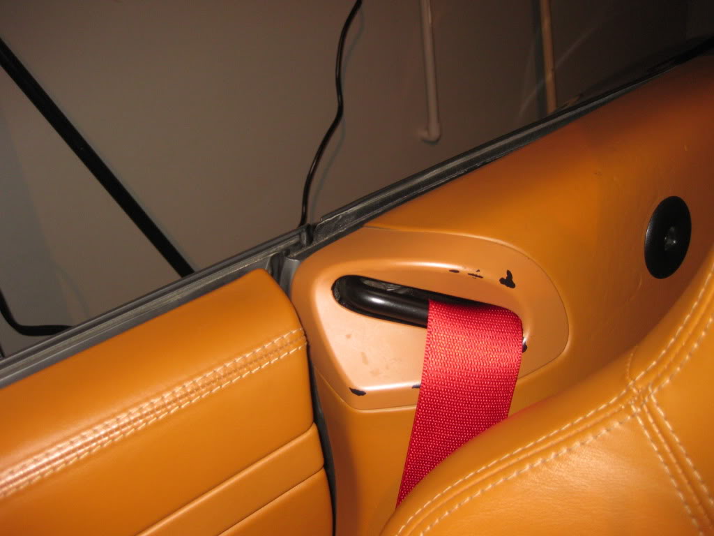

Rear Seat-Belt trim pieces
Same thing here.

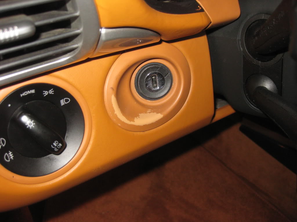

Ignition Surround
Same again.

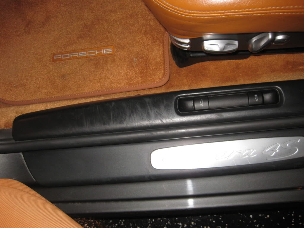

Door Threshold
Driver's Door Threshold
The previous owner was not very careful getting in and out. Any ideas on how to improve the appearance of this? If not, where to buy a new one?

The gear shift leathr would need replacement
“Leather Restoration / Renovation” - http://www.autopia.org/forum/autopia-detailing-wiki/139136-leather-restoration-renovation.html#post1479003

all of the parts besides the shifter are just plastic pieces coated with a rubbery material that is already the color of the interior, only way to correctly fix it is either have the parts wrapped with real leather or vinyl that dyed to match the rest of the interior, or you can sand down the whole piece till you get down to the plastic, and then spray paint the parts with a custom matched paint thats flat or satin in sheen. the kick trim surrounding the hood and trunk open switches can possibly be polished back to a uniform finish.
