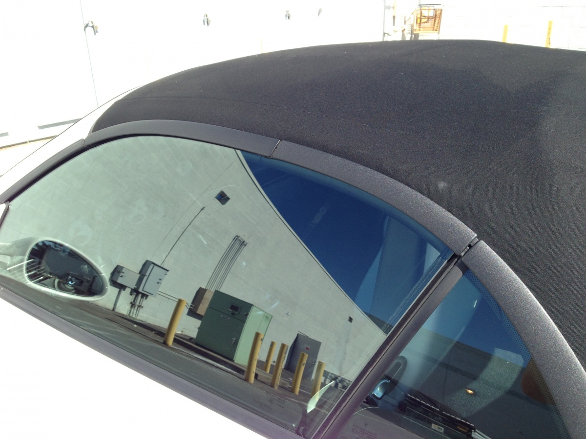

Just picked up my 2012 tts and noticed the top has a minor flaw as depicted. I'm not sure if something rubbed up against it or if its a dropping but it has a sticky feel to it. The only thing I've tried is plain water and rubbing it lightly with my finger.
I've ordered raggtop cleaner and protectant but wanted to see if anyone knows a way to fix it?

Sorry if pic quality isn't too good. Just have my i5 currently.

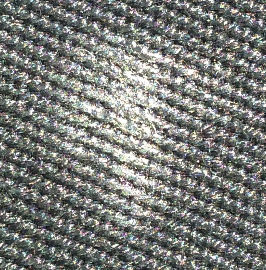

This is a common problem on all porsche cabs. It's rubbing from the fram of the cab top and there's some oil or grease underneath that is coming to the top. Porsche considers it a normal "wear" item. You may want to check with your dealer. Glad you finally found a 997 TT Cab...is it white?

Is mark on driver side basically near where b-pillar (if there were one) would intersect w/ roof? If so, I have a similar one on mine.
At first I suspected it was grease from a hinge-point underneath but turns out it's being caused by a break down/wearing of cloth [gaffers] tape wrapped around a harness in the layers of top (becomes exposed about 4" before top completely folds for storage). Haven't had a chance yet to re-wrap or secure in a way to prevent rubbing when storing top but looking into shortly and will let you know.
In the mean time (please note I have a light colored top: stone grey) I've had success cleaning the blemish (and re-cleaning when necessary) to about 98% by spot lifting w/ a rag soaked in denatured alcohol. Not recommending it to anyone but it was the least invasive method I found to work (soap, raggtop cleaner, etc. were all ineffective). YMMV so make certain you test for colorfastness in an inconspicuous spot before hitting a visible area.

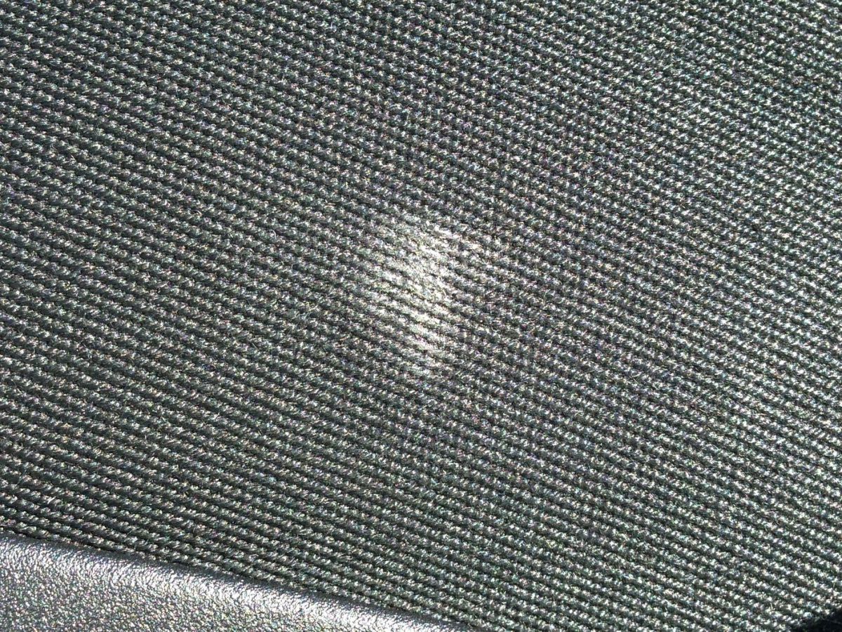

Moe
Please see attached pic but it sounds like what Berg is referring too. This is my first P cab so am quite surprise it's the Norm for a p car and isn't covered under warranty. I really thought something rubbed against it during transport but guess not.
Thanks again for the info and yes it's a white cab

Another pic

Originally Posted by C4SxM5
Moe
Yup...perfectly common on the porsche cabs. I think it's a design flaw and should be addressed, hopefully done so on 991. Best you can do is manage it. We like to clean the top with 303 conv top cleaner and protect it with 303 fab guard. You may also have good luck using the renovo dye.

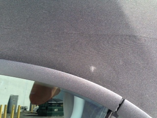

Just found this thread. I recently bought a 2009 C2S, and have a white spot above the driver side B-pillar exactly as shown in the photos posted by C4SxM5. I also have the exact same symptoms - the spot becomes soft and oozy after sitting in the sun. I've been able to spot clean with Raggtopp cleaner, but the problem comes back and I'm concerned that I'm going to damage the top if I keep working it.
If this is coming up through the top due to a poorly wrapped wiring harness, it is a relief, as I should be able to address the underlying problem and then fix the cosmetic damage. I have a well known Porsche top/interior shop near me (Autos International), and I'm going to have them take a look at this. I'll report back on what I find.
