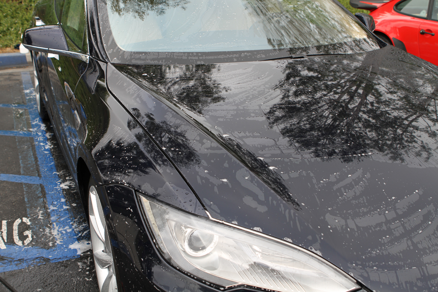

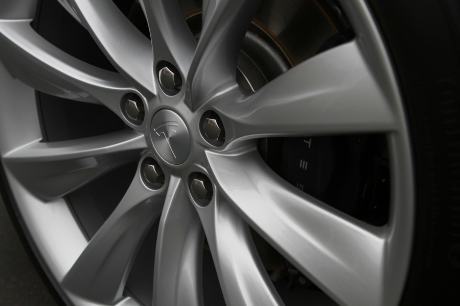

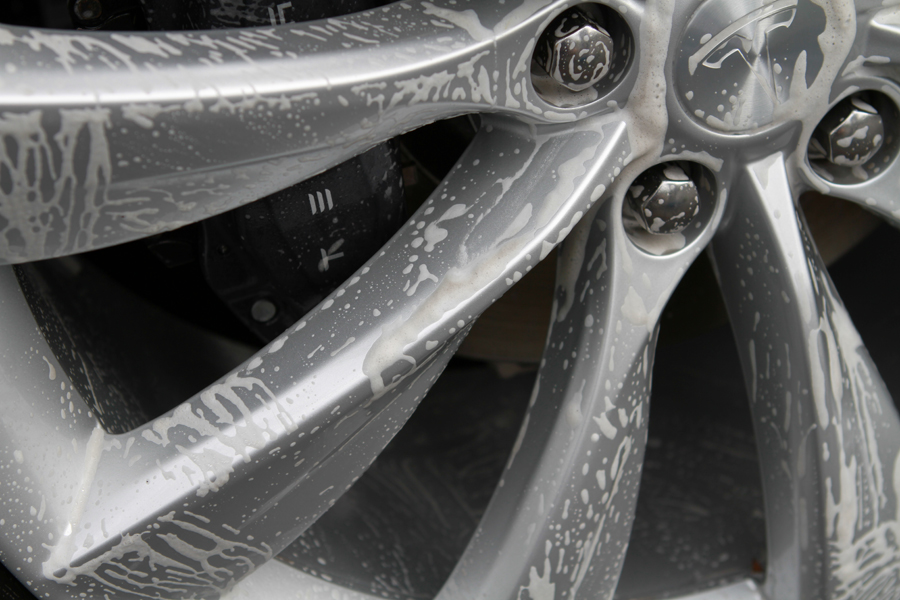

Initial wheel cleaning using all-natural wheel cleaner and a unique polishing soap

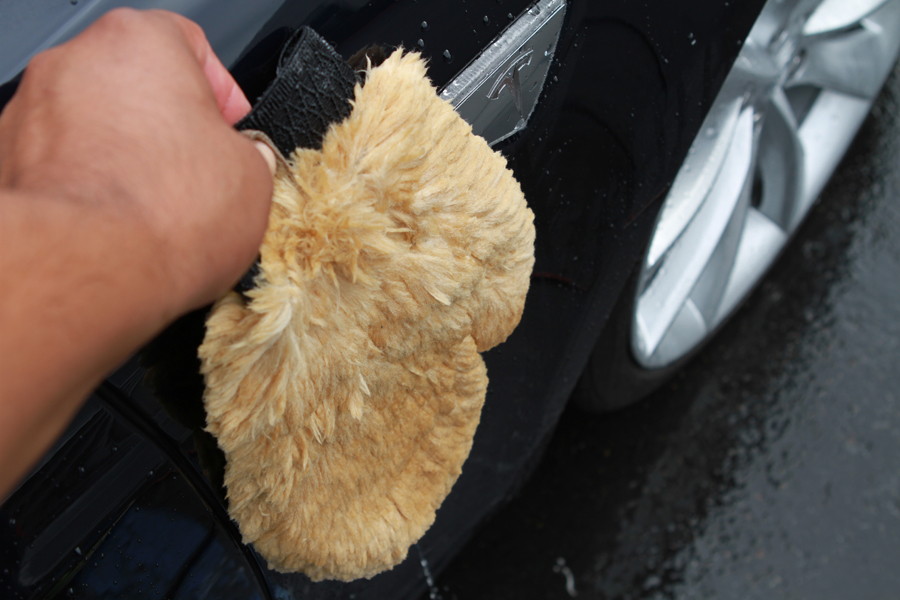

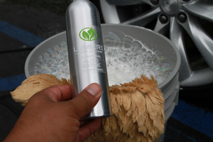

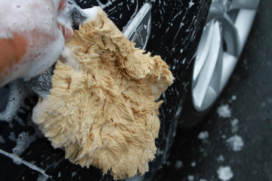

Wash using all-natural soap and genuine Australian lambs wool wash mitt
Wash mitt and panel rinsed after cleaning each panel. This way, we don't put a dirty wash mitt back in our clean soap bucket

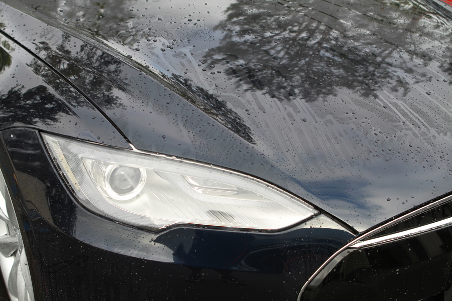

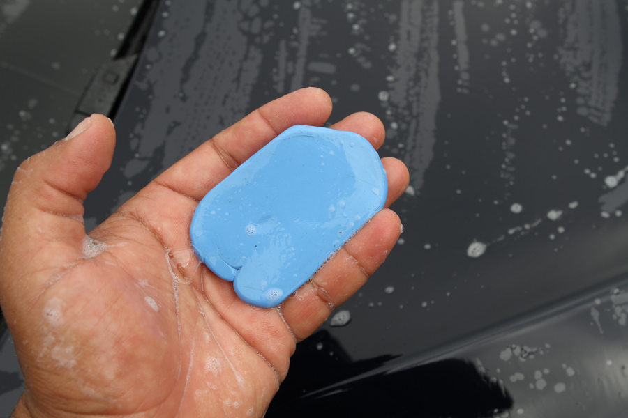

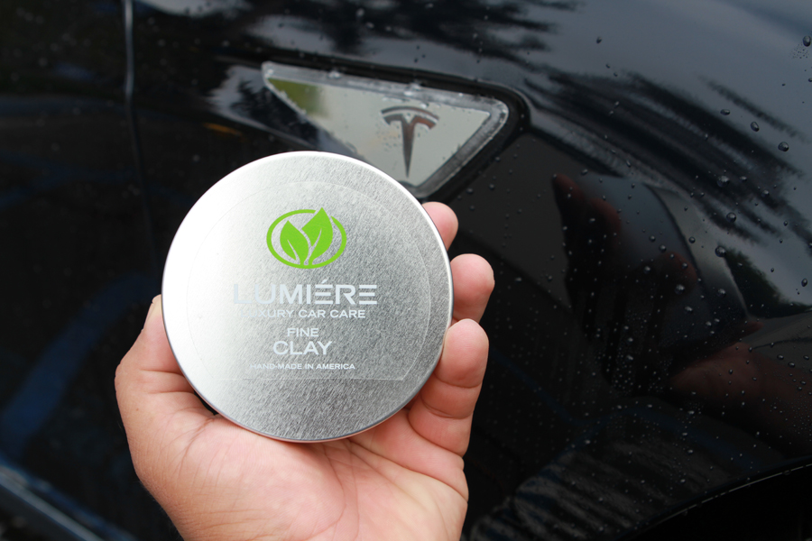

Decontaminate paint and glass surfaces

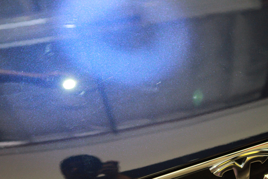

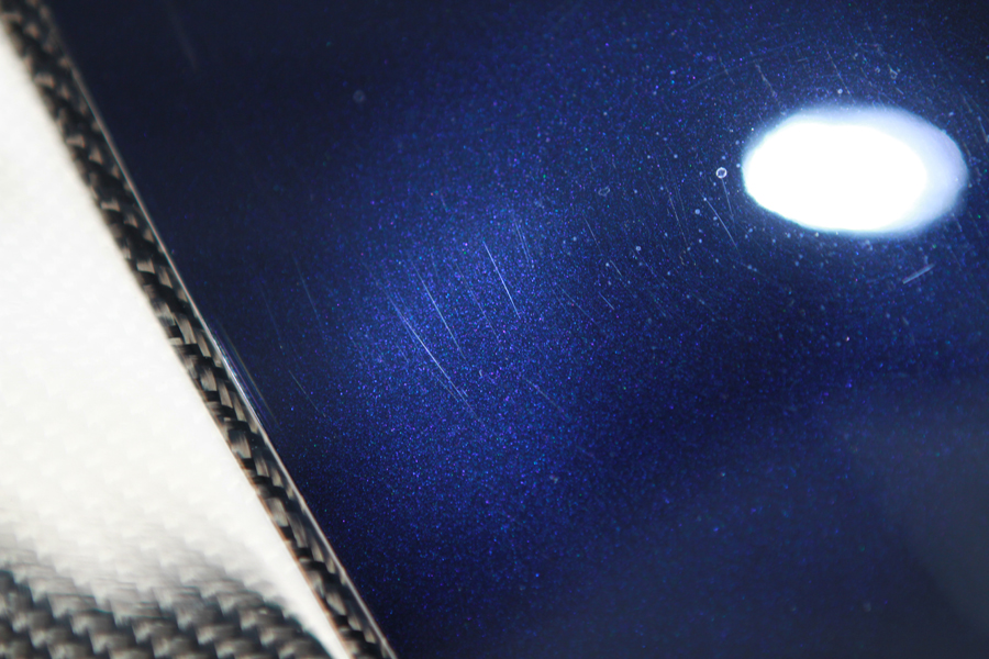

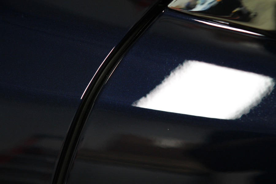

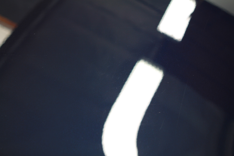

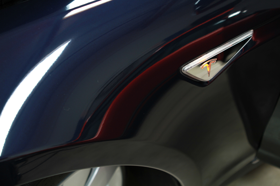

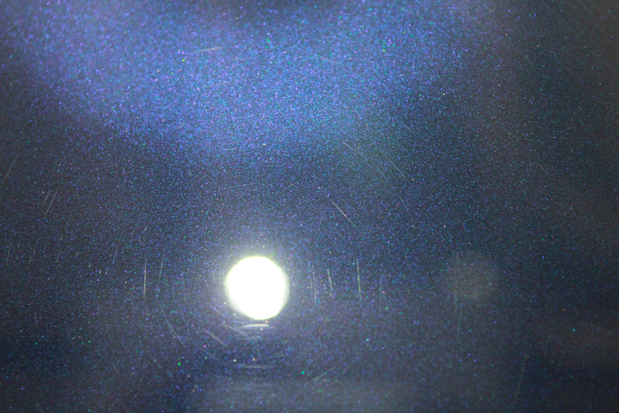

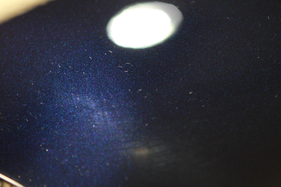

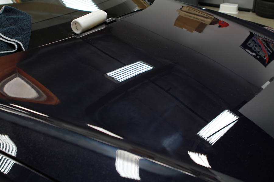

Paint assessed for condition. As you can see, quite a few swirls and scratches

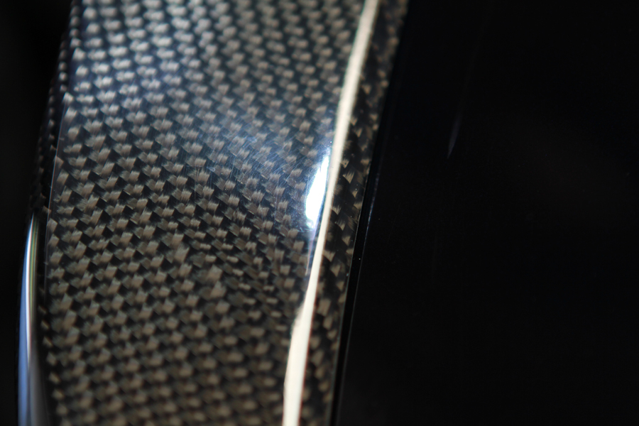

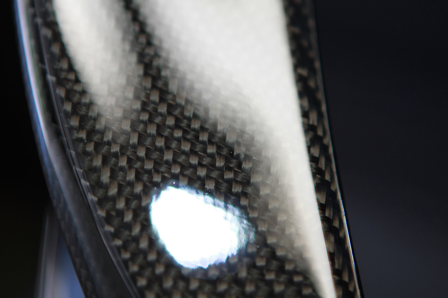

Carbon fiber not properly polished to remove sanding marks

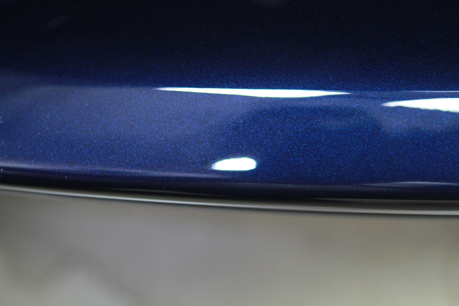

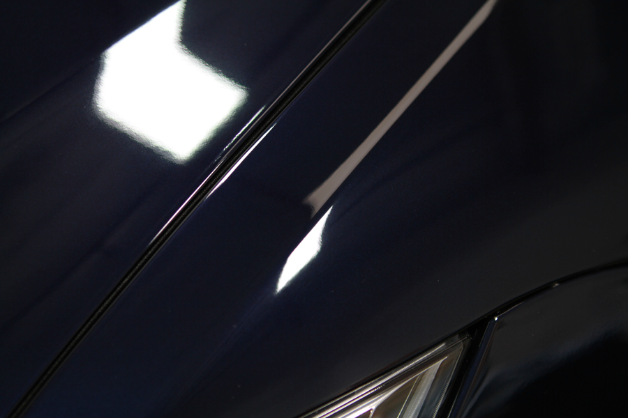

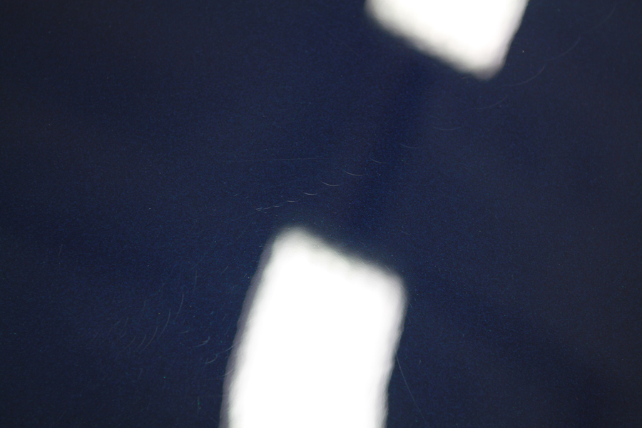

Paint properly polished and corrected

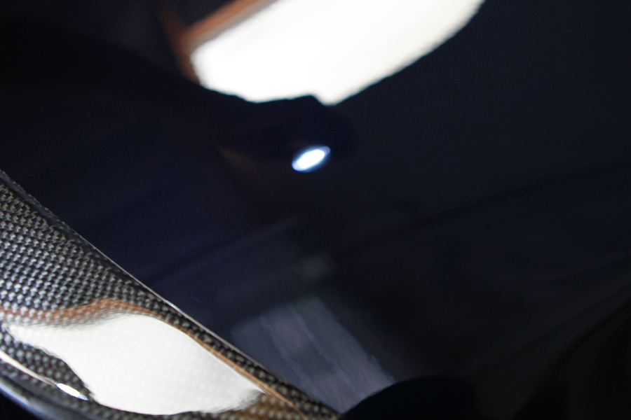

Carbon polished and corrected. As you can see, the clarity of the weave comes through and there's a nice gloss that wasn't evident before

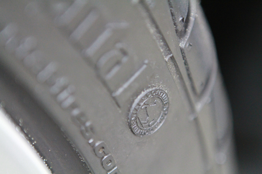

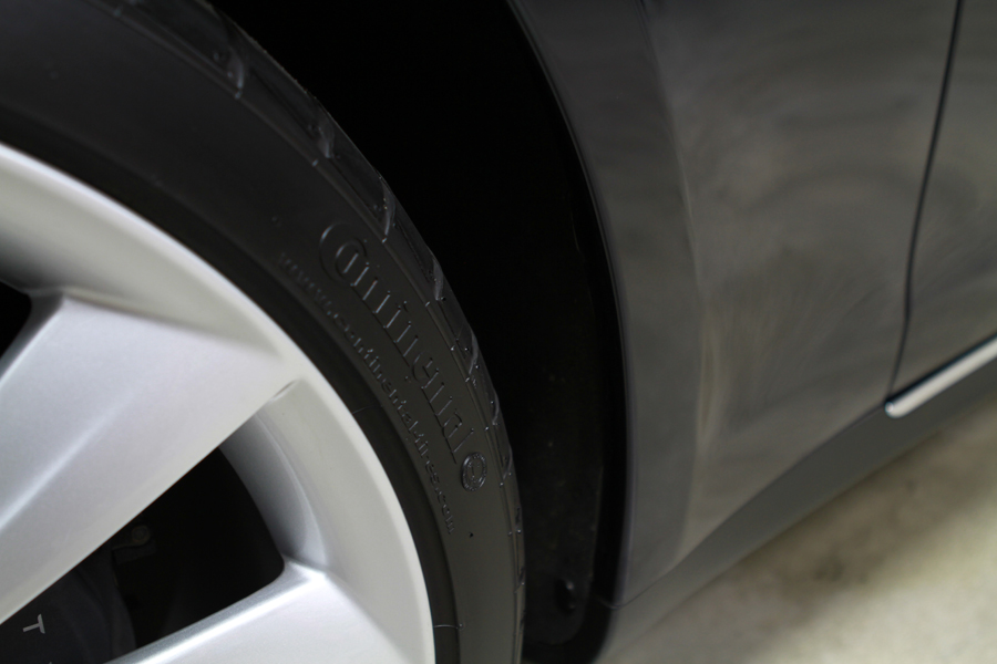

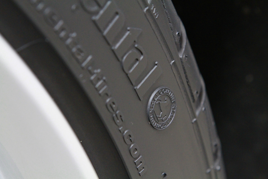

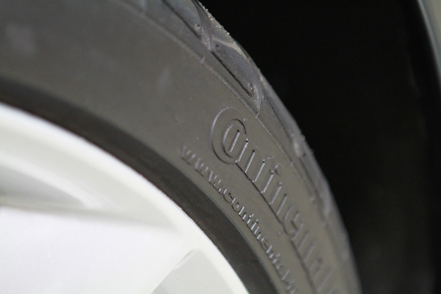

Old tire dressing removed
Notice the clean look using a proper tire conditioner. Notice the definition in the lettering of tire. It no longer has the messy goop from previous application

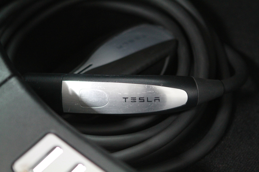

Charging cord cleaned and conditioned

Wheels waxed

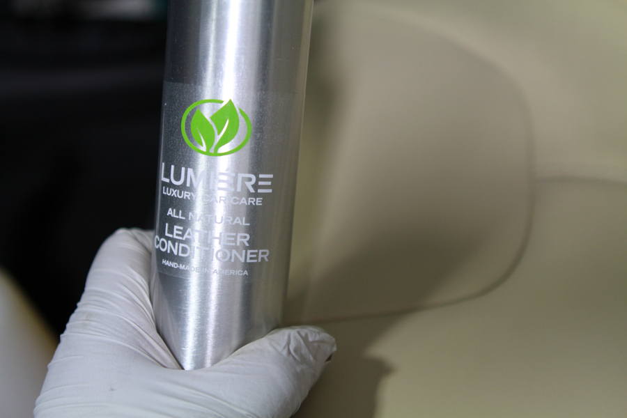

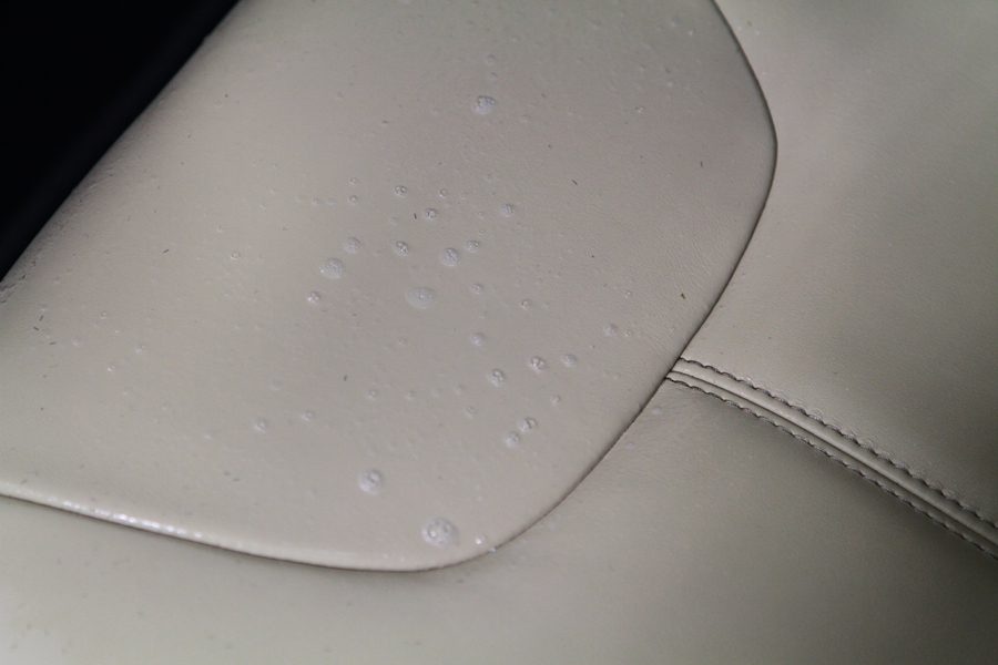

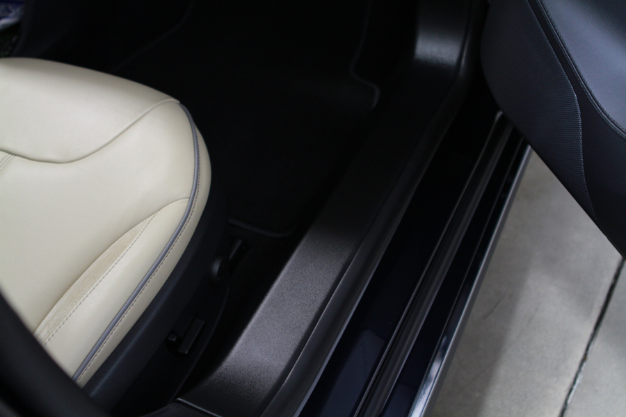

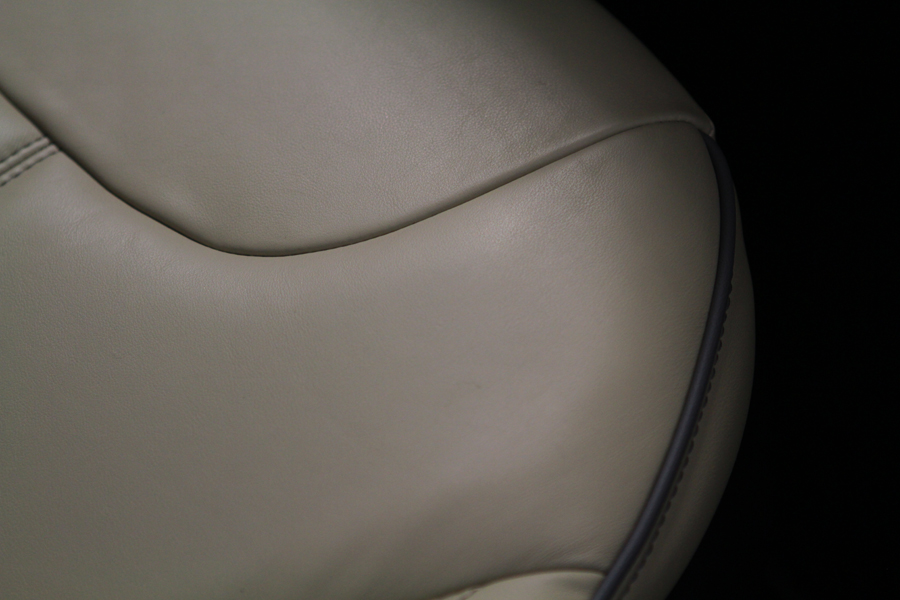

Interior vacuumed and leather cleaned using all natural leather cleaner

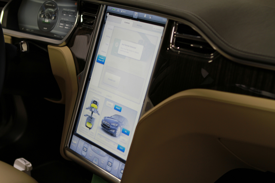

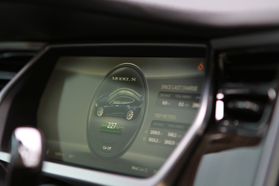

Main screen cleaned using an all-natural glass cleaner

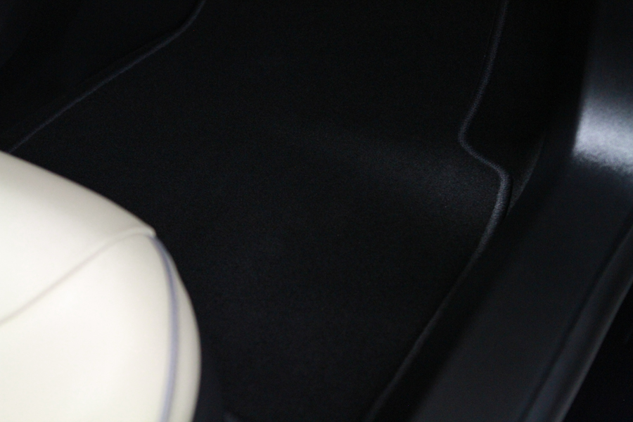

Carpets cleaned

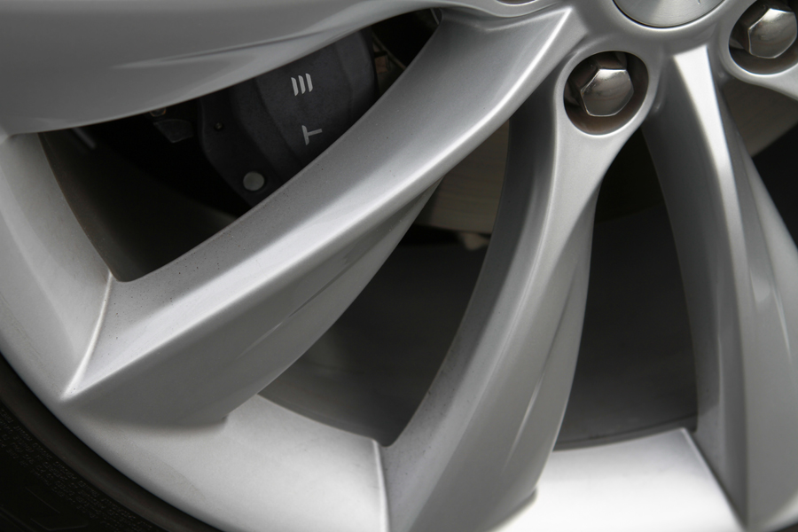

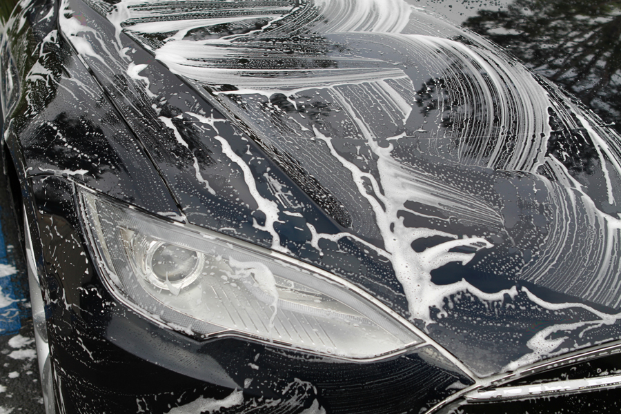

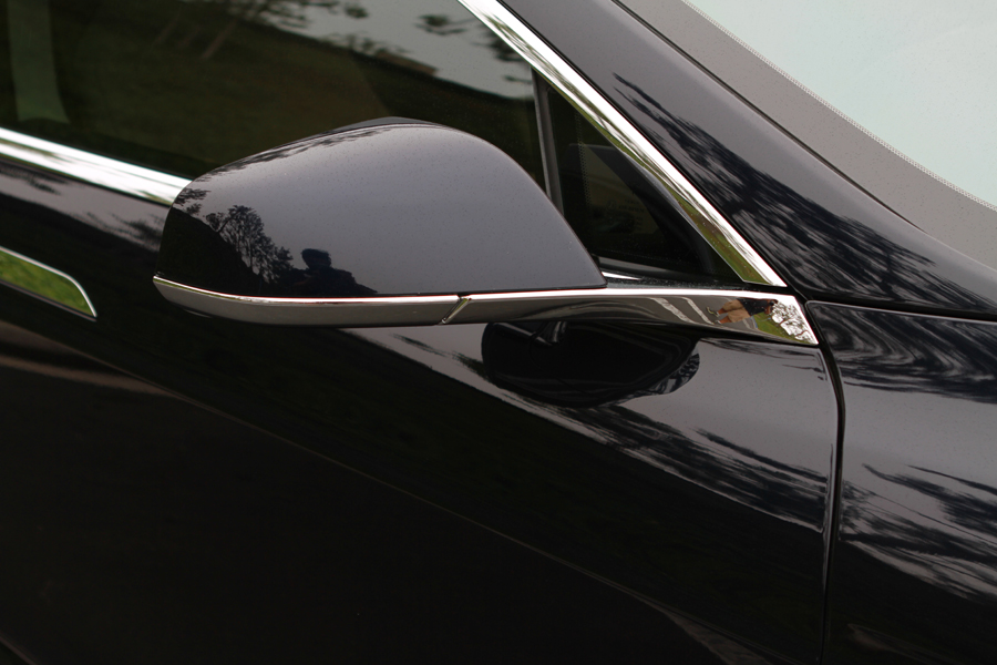

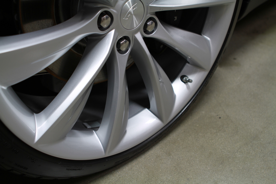

Wheels waxed

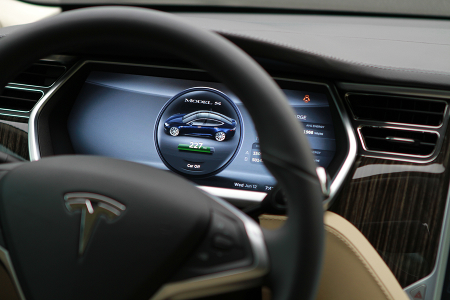

Carpets cleaned

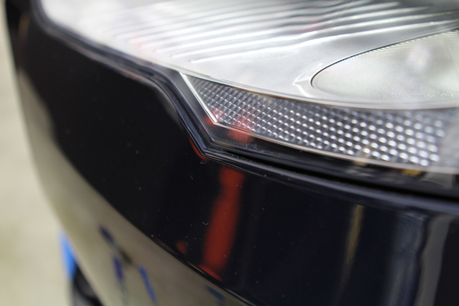

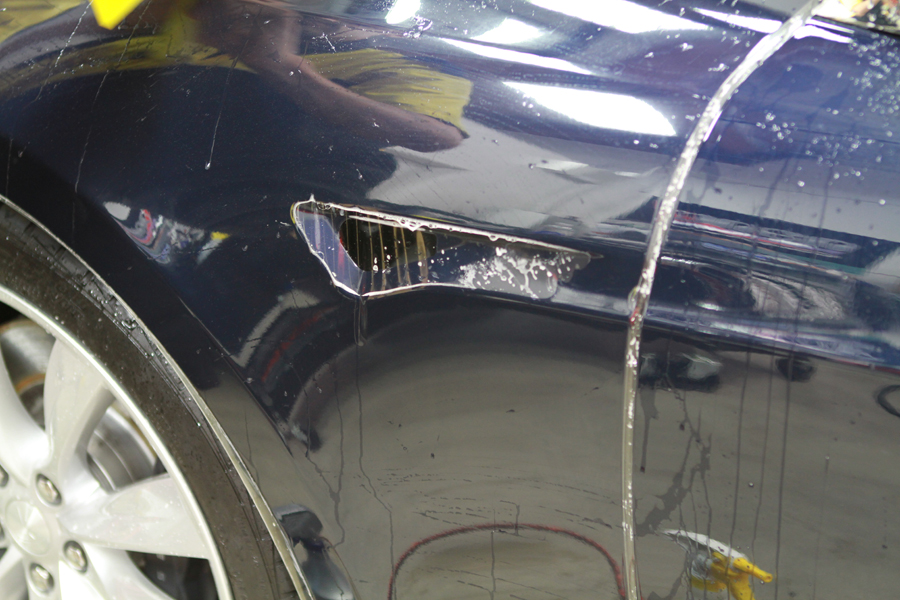

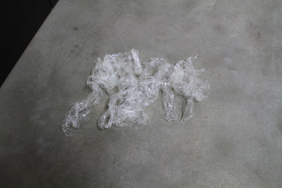

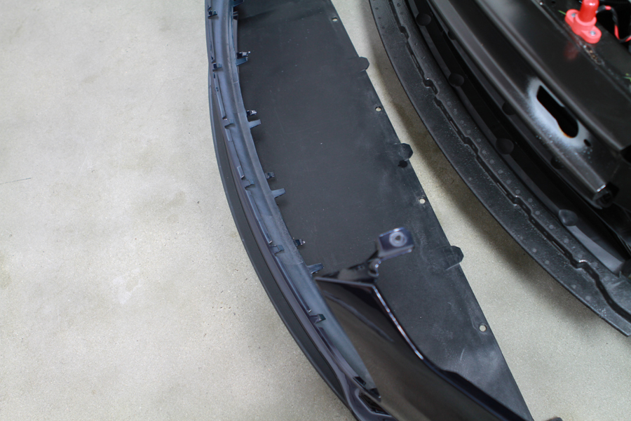

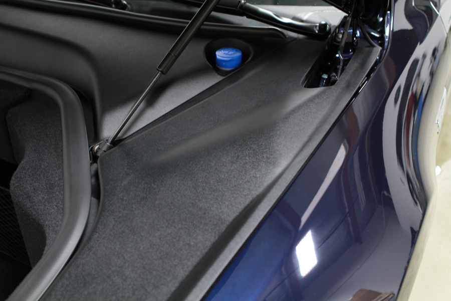

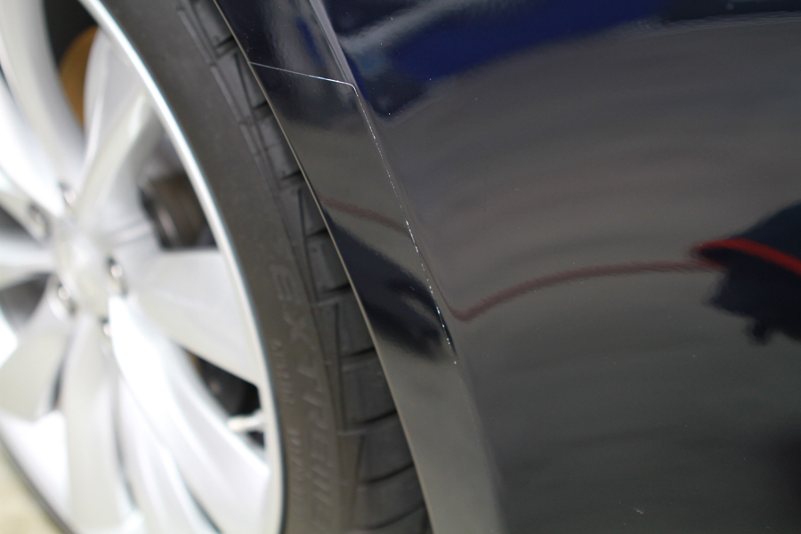

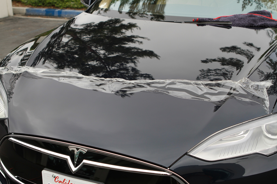

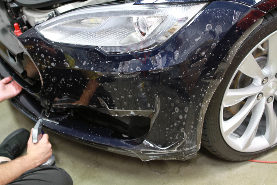

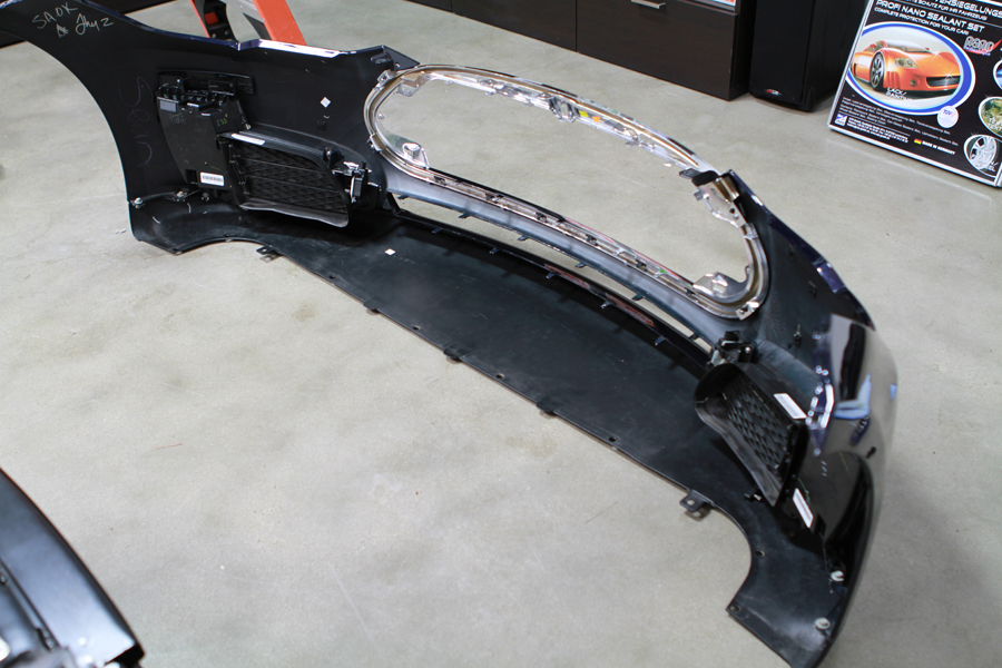

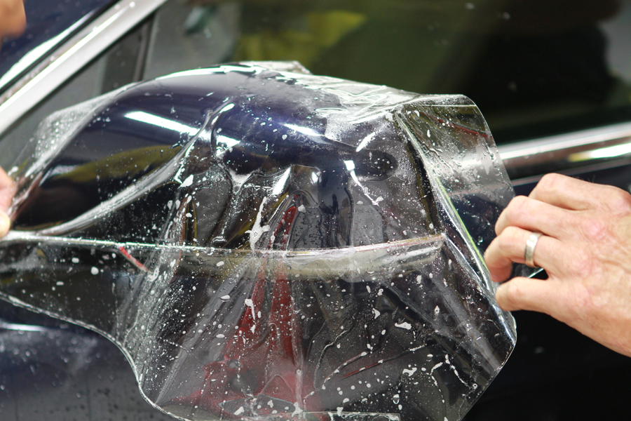

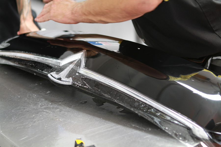

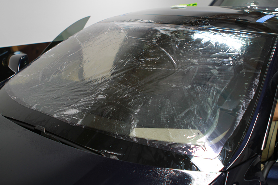

Old film carefully removed. This can take some time as we go very slow. There's always a slight risk of removing the paint while taking off the old clear film

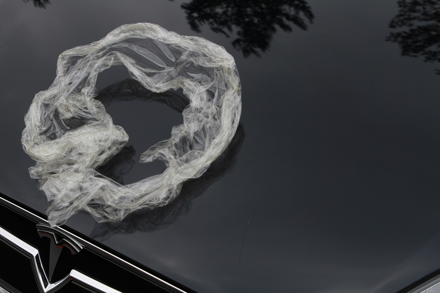

Old film. Lots of relief cuts and exposed edges

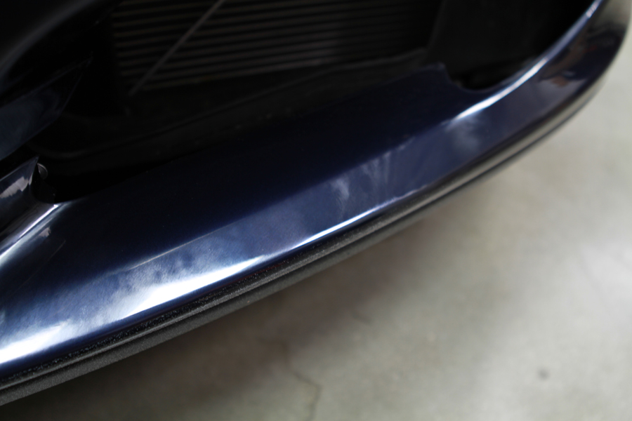

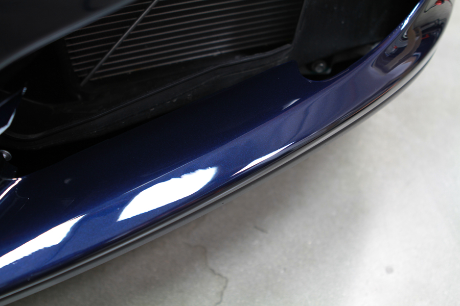

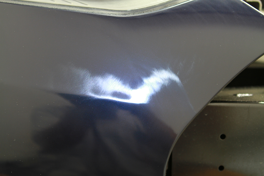

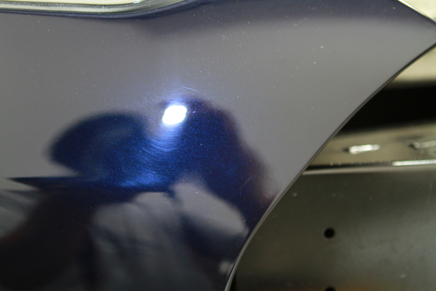

Once film is removed, you can see the scratches and sanding marks in the clear coat

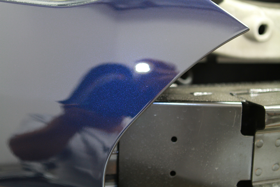

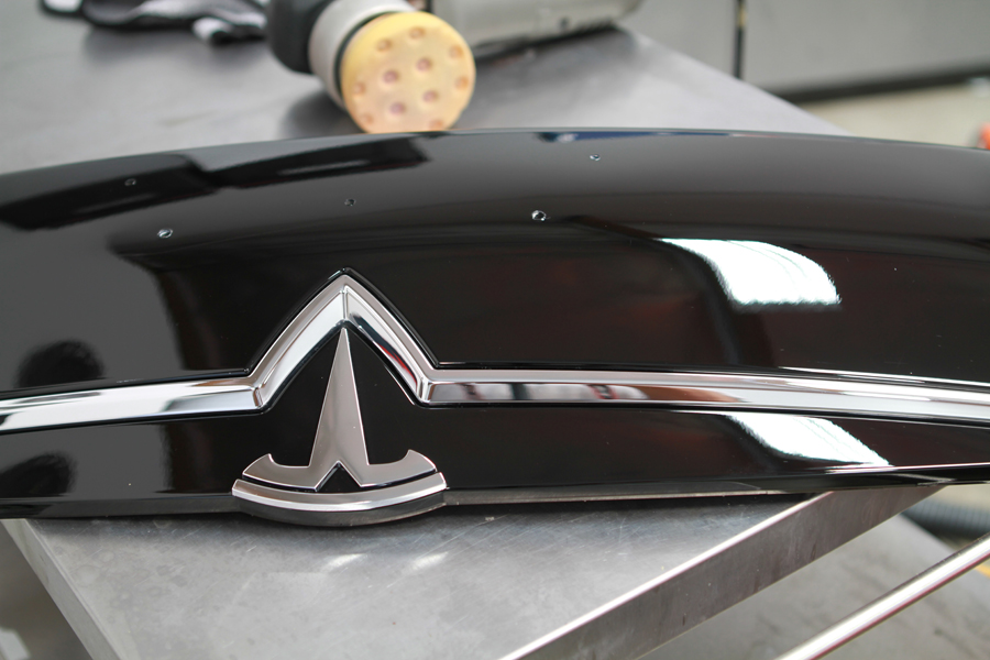

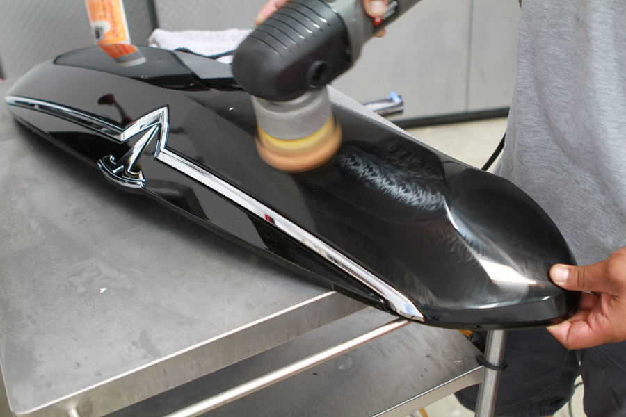

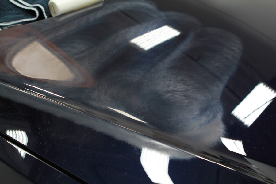

Polishing in process. This step is crucial and takes great skill. You want to remove just enough clear coat to safely remove imperfections, but not too much to hinder the UV protection of clear coat. Years of experience. This is an art form to us at GP

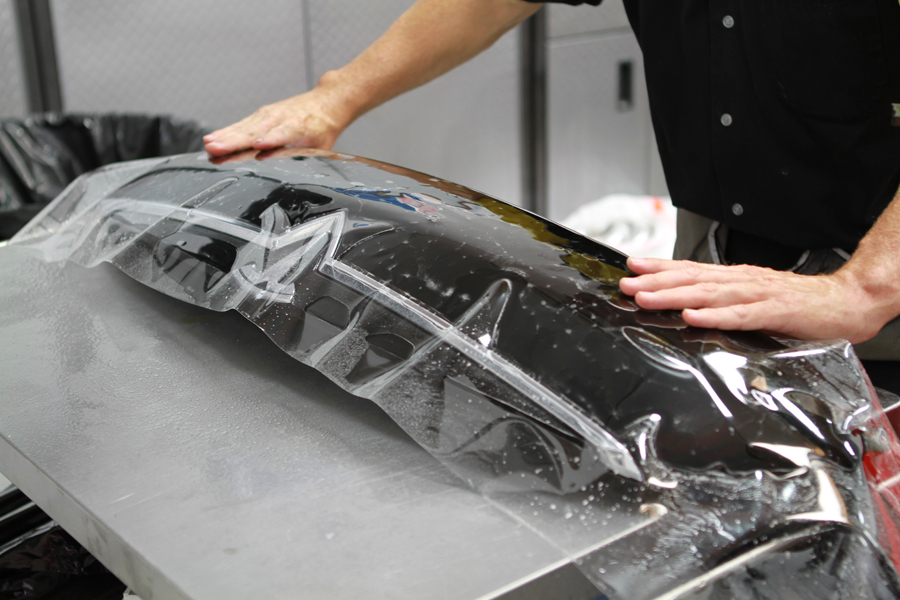

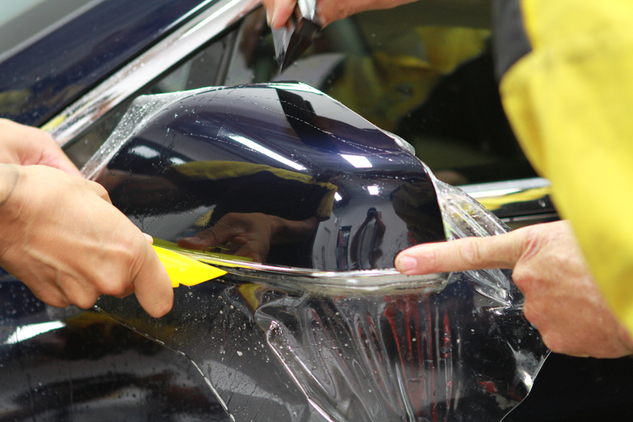

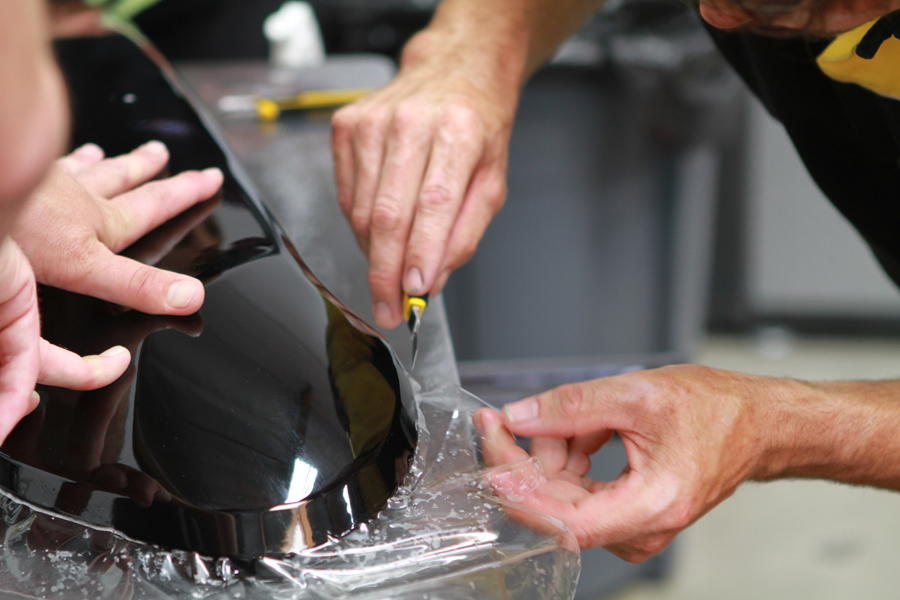

Most installation is done using bulk film. We simply lay down a sheet of clear film, and cut by hand. This assures maximum coverage and few visible lines

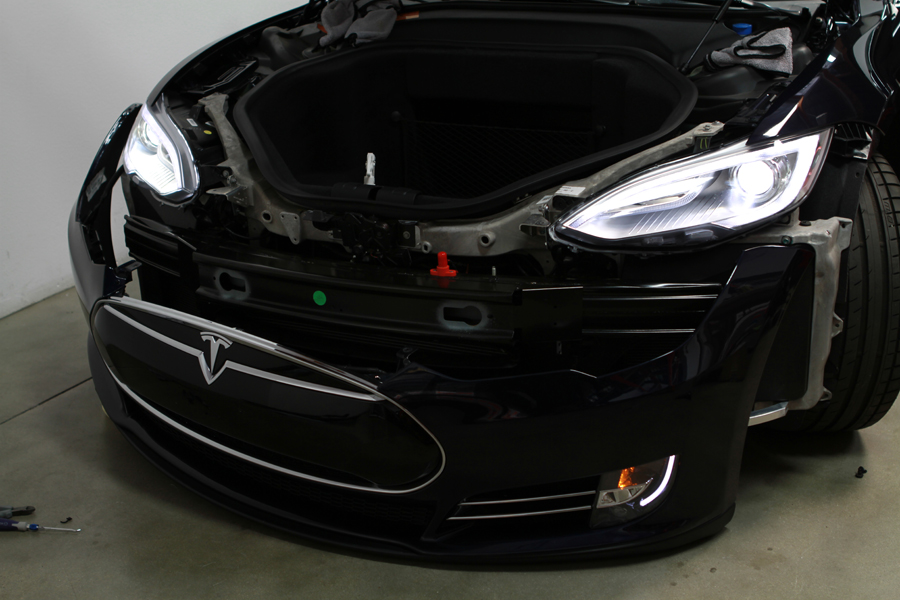

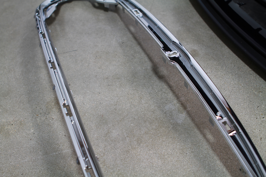

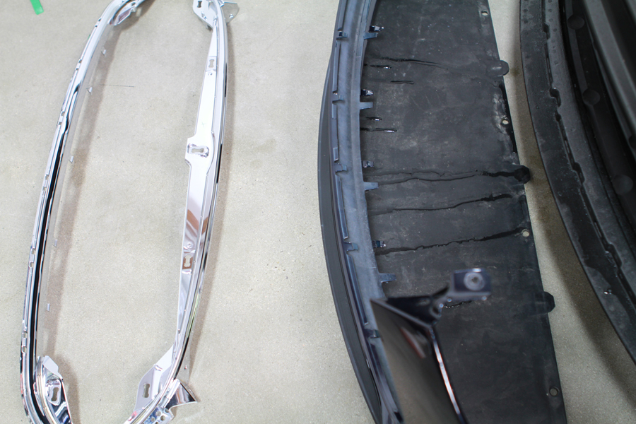

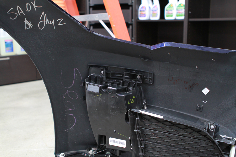

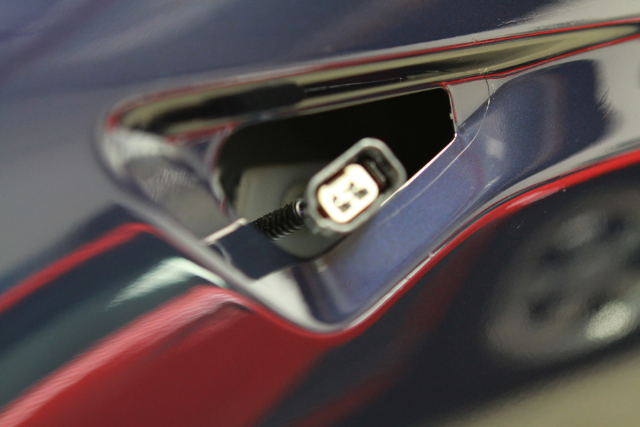

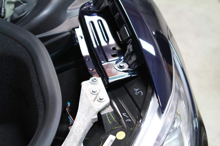

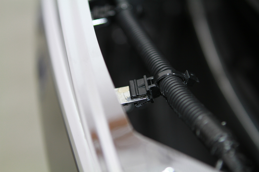

To do a clean install, we take many hours removing as much obstructions as possible. This requires great mechanical skills and knowledge of the vehicle. Last thing you want is spare parts
Initial quality test to make sure everything is returned to working condition prior to re-assembly
All clips returned to original position in original manner

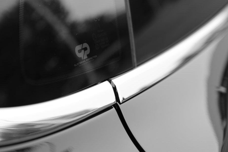

Final result. A clean and seamless installation
It's like nothing ever happened

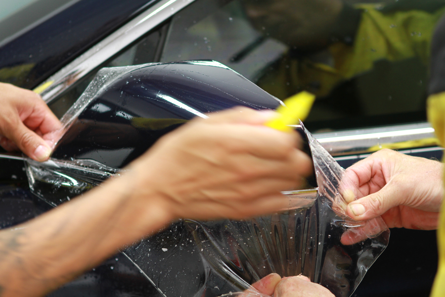

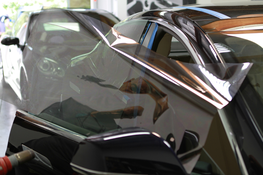

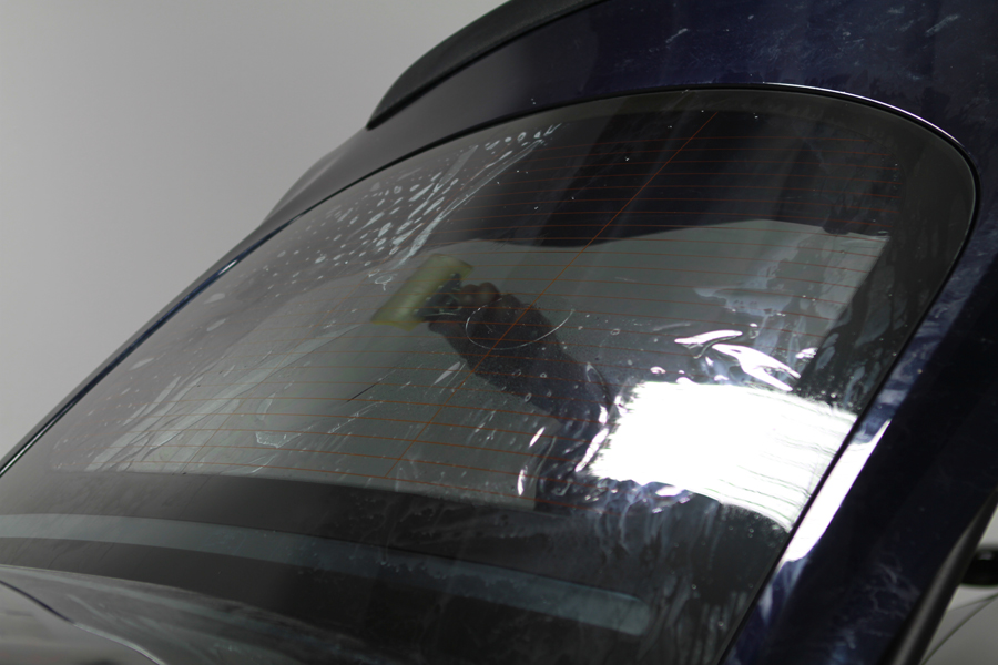

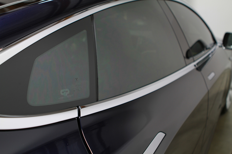

Huper Optik is a very unique nano ceramic film from Germany. This technology is arguably the most cutting-edge and the durability of this film is unmatched. The benefits of Huper Optik are unmatched heat rejection and attaining maximum performance while using the lightest shade of film. Most our clients do not care for a "limo" look. So this product can offer a clean and OEM "look" while offering excellent performance
Film is hand cut and no digital cutters are used. This allows the installer to cover and customize the maximum coverage on each glass surface. Years of experience and only a few skilled installers are able to work with Huper Optik

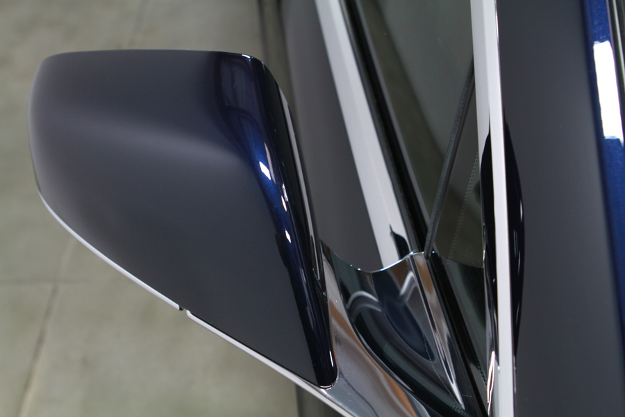

Film is hand-contoured to the shape of glass
