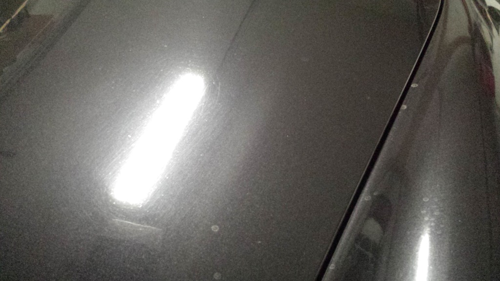

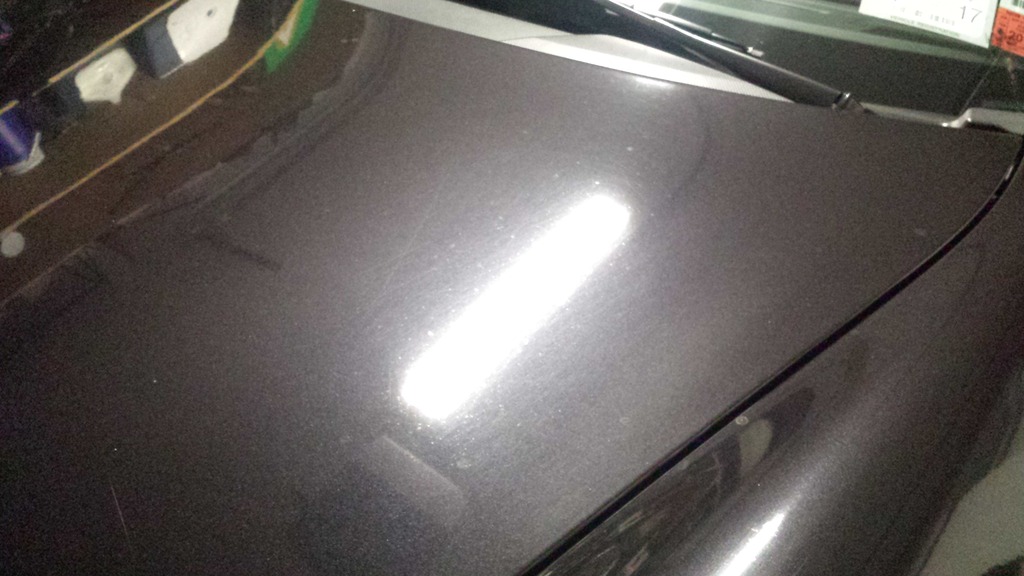

Did get a chance to take a couple of pics:

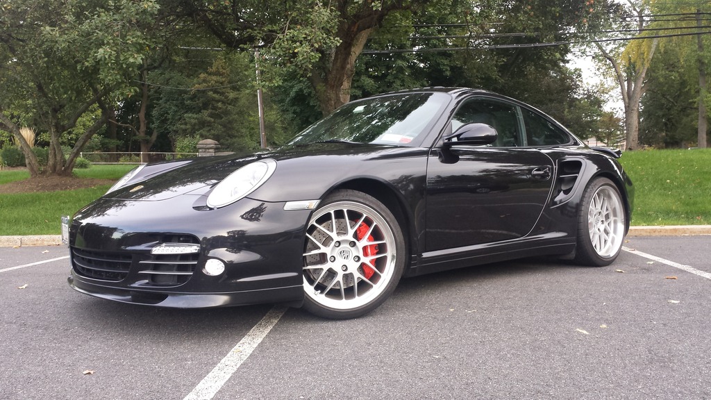

Lest one thing the car doesn't look that good, it doesn't look quite as bad as one might think:
