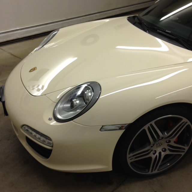

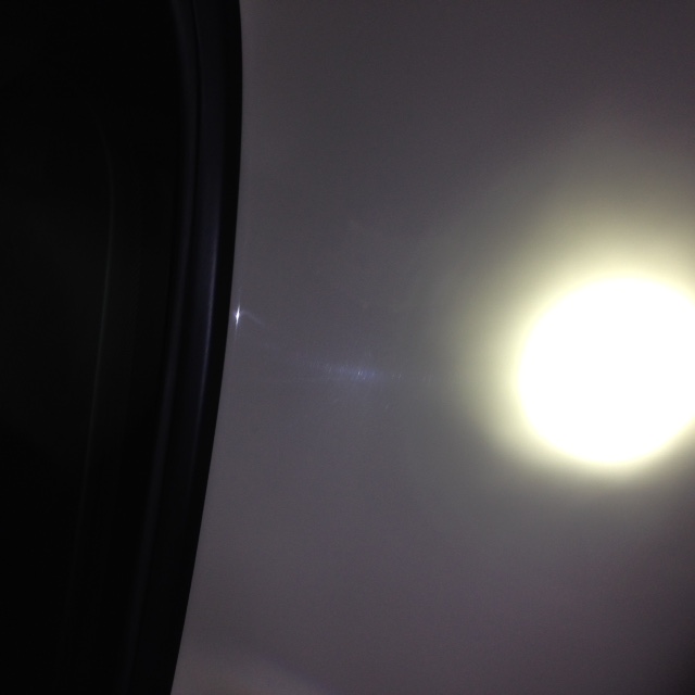

Let me start by saying the more I detail and re search the more OCD I get . I compounded, polished and waxed and the car looks great IMO, BUT the second pic shows LED light on car in the dark. The first and third pic just shows that it looks good in natural light conditions. The second pic show the very minor little marks I am referring to. I am going to seal it so I want to rid those little marks if possible. Those marks do not show under any other conditions including sunlight. I plan on using what I used the first time, Porter Cable. I have a few different color pads. I used two Pinnicle products the first time. I just ordered REFLECTS fine polish and plan to use that before sealing(Cquartz UK). Any input please? Thanks.

Those are swirl marks/light scratches. LED lights are unforgiving! They show everything! I went from my regular detailing lights to LED's last year and geez! They show defects in the paint so well! They can drive you crazy.
What I would suggest is to polish the car with a light polish and a polishing pad. Medium speed on the PC and this should take care of those minor swirl marks/scratches. Slow arm speed and multiple passes until they are removed.
Seal/coat her up and you will be good to go!
(some products that I have had good luck with on my 991: HD Polish, Menzerna SF4000, Meguiars M205) I know you will and can get a million different recommendations. This is just what has worked well on my Agate grey 991S.

Thanks, That s just about what I did. A dawn soap car wash, Reflect polish and Eraser wipe down. Will seal either late tonight or tomorrow. Thanks all!

2nd photo...at 9 o'clock...i cannot tell if you still have polish to wipe off or it hasn't been polished thoroughly as I see a slight haze and some microscratches. It would help to know exact polish/pad combo and the speed of PC and your arm movement speed as well.

all done. Microscratches came out well. Sealed with Cquartz. Much deeper richer paint. Much clearer after polish with reflect. I did the wheels off with cquarts also. Not a DD so it should last a while. Thanks all.

PS/ used an orange pad, speed 6 on the PC, about four slow passes, (two vertical, two horizontal)... thanks Moe.
