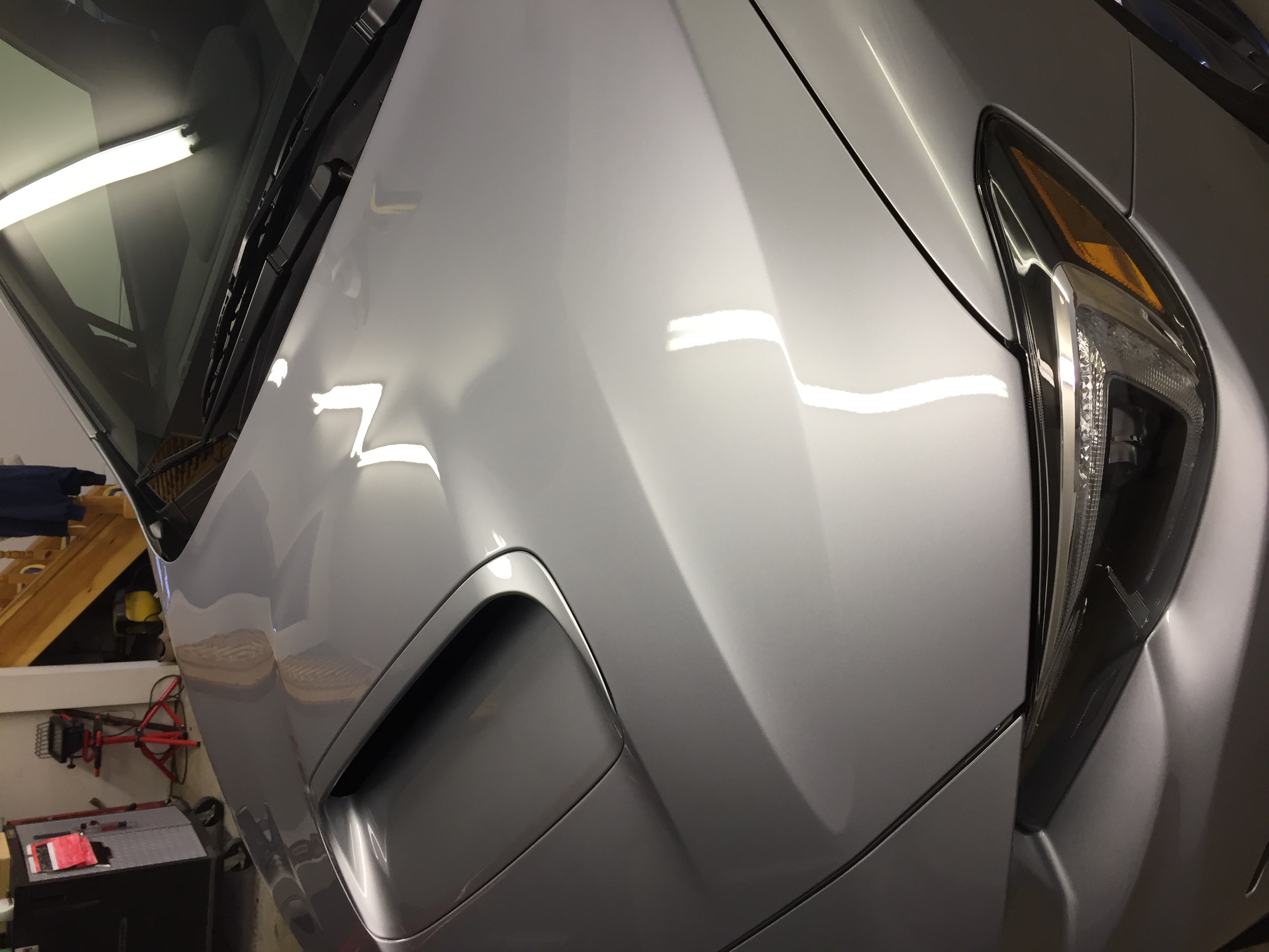

Just did my WRX with tec580 ceramic coat... see how long it holds up.
ID:	514529   Click image for larger version
