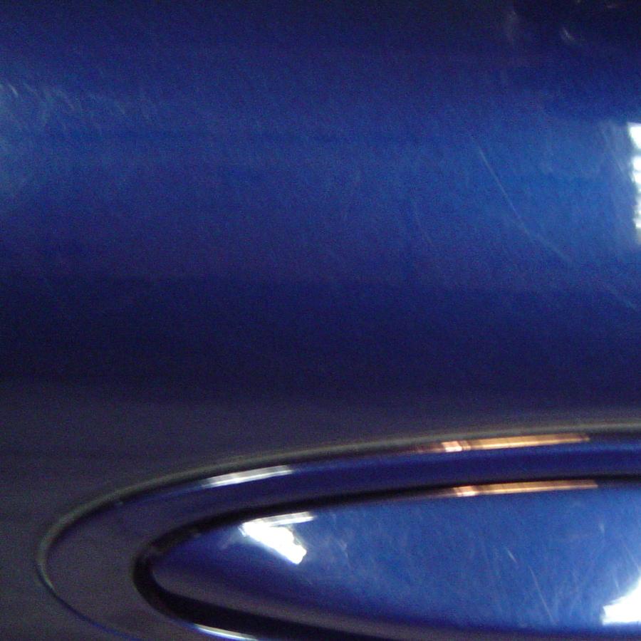

My 01 lapis blue cab came with some swirls and light scratches when I bought it earlier this year. I didn’t realize how delicate Porsche paint is and assumed they would come right out. My detailer has been unable to get them out with wax or light buffing and he is suggesting buffing it with a wool pad. This sounds drastic - is a wool pad going to make a bad situation worse & is their a better avenue or to try first? I’ve got to do something soon because every time I look at the car I get nauseous. It's like Carmen Electra with a giant zit in the middle of her forehead.

NOOOOOOO!!!!!!! No wool pad. It was great for the old paint from the 70's-80's but now with the water-based clears, you can accomplish some amazing results by using foam pads and a DA. If it's really bad, you still use foam but an orbital. Send me pics and I can suggest some things to do. But pleaasseee, don't put a wool pad on a P-Car. I'd take it to a reputable body shop if it needs more work than your detailer can handle.

Unfortunately I'm in MD or I'd try detailing dynamics. I also have a small ding with paint chip just above front wheel well I need to have fixed too (ding is middle right side of 2nd picture ).
I don't know if you can see it from this picture, but the paint has lots of small scratches, swirls which I assume are through the clear coat.

From looking at those pics, they can be taken out using a DA. Some of the deeper scratches, on your door handle, can be buffed out using a high-speed and foam pad. As for the ding, get the dent out and you'll see what you have to work with. It's a pretty deep chip and you can make it look a little better with touch-up, but it needs to be repainted. So NO WOOL PAD!! For the most part, your clear is in great shape. I don't see oxidation and that's a great sign. It does need some TLC though.
