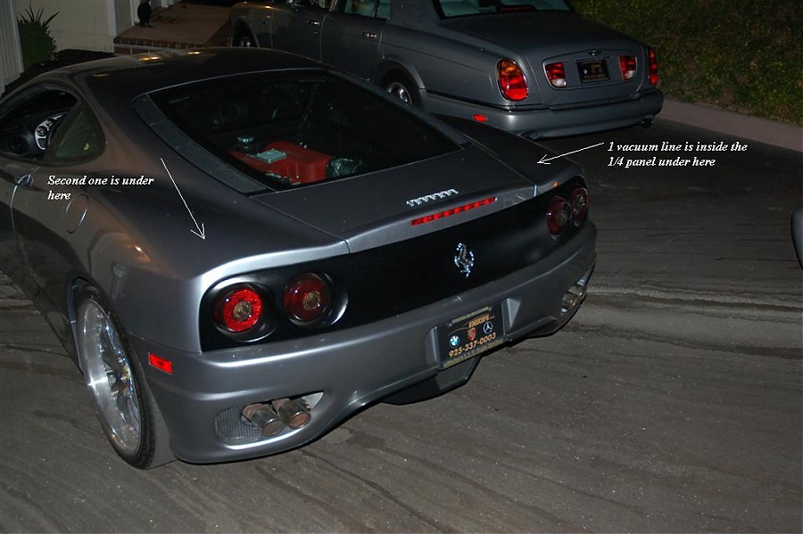

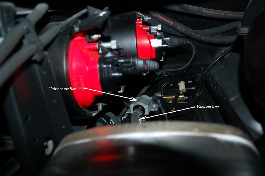

I attached a couple of crude pics of the location and the actual vacuum lines. Sorry they are so dark. Hope this helps somebody in the future. Thanks for your help guys.
Thanks for your pictures. It really helps.
So all I need to do it unplug the hose from the valves, then find something to plug into the hose and it will release the valve all open.
I will try it tonight.
Thats all!!!!
