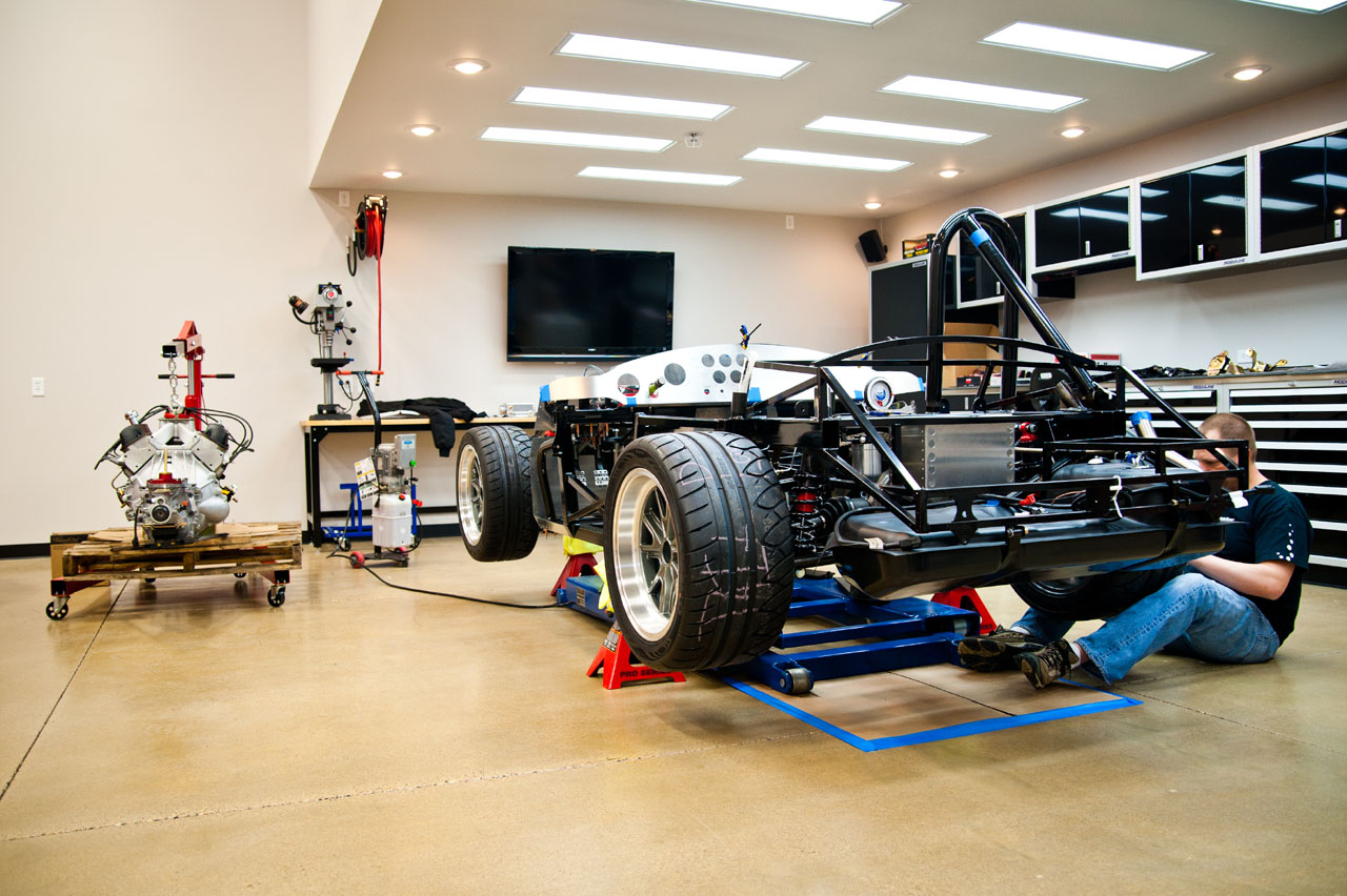

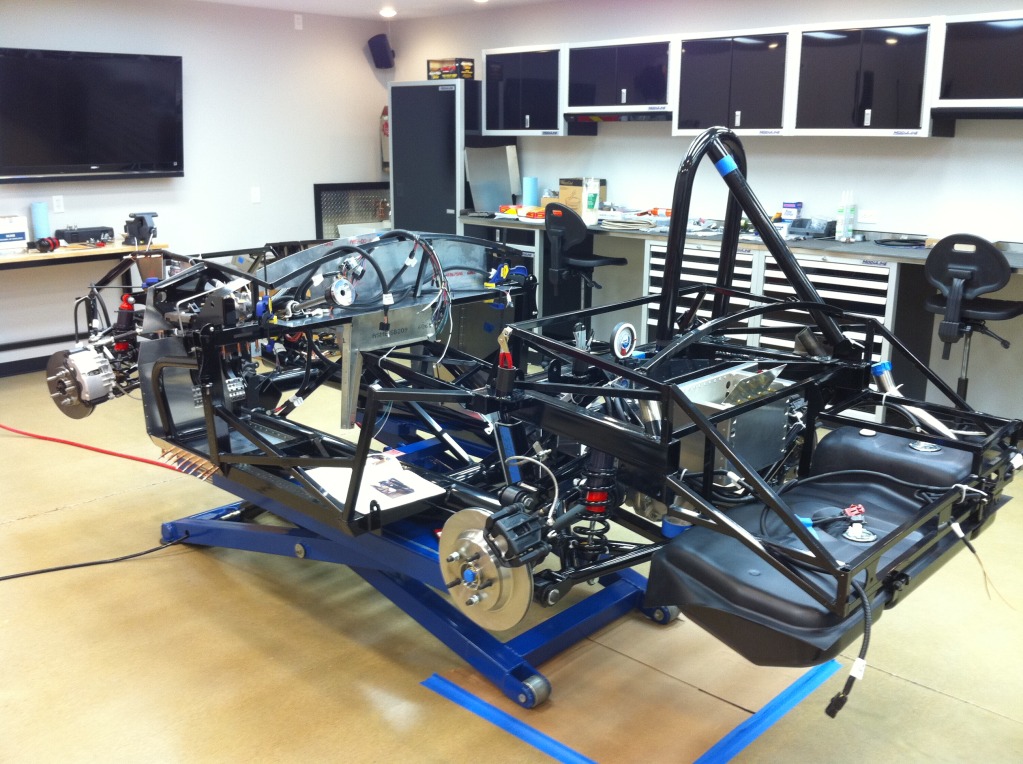

Thanks very much David.
The condo is currently home to my somewhat messy (& time consuming) Factory Five *Cobra* build. I'm very glad to have a warm, dry, very well lit place to work on it.

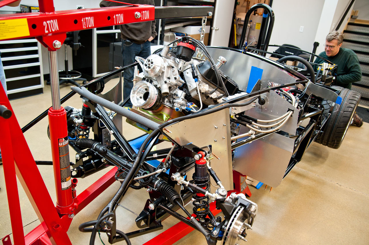

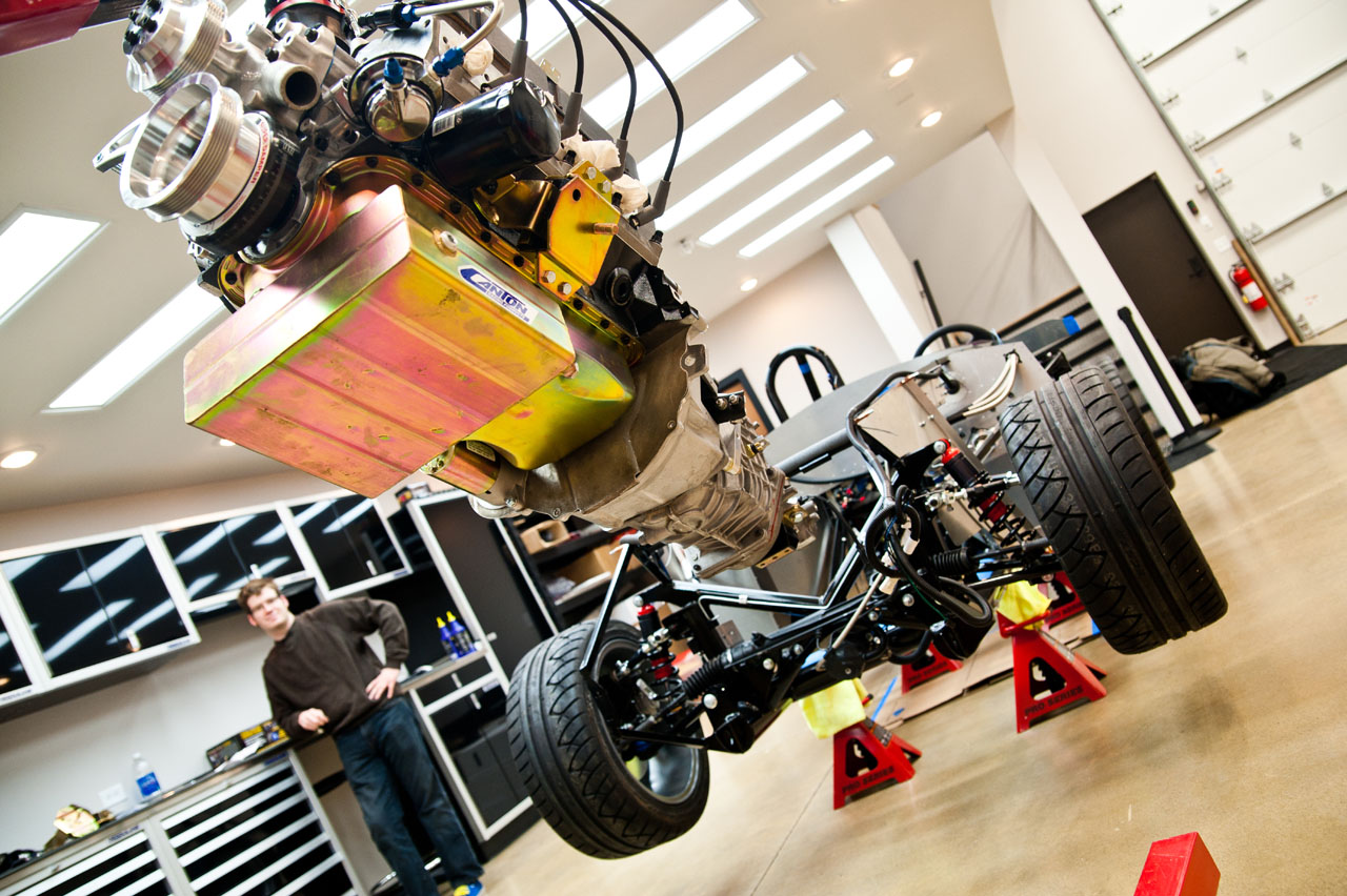

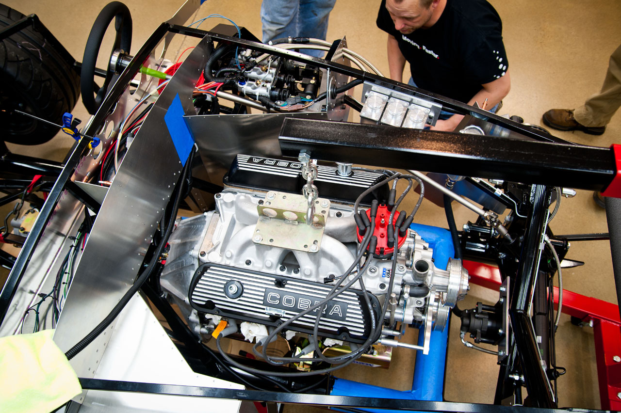

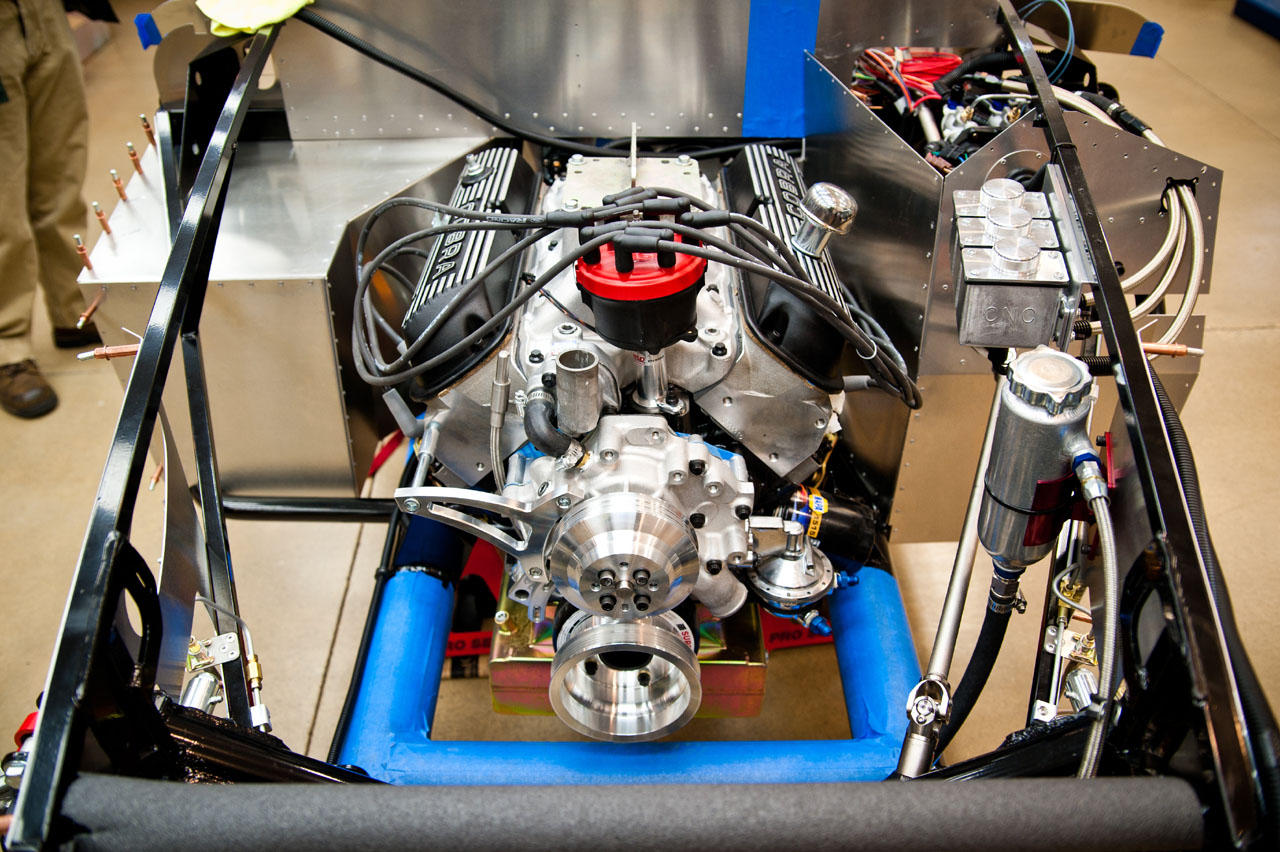

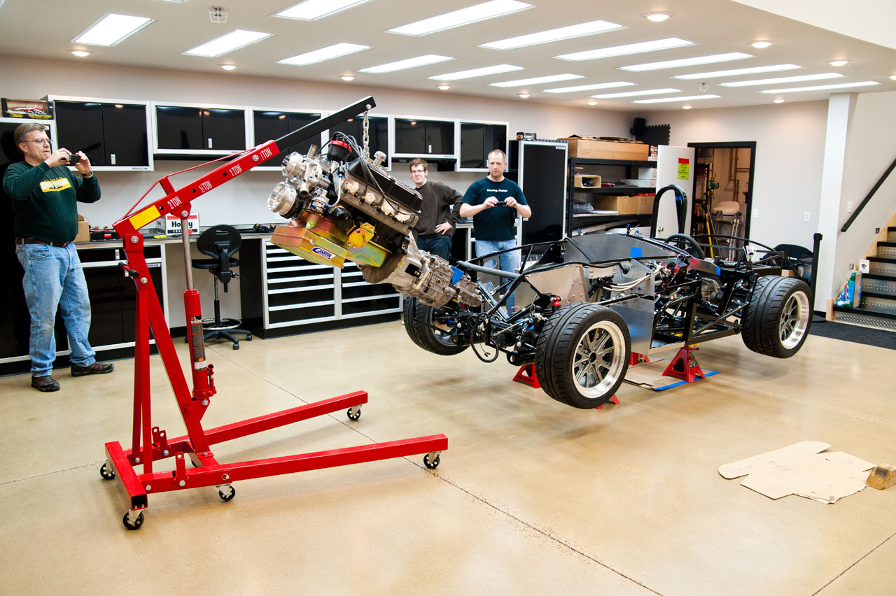

Chris - Congrats on getting the heart of trhe monster installed. I'm bummed I was unable to attend the festivities. - Eric
