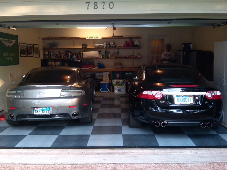

I just put in the gladiator garage tiles that are very similar to the race deck tiles. I absolutly love them.
I think it really cleaned up the look of the garage and actually makes the cars look better!
Old Aug 19, 2010 | 08:25 AM
RaceDeck's Avatar
Joined: Aug 2010
Posts: 24
From: Salt Lake City
RaceDeck has much to be proud ofRaceDeck has much to be proud ofRaceDeck has much to be proud ofRaceDeck has much to be proud ofRaceDeck has much to be proud ofRaceDeck has much to be proud ofRaceDeck has much to be proud ofRaceDeck has much to be proud ofRaceDeck has much to be proud ofRaceDeck has much to be proud of
Hi
Great looking garage, We actually manufacture the Gladiator garage flooring for Whirlpool. They are different in design and material, but a very good product.
