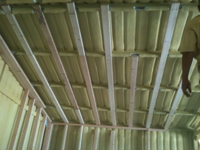

Finally working on my small shop!!!
Small metal building. 2" rigid foam insulation. Now starting to frame for walls and ceiling. R-13 batt going on the ceiling. And blown cellulose will be going in the wall cavity. The finish detail will look like the inside of a million dollar home. Stay tune for more pic.

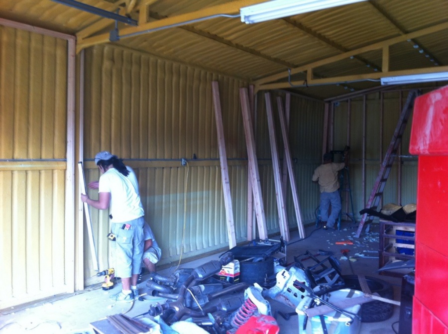

Ceiling framing

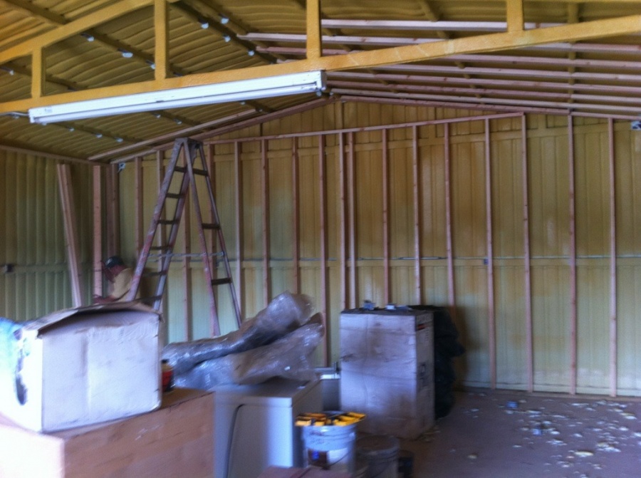

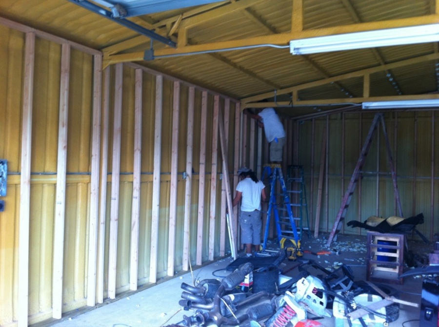

Wall framing

Wall

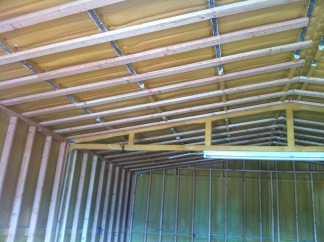

Ceiling done (so I thought until I wanted to do can lights) not enough space so now building the ceiling out

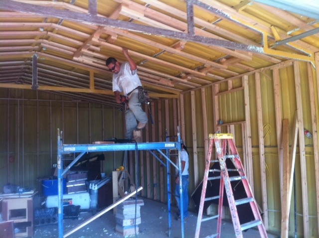

Wall and ceiling

More framing for the can light boxes.

Are you attaching the 2x4 walls studs to the external metal wall at all?

Yes the 2x4 wall is attached to the exterior metal. Just not shown in those pic.

Sorry to ask 1000 questions - do you mind sharing how you attached the 2x4's to the metal studs? I have a shed now that I am considering knocking over and putting up a metal structure in my back yard.

It's kind of like a fire block. The c-periling for the metal building was up 5' off the ground. So in between the 2x4 studs we attached 2 2x4 screwing the first 2x4 to the metal using 2 3/4" self taping flat headed Phillips screws. U can get them at lowes, home depot ect. You only need to do this every 3rd one. Ask any questions you want. Or if u need a pic of anything let me know. We are almost done drywalling. Will be posting more pic on mon.

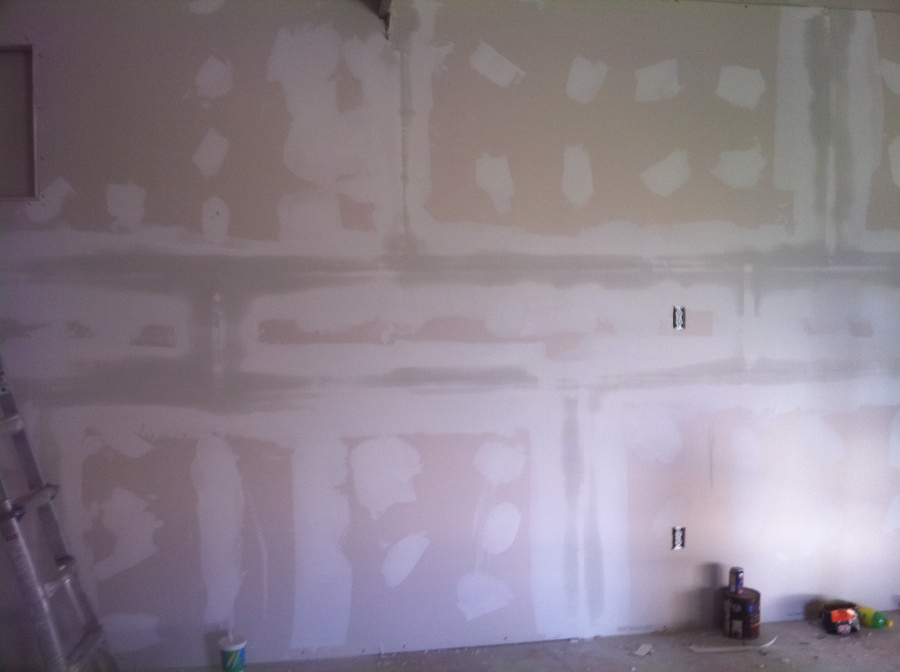

tape and bed

more tape and bed
The inset is where a saleen dealer sign goes
