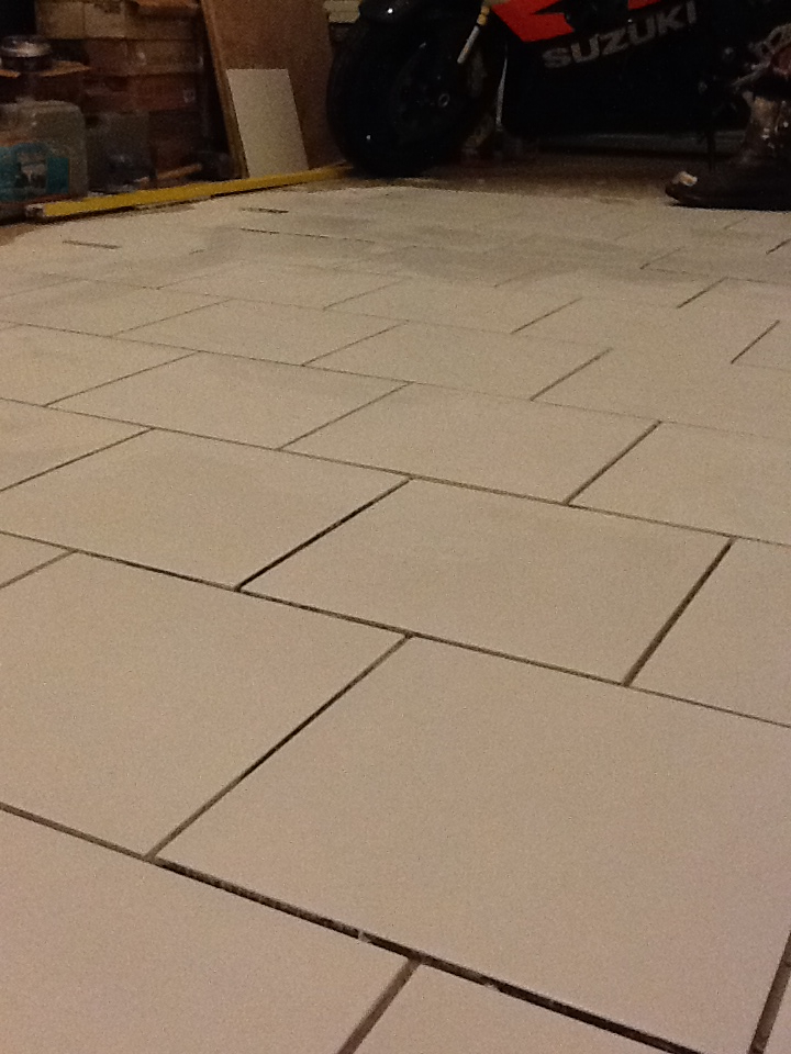

Well I've made a start with some cheap ceramics...
Due to undulations in my floor I'm a little nervous it's going to crack as soon us a put a car on it. In parts the tiles soun almost hollow when tapped yet when I lift them again they seem to have made contact with the adhesive.
As a test like jack tried, I smacked one tile once with a rubber hammer... It split! I'm now thinking though it'll be because it hasn't had time to set so the adhesive with move/ flex. I hope. I'm using a 6mm trowel and buttering the back of the tiles. Buttered smooth though so only really filing gaps.
It's going to take me days to do this so if I'm wasting my time please let me know!

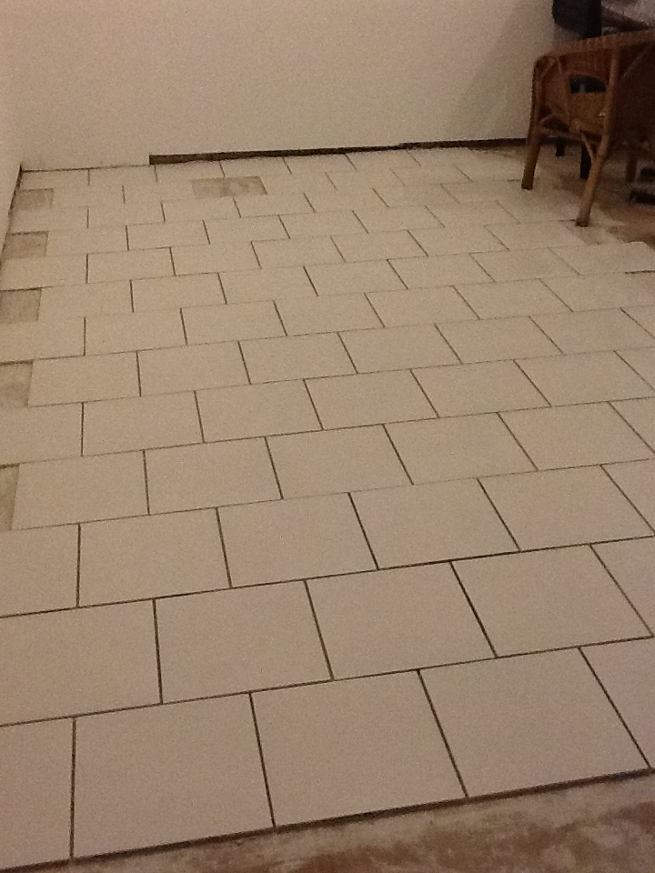

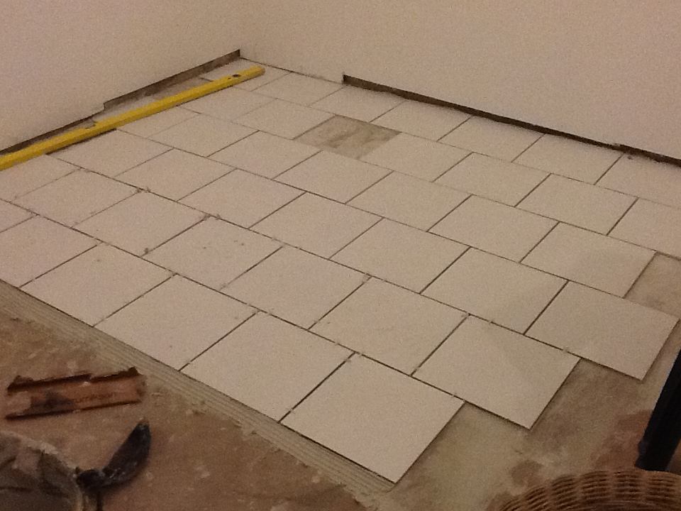

Thanks Jack. I laid another 30 today using the groove technique on rear of tile. I found this more time consuming and than a smooth buttering but my biggest issue was grooving right to the edges so I've a feeling I could have bother with the edges. Saying that - it only appears to be the first row that's not perfect.
I checked the rest of the tiles the evening - they've been down 24+hours - and they seem sound. No hollow sound either when tapped even where there had been previously.
By the way, any tips on keep the face and joints cleaner? Probably just down to practise but I'm spending too much time cleaning up my 'snotters'.
I'm getting there slowly but my knees are killing and I'm used to manual labour - though heavier work and less kneeling.

The job so far. I'll likely do a build thread once things are complete.
The tile that's missing wasn't sitting right so I took it out, then couldn't get back to it!
