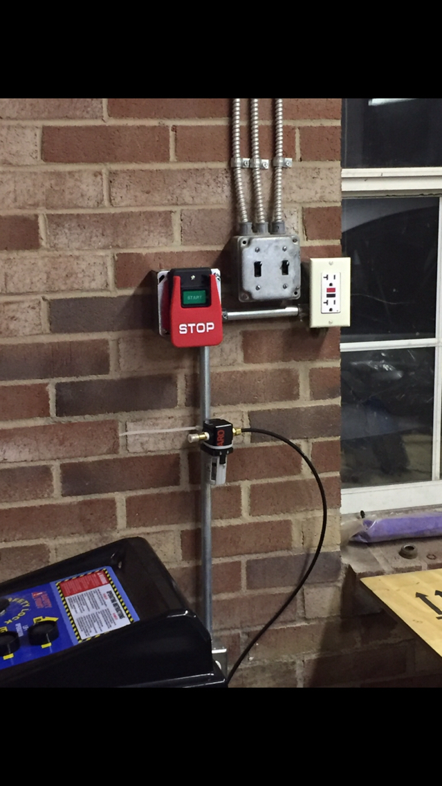

For my mid rise lift, I added an electrical disconnect as an emergency stop. I'm anticipating that these could also be locked out. One other option would be a lockout over the plug - you unplug it and then lock it out.
