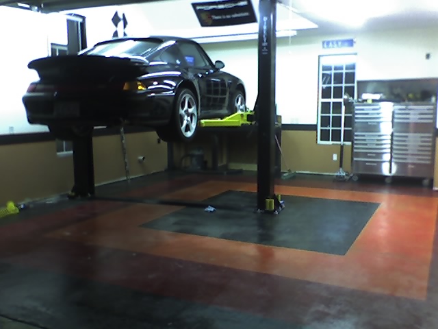

I just installed a Direct Lift 2 post from Greg Smith Equip (no affiliation) in my garage and I love it! Well made, USA made hydraulics and pretty sturdy.......and its BLACK! (happens to fit my color scheme in the garage). They say its a 9'3" but its a bit taller as I had to nibble some drywall and a hint of truss out from one area to make one side work (other side is within a vaulted ceiling area.)
bad camera pic and the garage isn't done so no crap from anyone

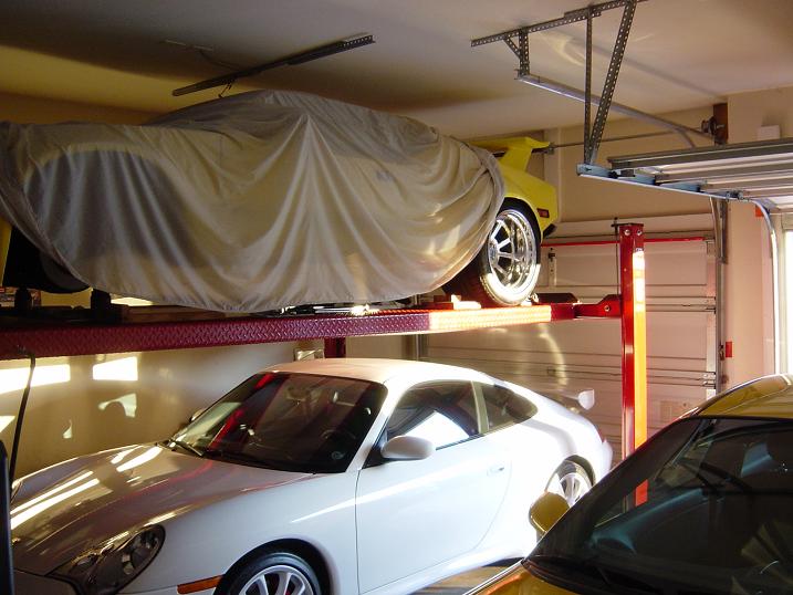

My garage is 9'10" and I'm using a Eagle Equipment SS7000 and love it. (4Post drive-on). I'm able to store the Pantera up top, with the 996 below.......or my sons 05'GTO. Hands down the best thing I've bought for the garage. (Lifetime waranty, none of that cheap overseas stuff).
For any suspension work I just slide the jacking tray under the area, and have (2) Fat/wide 40Ton jacks to push it up a bit. (But plan on getting their scissor attachment next year for it)
I did though, have my door track altered with a 36" radius, so the tracks now come up much higher and hug the ceiling by just a few inches.

Powerdna......... I'm not really sure that the 2-Post is a good idea for a "storage" solution because of the dropped suspension..... Question. Can you use the 4-post (like I do), just that you would not be able to use a few of the upper locking steps.
The attached pic I just took, and I have a good 8" above the Pantera, with (2) locks remaining. (Actually you can also see the track modification on the lift-side and how much higher it is than a normal door track).

On the pic you see, I've got 59" clear using 3rd lock from top, if i drop it down one take -4.5" off. (which I can still but the C4S under with no problem)
Mine is a EagleEquip SS7000. Think it was just over 3K. (Lifetime waranty, comes in red, blue, black...... you can get with 12v, 120v or 220v....no charge for any). Aluminum ramps and drip pans.
Took me about 4hrs to assemble.
