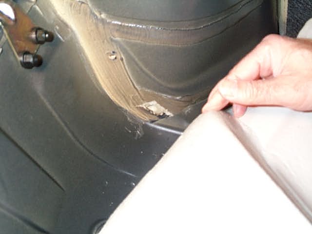

I just did this job and I will give you a few hints, if I can. First the install guides from Rennlist http://gallery.rennlist.com/gallery/album125
http://gallery.rennlist.com/gallery/albuq24
The DIY are excellent except this is not covered clearly. before you install the bar, after you set in in place. you have to cut the plastic under the carpet on the outboard rocker panels so the bar will drop in place without being forced. this is important because one of the biggest challenge is getting the bolts started with out cross threading.
I also removed the back carpet so I could see and remove the tape that covers the rear bolt holes: see below
Lastly, take off the rear view mirror before you start, better than busting it off, and disconnect the bat.
