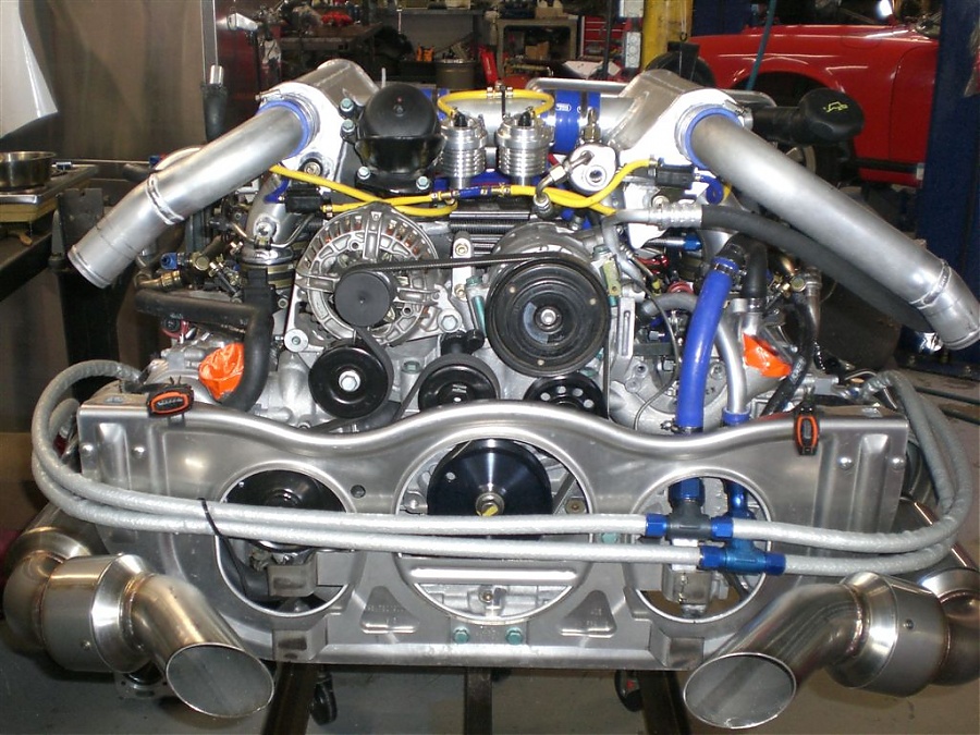

The unit will also communicate with a MoTec ADL2 dash, which is what we are using in lieu of the stock instrument cluster, in terms of gear indication. Here are more pics that might help you understand the install.

Not to deviate from the original post, but damn, 1badgt2, I guess your car is going to live up to your user name. Are you running ITB's on it, and is the intake a one-off custom made? Great stuff!

We are running ITB's and the plenum/runner design is hand fabricated custom for this application. There are 5 of these particular motors in existence and mine, which is the only "street" application. Two are in Germany and three are in the US, plus mine.
