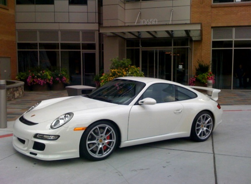

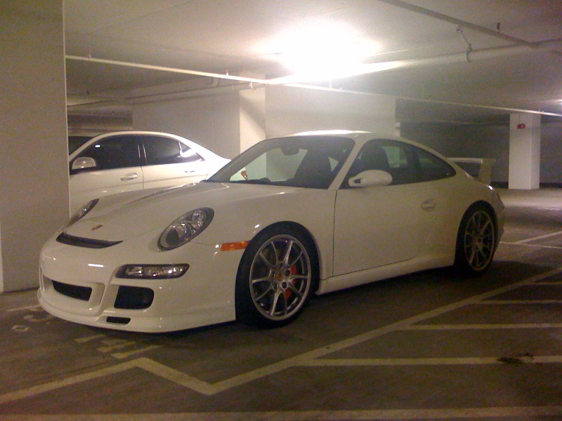

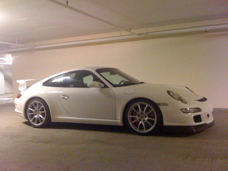

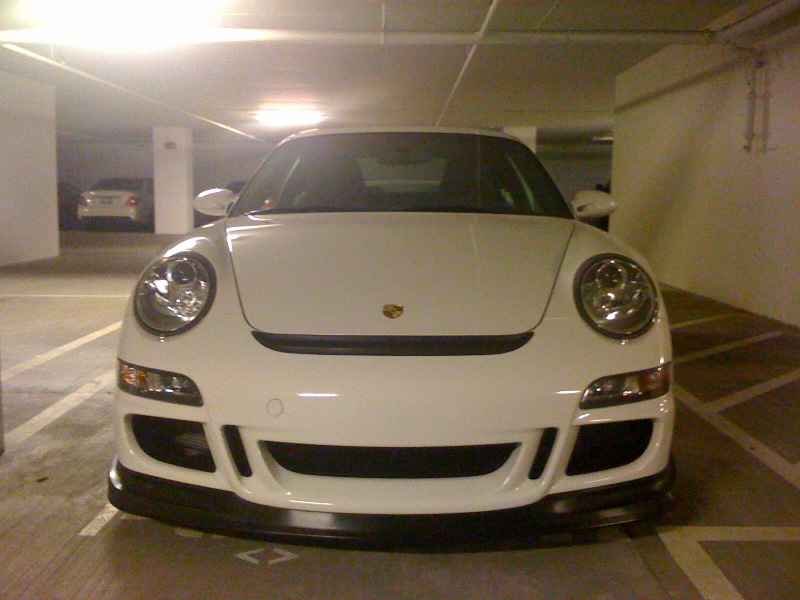

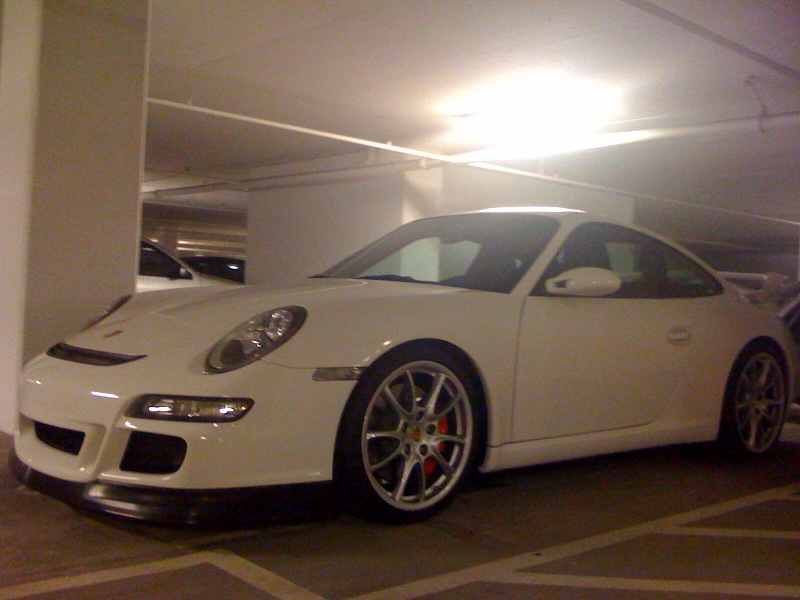

Thank you for all your helps. Shame on me. I was not able to get the spoiler off after many attempts so I turned to one of the local body shops since they were going to get my original spoiler repainted anyway. Here are the before and after photos for you all to enjoy. Sorry for the low iphone photo quality.
