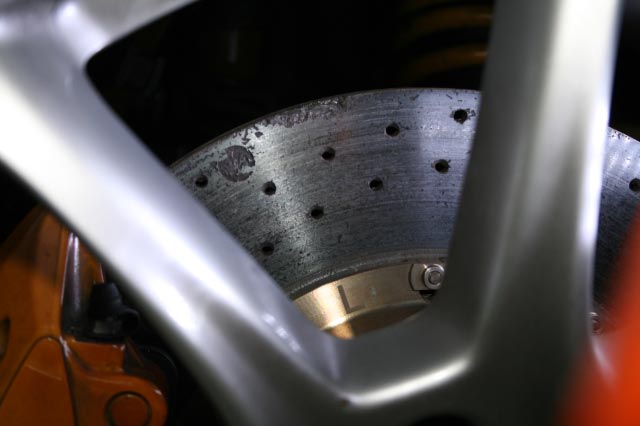

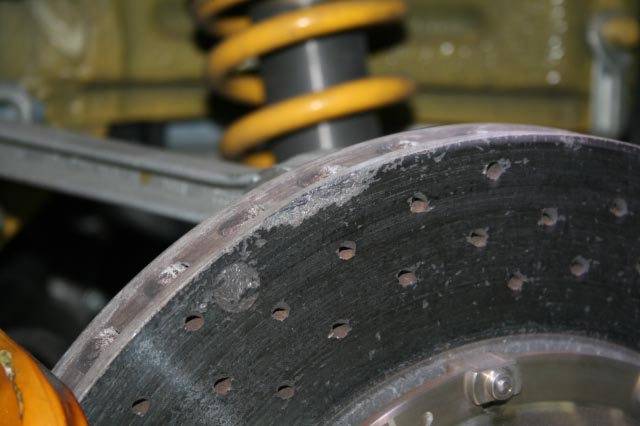

Looking at the previous pictures shows exactly the damage done to rotors once the brake pads start falling in pieces by operating out of their intended temperature range. The chunks of brake pads actually damage the surface on the rotors.
The stock brake pads are not intended for track use. The dealer doesn't know about what pads work with PCCB. The SuperCup teams use the P50 pad that later on became available for us, I have not tried it yet. However, the RS19 and RS29 stay in better shape than the stock pads when used at the track with PCCB, I have been using these pads with PCCB for 5 years on the same rotors.
Stock pads and track use on the first generation GT2/GT3 brakes were the cause for early rotors failure, as early as two track days.
This is a rear rotor with 39,000 miles on it, over 60 track days, over 150 autoX. Surface is smooth. The front one shown below is not smooth anymore, it should be replaced, but it still keeps the brake pads in good shape without early wear on the pads (when PCCB are really shot they become brake pads grinders)
