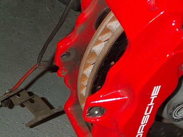

I don't know if i have seen one. the fronts you don't have to pull off the caliper just at one pin on the middle of the rotor, the front pads just fall out. You have to get the litter wire/ sensor off the old pads and on to the new pads.
The rear pads you do have to remove the caliper to bolts upper and lower bold caliper comes off. Han it on a spring with a piece of coat hanger and pry the old pads out. Be real sure when you put the retainer spring back on the new pads that it is even across both rear pad backing plates or the pads will hang up and make a rubbing sound.
You should replace the caliper bolts, but I reuse mine one time. they should go back to 63 foot lbs. Picture is the front caliper after removing the retainer bolt and sprint and the pads just fall out.

thanks frank. seems all the writeups are talking about a retaining pin but i guess 997 is different. know what the torque is on this bolt?

mike thanks for the snapshots. see, even your manual is talking about a retainer. see arrow.
here's from my car. don't see it.
looks simple enough though... guess i can just try to figure out how much torque is on there using my torque wrench...

Interesting ..... your retainer is not held on by a safety pin? I thought all 997 pretty much come with same brake set up ... I guess not? You can call Fremont Porsche tomorrow and ask to speak with a tech to get the torque spec. Guesstimate the torque with your torque wrench is not a good idea since it often take more torque to loosen the bolt.
Your caliper picture above must be taken from the back right? My PCCB calipers look different from the outside as shown below. I have not pay attention to the inside of the caliper.

yes my pic above was from the inside. here's from the outside. there's no way to slide that pin to the inside as the manual suggested. lol.

I did some inquiry today and apparently the retainer is none weight bearing so all you need to to is hand tighten and no need to torque the bolt
+1 that is what I did and what others had told me just get it tight.. NOW where did you get that disk, We had a lead on that some months ago, and I must have missed it, I want one. Tell me how??
