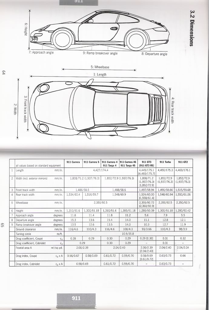

But Paul's right, it will vary from car to car. Generally these figures are how the cars roll off the line:
