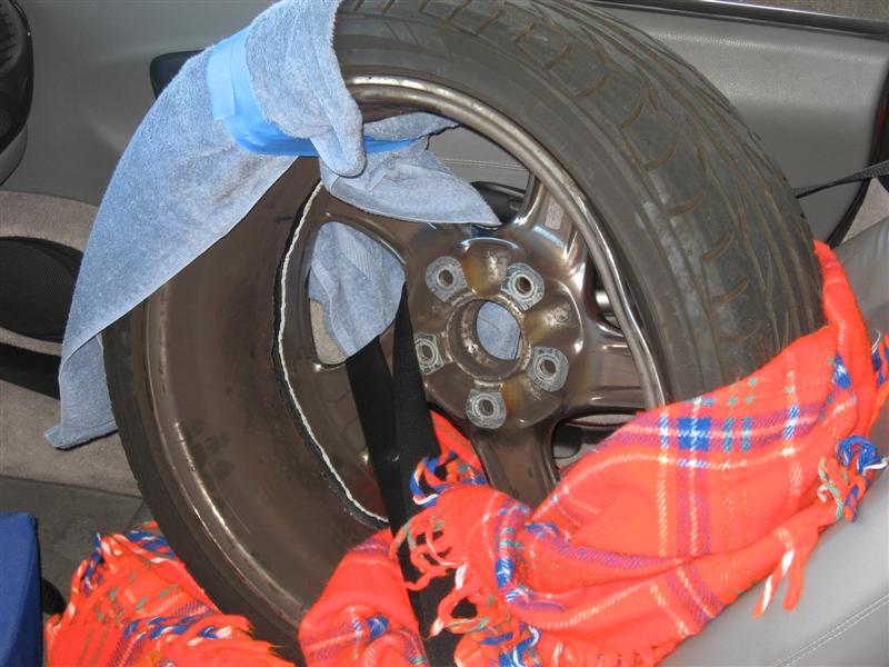

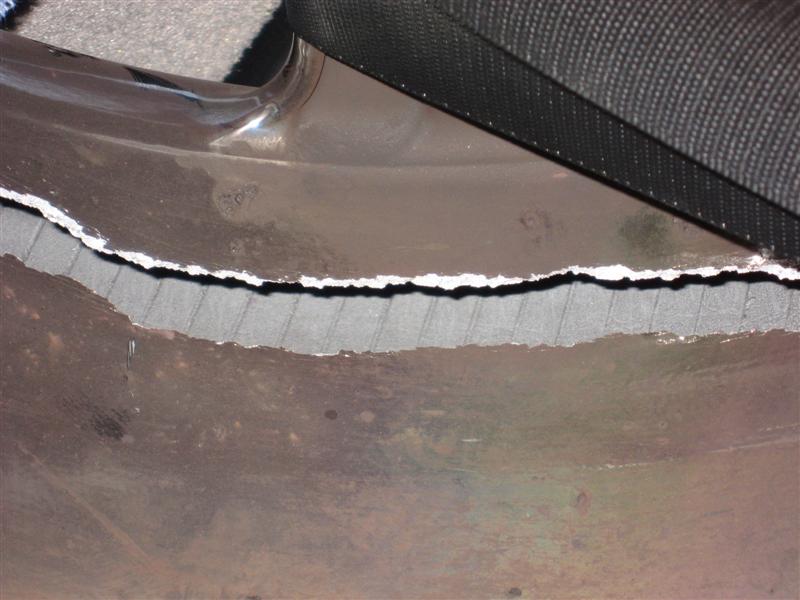

I had powder coated track wheels also. They looked great, but a lot of people recommend against doing that. It's possible that you could get a crack in a rim and not see it underneath the powder coating. That happens sometimes. Here's a catastrophic failure from a track day I was at:

Wow, that is major. That's good info. Thanks!
Is that a OEM turbo twist or is that an aftermarket wheel?

I believe those were OEM.

Powder coating is a process that requires the parts be baked at about 400F for 30 mins or so. That can mess with some brands of wheels. Add on the fact powder can hide cracks and I'll never use it on a wheel. Paint or anodizing for me.

That is a serious failure for a wheel that is supposedly very sturdy - is it possible it was involved in an incident?

No accident involved. You see the inner lip is bent in one spot (2 o'clock in the photo). I'm no engineer, but I bet the two are related. If he bent it like that on the track, the added stress on the other part of the rim may have caused the crack to start. I've seen other wheels get cracks at the track, but nothing like that. Cracks usually show up on the spokes and that's what gets powder coated.
