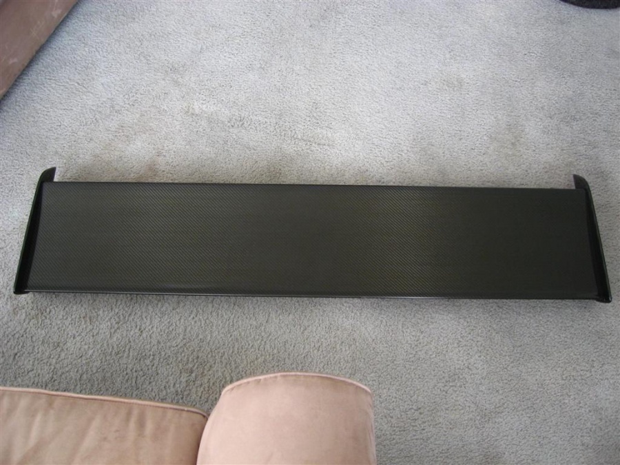

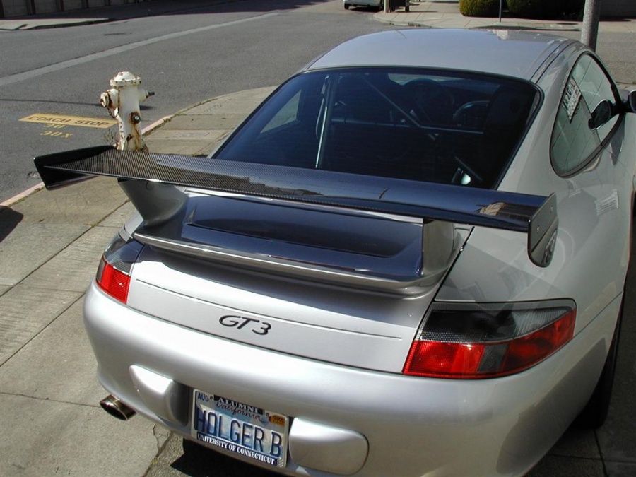

I found my 6 GT3 to be more stable through fast turns with the RS wing and 4 degree shims, but you give up a few mph down the long straights. I didn't use a Cup splitter and stayed with the stock one with no problems. Chuck is right about using caution when buying the replicas without the mounts attached. Also, there's not much point in getting one that's not adjustable IMO. Recently sold my car and the RS wing is still available. OEM CF part in excellent condition. Asking $2,600. Local SF Bay area buyer preferred. (It's one of the few parts that hasn't been going down in value.)
