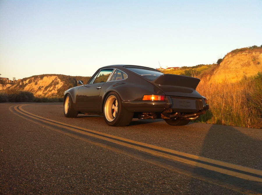

I Need a Wing
Can you build me a 60" or so badass wing for my 73 beast that I can use on the hardcore track days?
