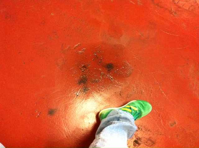

My 2010 GT3RS 3.8 leaks too. I bought it used with 2100Km on it in Dec-2011, PPI mentioned it has small drop of clean oil at the bottom. No big deal.
But after one and half month, I have some oil leak as the picture show.
Drove it to dealer, they need to take picture and send the pictures to Germany for approval . And may take up to a month for all the process .
Can't believe 2010 car will leak ?
