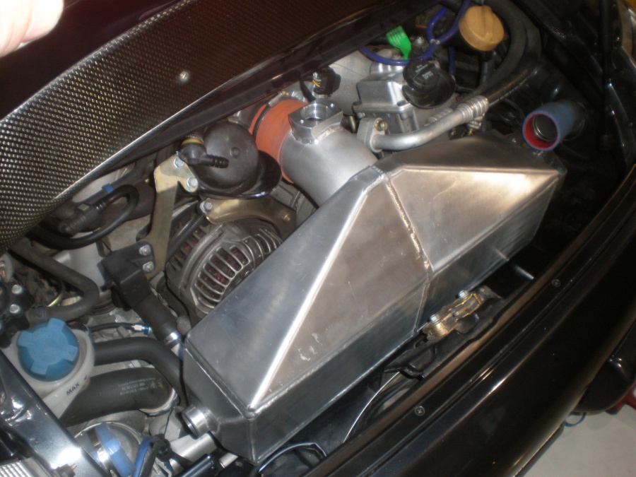

Intercooler pic's
Intercooler pictures being fitted. The water pump that we selected flows over 20 gal/min. Combined with the radiator and intercooler this setup should provide adequate cooling for the power output and beyond.

Love it, Ivan. Did the bottom pipings get moved to the sides? I noticed the pipings placed on the bottom of the intercooler on your prototype, but I see them relocated to the sides. Clearance issue?

Piping
Seung
The tubing has not been welded in yet. We need to get the angle right so we can reproduce again and again. I will keep u posted about picking it up on the 28th. It is going to be tight.

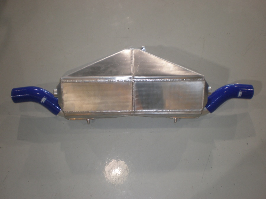

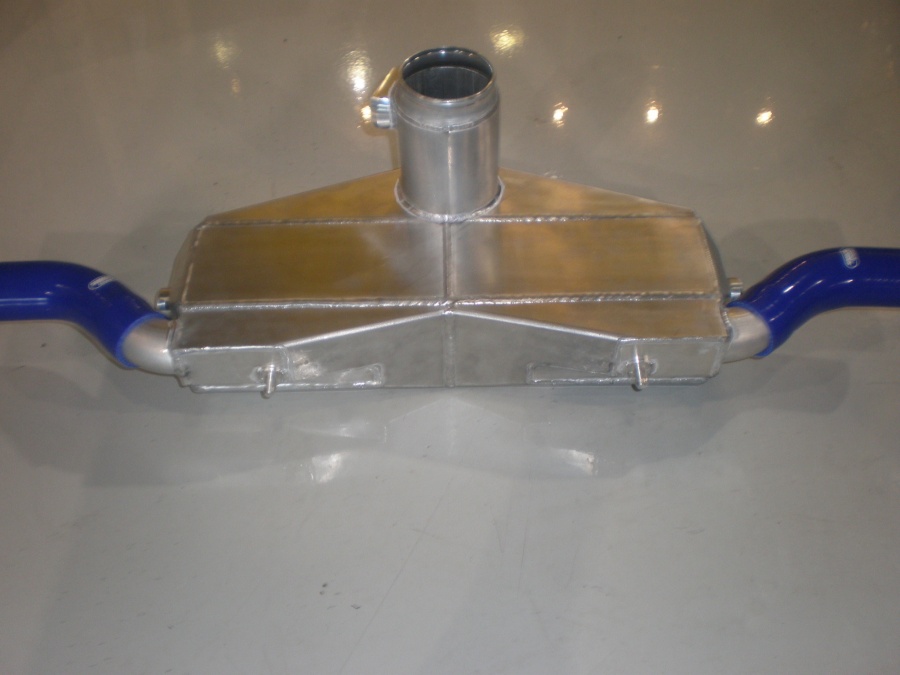

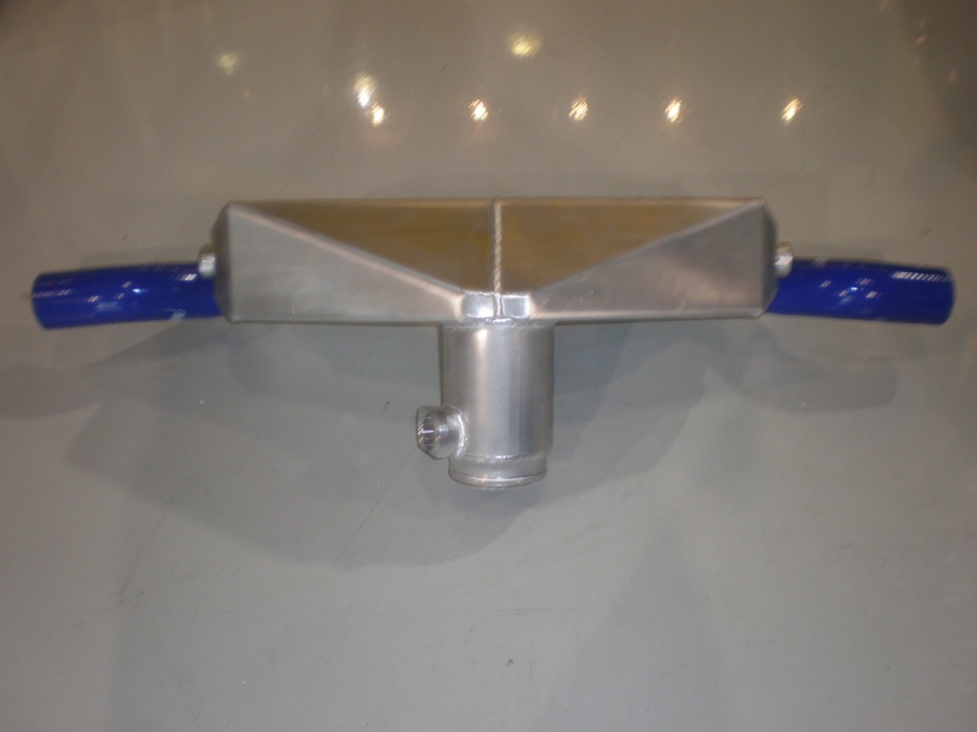

Intercooler finalized
Just a few pictures of what the intercooler looks like. Hope you all like what we did.
